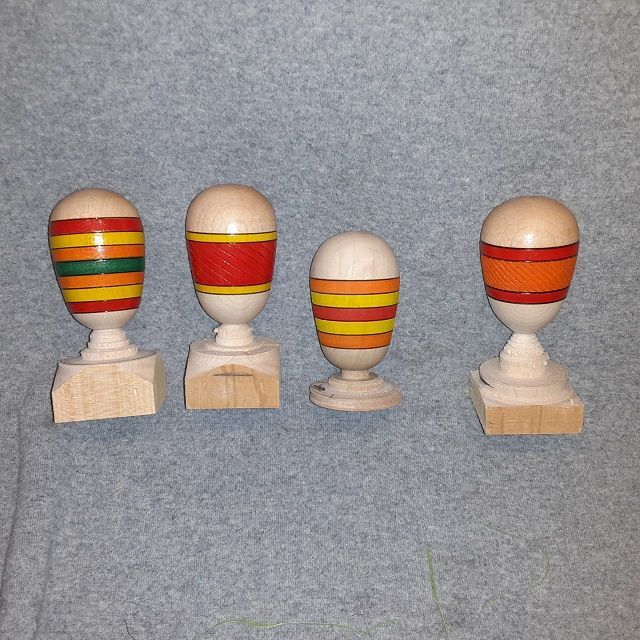

May 15, 20224 yr Popular Post comment_290869 Ron, try a turning and add some burn lines. Use the pens to color between the lines while it is still on the lathe running as slow as possible. Puts the stripe the other direction but looks good too. Here are some eggs done with ink and a small brush employing that method. Edited May 15, 20224 yr by HandyDan Report
May 15, 20224 yr comment_290908 Using color is somewhat subjective and in my opinion must meet some criteria. I like the burn lines as a limiter to color bleed. The second way to color is either blot on in random pattern or spray on with airbrush to areas with overlap. After adding color this way a light mist of solvent ( for the color I use alcohol) to blend the colors. Also color can be added with colored pencils. Report
