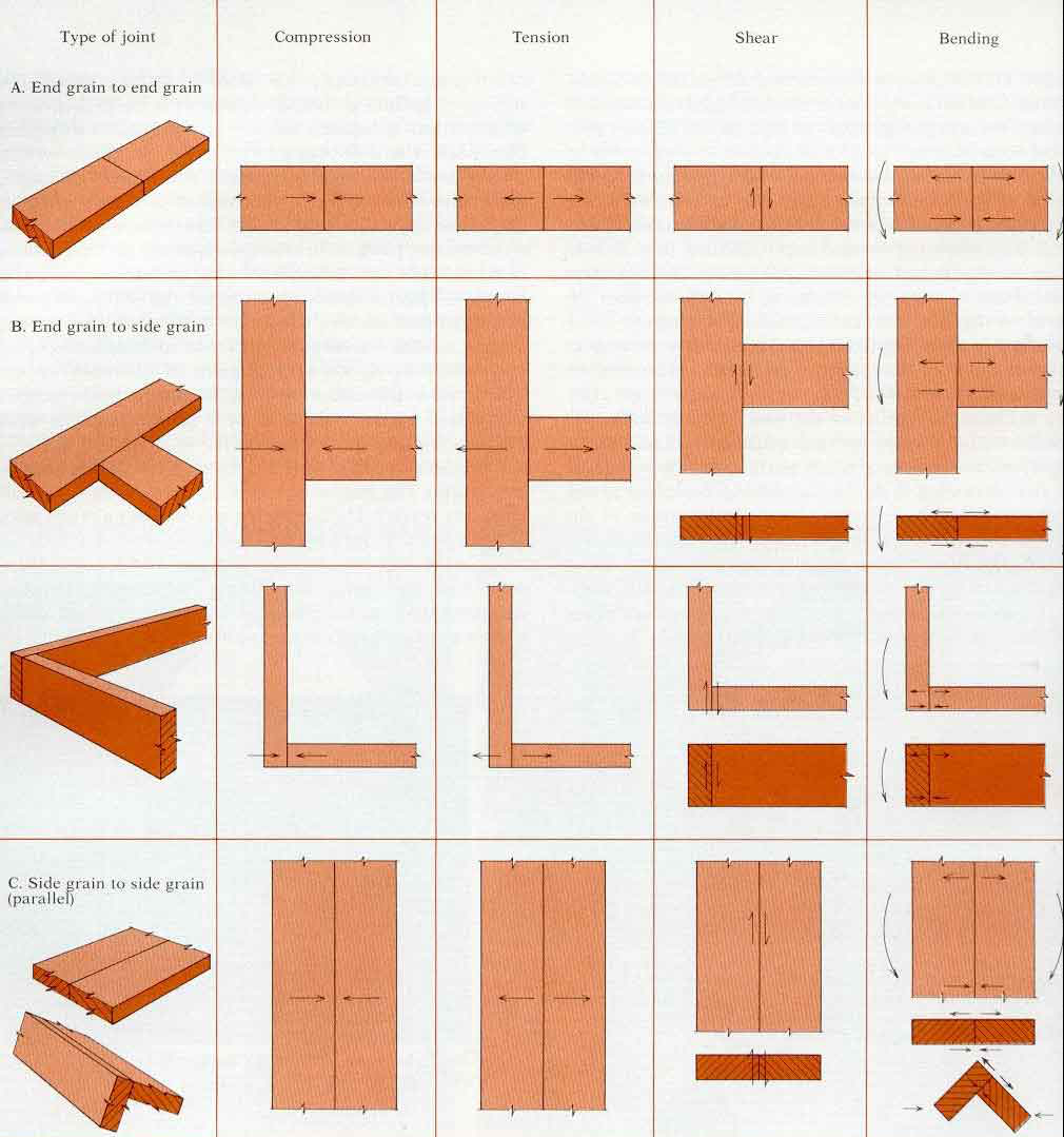

My issue with tests like this is that
  • they only measure one of four types of stress on a joint
  • they only do one type of joint, wood can meet in various ways and various angles
  • strength of wood varies by axis and species
  • what to do if wood failure causes joint failure
  • tests only use one type of glue
  • they are conducted on fresh joints, not those with several seasons of wood movement
  • there is little consideration for sudden vs. gradual failure (important if you are talking about something like a chair)
  • there is little consideration for sudden vs. gradual stress applied
  • is it strong enough? you don't need the same amount of strength for something like a dining chair vs. a picture frame
  • variations for too tight, too loose, or optimal fit in the joint
  • a few samples is not statistically valid
Other than that...
