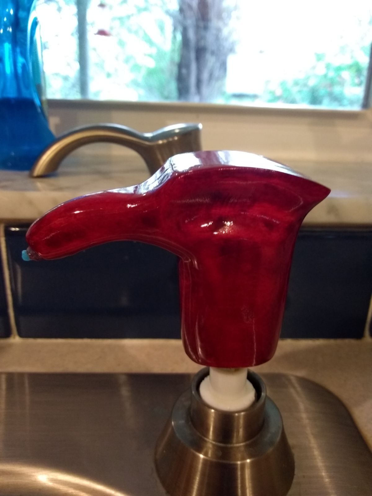

Yep, I sure do.  I just now finished this new plunger for the soap dispenser at the kitchen sink. Mostly lacquer was used. I couldn't buy just a new plunger thingy and the price for a new soap dispense made me believe I was buying a new counter top along with a new sink and soap thing too and now this piece of maple will have to do me . Whooo boy, prices have gone out through the top end of my little brain to ever comprehend.
  I bought never found the right sized curved drill bit for the little plastic tube to slide in to.
And since I do most  of the dish washing I wanted something pretty!!!!!!

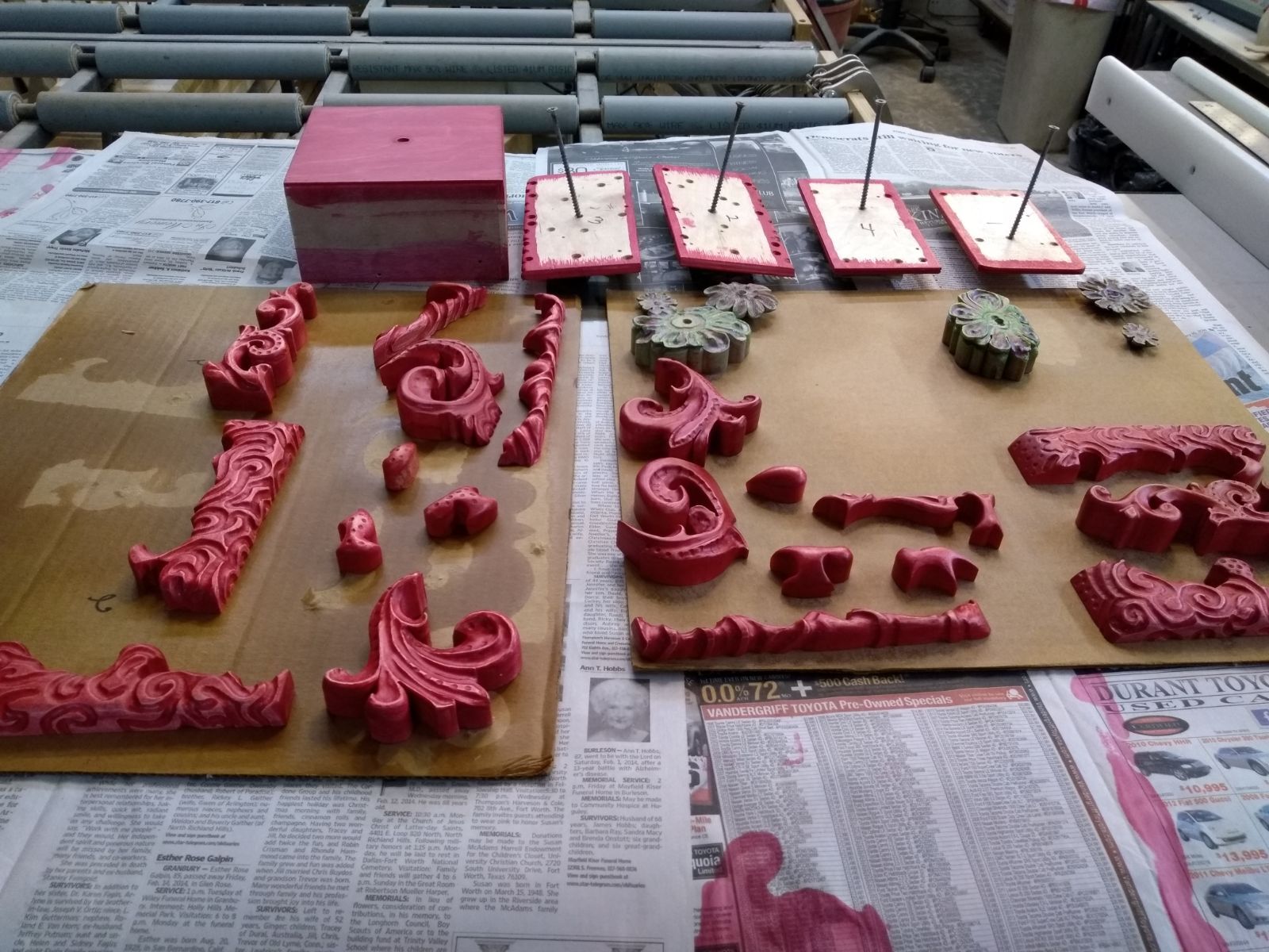

Wichita the jewelry box and all my carving is done the same way. All the pieces are scroll sawed in to smaller pieces so I can stain each piece the colors I am wanting to use then spray as many coats of lacquer as needed to make a nice smooth finish on each one before  I glue all the pieces back on to a backer board the same size as that project started out being..
  Take a look at my pictures under Smallpatch. Somewhere through all that mess maybe you will start to understand my wild way of ending up with something I might be proud of.
  It looks to me like you are starting to put the finishing coats on where the wood is still way to course. The first thing is to sand things very smooth...I use small 1/8" shaft diamond bits with the Dremel to make the wood real smooth in and around the carving pieces.  Also if you are using a soft wood it will be almost impossible  to get a smooth finish.. I put about ten sprayed on coats of lacquer using a rattle can of lacquer from Walmart, Rustoleum and in between coats if it feels ruff I use 320 sand paper after each coat is dry to the touch. Then wipe off any dust or blow it off with air and a dry fine bristle brush.

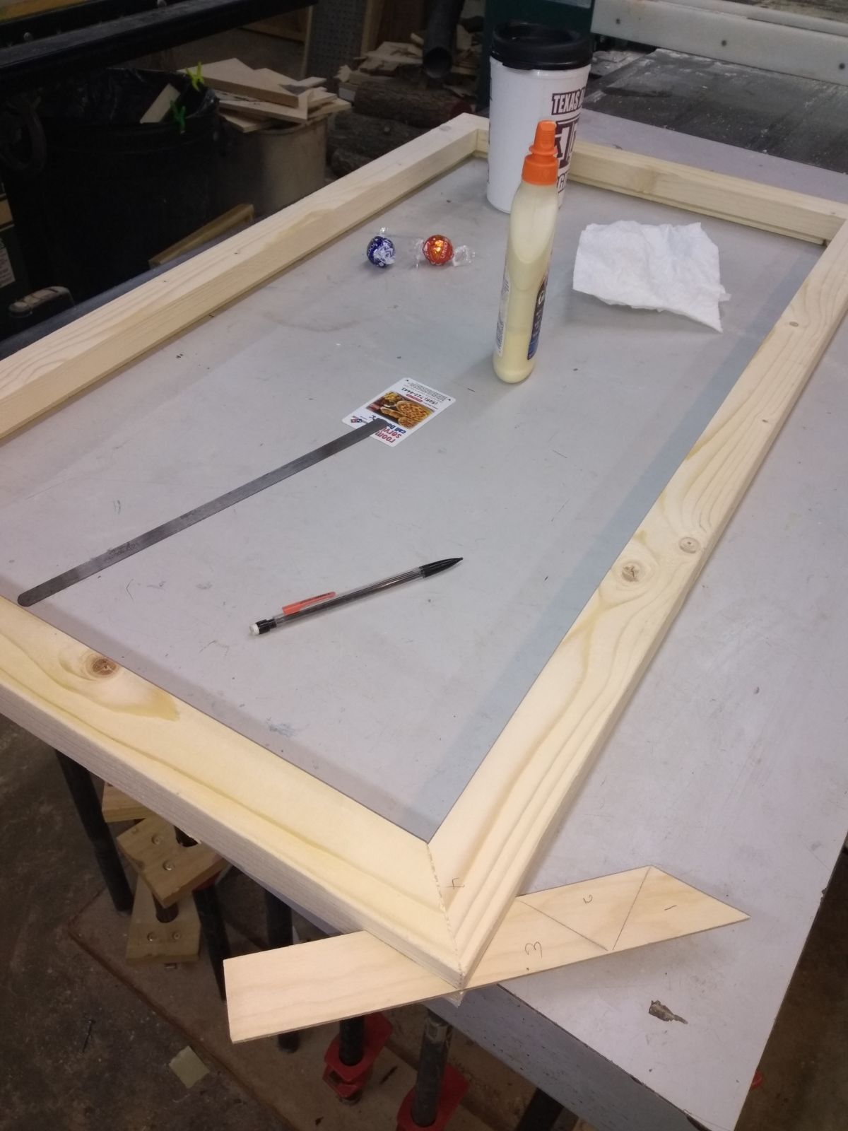

I did make and finish these frames using regular 2x4 studs this week but the stain was applied using the air brush so I would not get any blotching. The 3 finished frames I had to match some furniture the guy had for the reason I used the air brush.1903865613_IMG_20220405_132611050pinewoodframetwo.jpg.c20d110366d932d8687923b6ac5efe88.jpg1925035000_IMG_20220417_100759441pinewoodframe.jpg.0630abd8cc763e27e49bce3b9b4e5f76.jpg

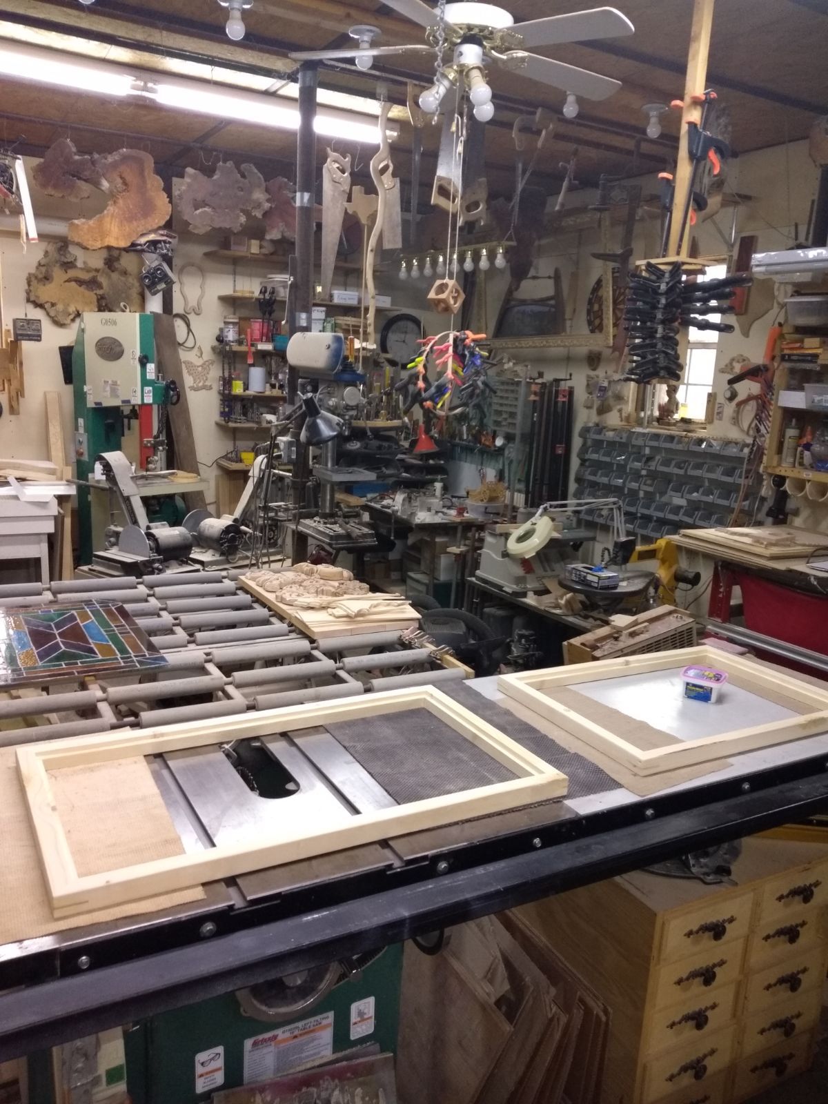

I don't have room for a work table so the table saw is great for all the building and finishing unless out side is the right temp for spraying.

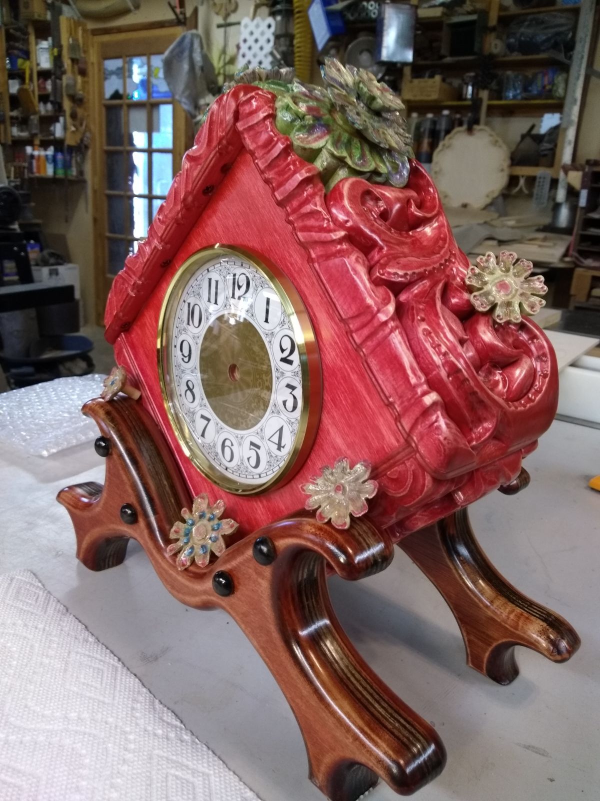

  And actually I usually use steel wood after the first coat or two. I have lots of bad areas that would take a few days of sanding but some of my pictures will show how I cut lots of the carving pieces into smaller sizes so most of those ups and downs are out in the open much more than they look when I glue everything back in to its original place after I carve the pieces with the dremel?1413215957_IMG_20191021_105855508(1)baileysclock.jpg.a830921dbf4ef13c9d94ae36c838105f.jpg
  You can see how I solved my problem of sanding for I cut these clock pieces so they are easy to make smooth with out lots of elbow grease.  And this lacquer ends up very smooth to the touch. Hey I have been at this type of finishing for more than 60 years so I guess you might say I have refined some of the hard work in to being a pleasure now. The scroll saw only takes a few minutes to cut these things apart so the work can be easier for me to do!!!

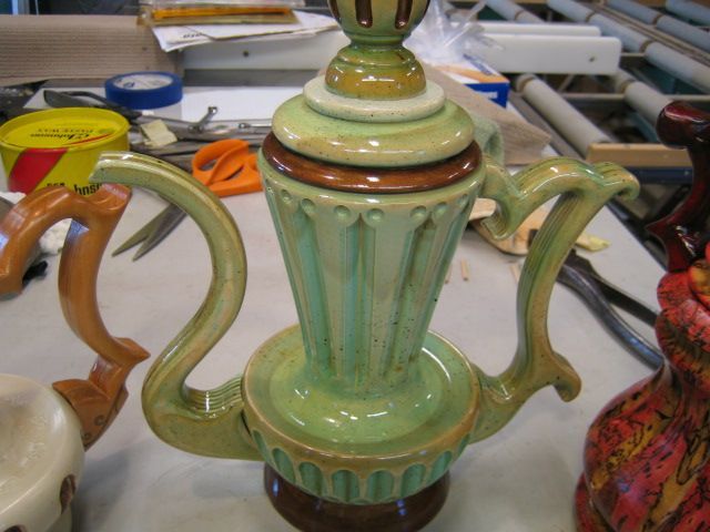

   After I put the color or stain to this tea pot I then started spraying a few coats of lacquer and at first I did have to sand or use steel wool until I got all to fuzzies removed then started spraying more coats of lacquer and probably have at least 20 coats on before I finally finished. I might have used up to 4 rattle cans of lacquer and it might have taken four or five days to complete the finishing cycle?? I don't keep any records of how long I spend building things! 1577808826_number7donebuttheglue003teapotthree.JPG.776a889f9a195f0684f553c9413f989f.JPG
Another thing, the jewelry box with the raised carving was built so I could remove the carved pieces to stain  and spray the finish without having to sand down into the deep passage ways like what sounds like you are asking about..
  330443251_IMG_20210205_183355674moreofmywayofdoingthings.jpg.3c7ac454e707765bca6d5c90581bc53a.jpg
All the dark pieces were scroll sawed so they could be removed and stained and spray finished before I was ready to glue every thing back together to become the jewelry box... This is just something I come up with to do away with that was eating my sack lunch for everything was much harder to build and finished  as one piece before I got smart???

 Each of those sections of carved pieces are connected and it does sometimes make it hard to slip them out of their slots but here is where a person has to consentrate on keeping the scroll saw blade straight up and down while sawing or else I couldn't push those pieces out to sand and stain. This is something that does take lots of scroll sawing to learn to do. And also I use a regular scroll saw blade so that means all the sawed areas are very smooth to the touch meaning they should slide out even though there is a smaller gap  to work with.
