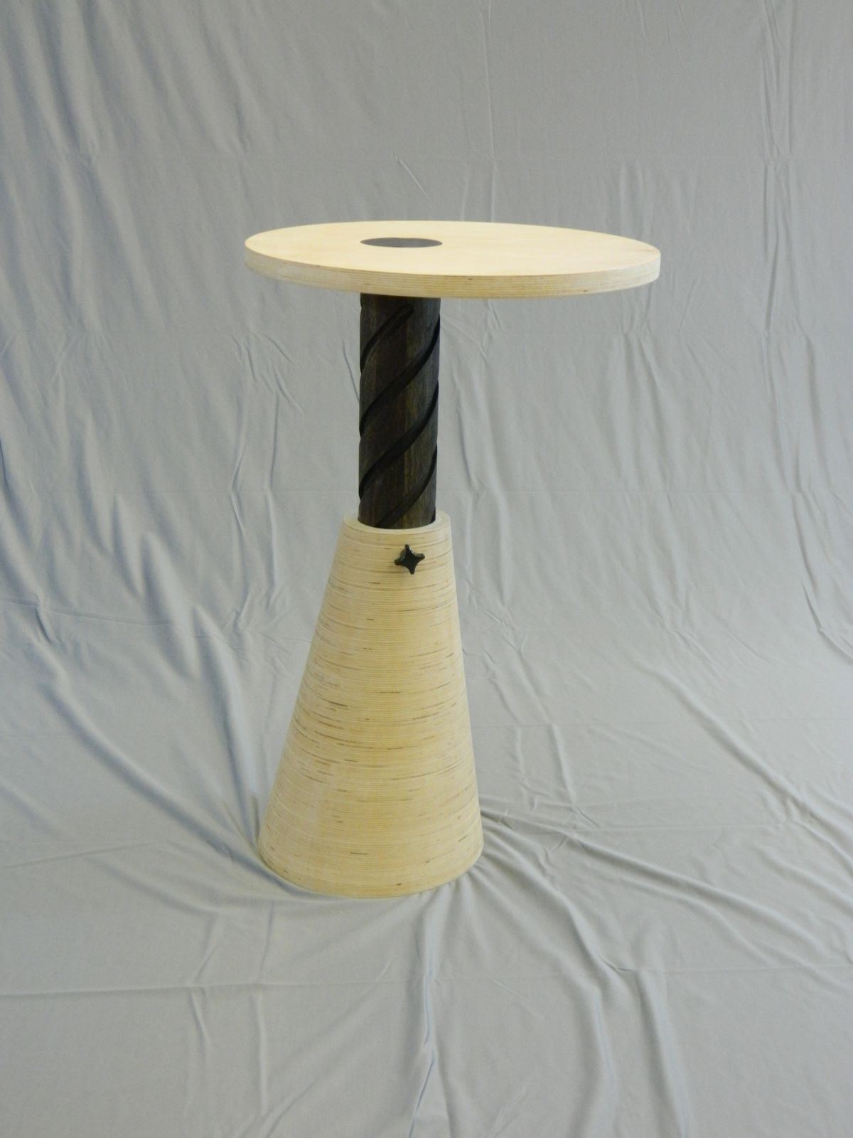

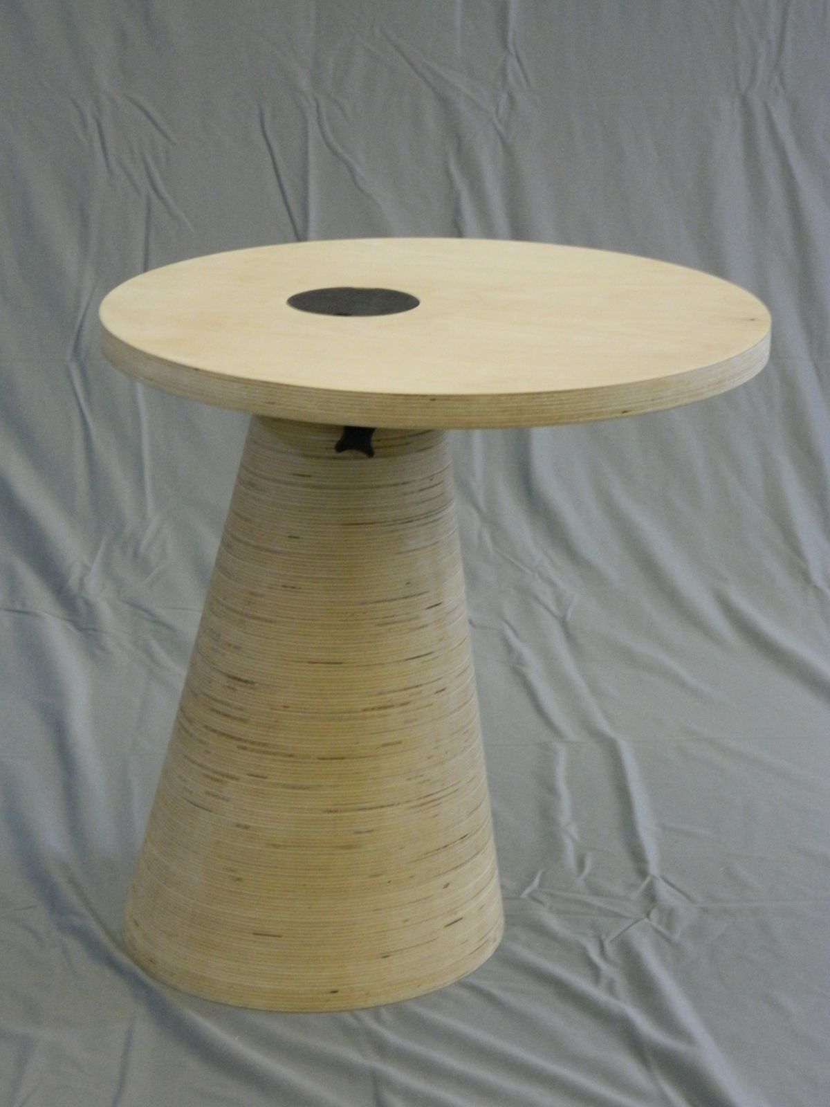

April 20, 20224 yr Popular Post comment_288875 8 hours ago, HandyDan said: Quite the operation. Next we need a nut. Yep. I'm a bit nutty, but running around and around and around a stick would make me dizzy. A teacher's screw up tale: I had a student who wanted a bedside table with a top that could rotate from bed level to bed tray level with a 90 degree turn. About 8 inches of lift required. I helped her cut a two parallel spiral slots around a 4"ish wood cylinder using the rotary axis of our CNC. It fit inside a PVC pipe with a 4" i.d.. Bolts through the outside held skate bearings that rode in the slots. A spring loaded pin could be pulled out to let the top rotate, then let loose to lock it at whatever position it was in. The base was a tilted conical shape of stacked BB plywood layers cut on the CNC. The idea worked brilliantly and made a very unique and beautiful side table. 4D Report

April 23, 20224 yr comment_289115 Photos found. Not sure the table was completely done when these were taken, but they do show the up and down positions as well as the threaded shaft. Report
April 23, 20224 yr comment_289122 2 hours ago, 4DThinker said: Photos found. Not sure the table was completely done when these were taken, but they do show the up and down positions as well as the threaded shaft. Now that's pretty darned cool. Report
April 23, 20224 yr comment_289148 3 hours ago, Gene Howe said: Now that's pretty darned cool. Thanks Gene. One thing we never have a shortage of is creative students. Seeing the photos again I remember that the spiral slots went flat at the bottom to keep the top high. The top rotates 270 degrees from low high to position. 4D Report
