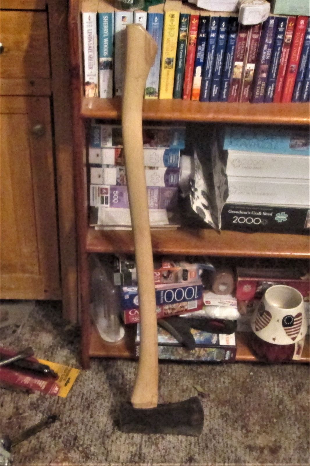

Looks like it has spent some time doing double duty as a splitting wedge too. Not that I've ever done that or anything.;)
I rehabbed one a few years back....handle had more cracks than a city sidewalk....and, yes I intend to put mine to use...so it got a new handle.

I have the Plumb I got in BSA . Last year it just snapped, dry rot. Bought a new handle but alas no plum color. MMMMM may have to try that now that I think of why it was that color.

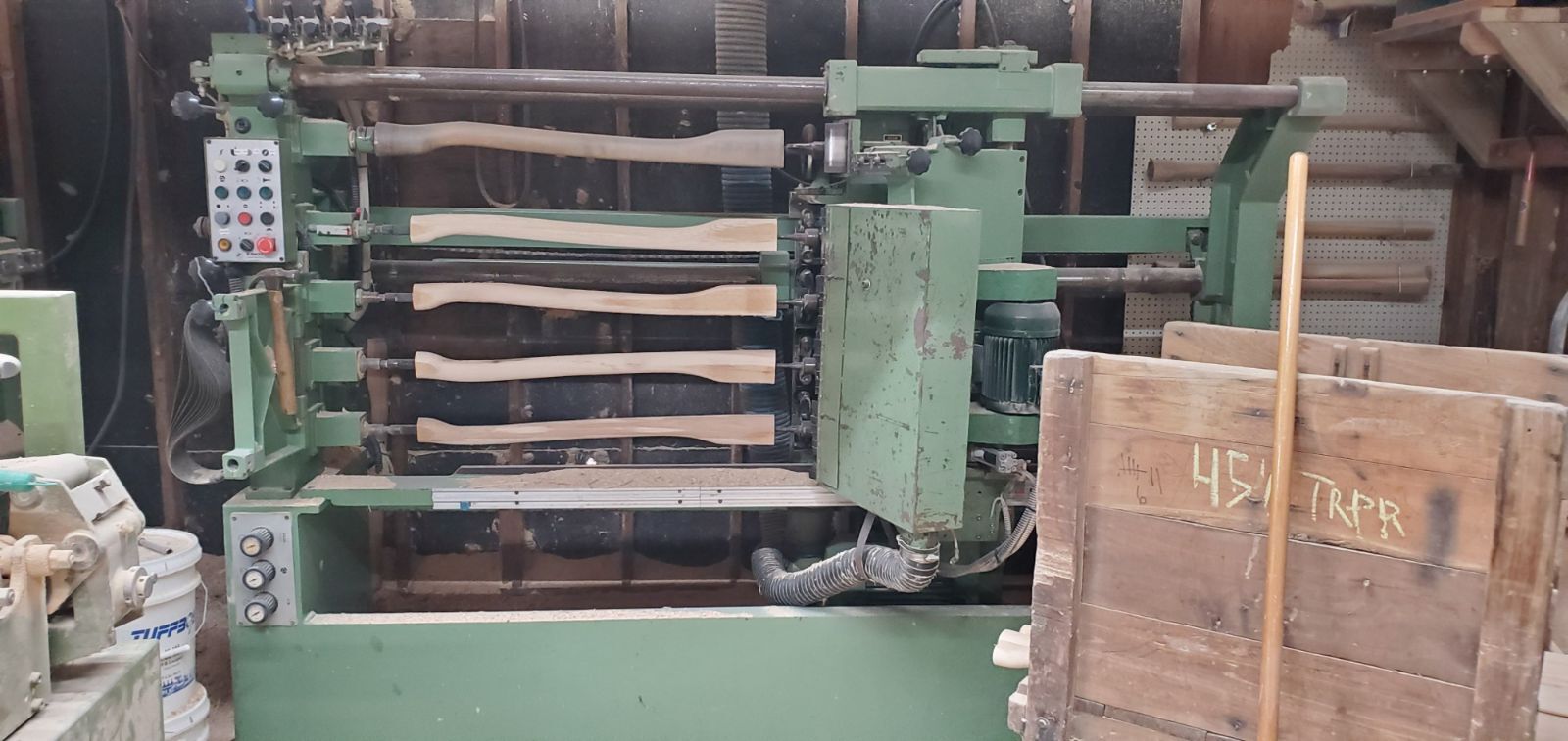

So if you're wondering how those handles are made... I recently finished converting the 3rd of 4 Bacci copy lathes that make all sorts of longer handles from relay logic to PLC controls. Only one would run in manual only and the guy had to use a hammer to make the dog release. The guy that runs them is a happy guy now.
JT
This is what I had to start with... what a mess.
JT

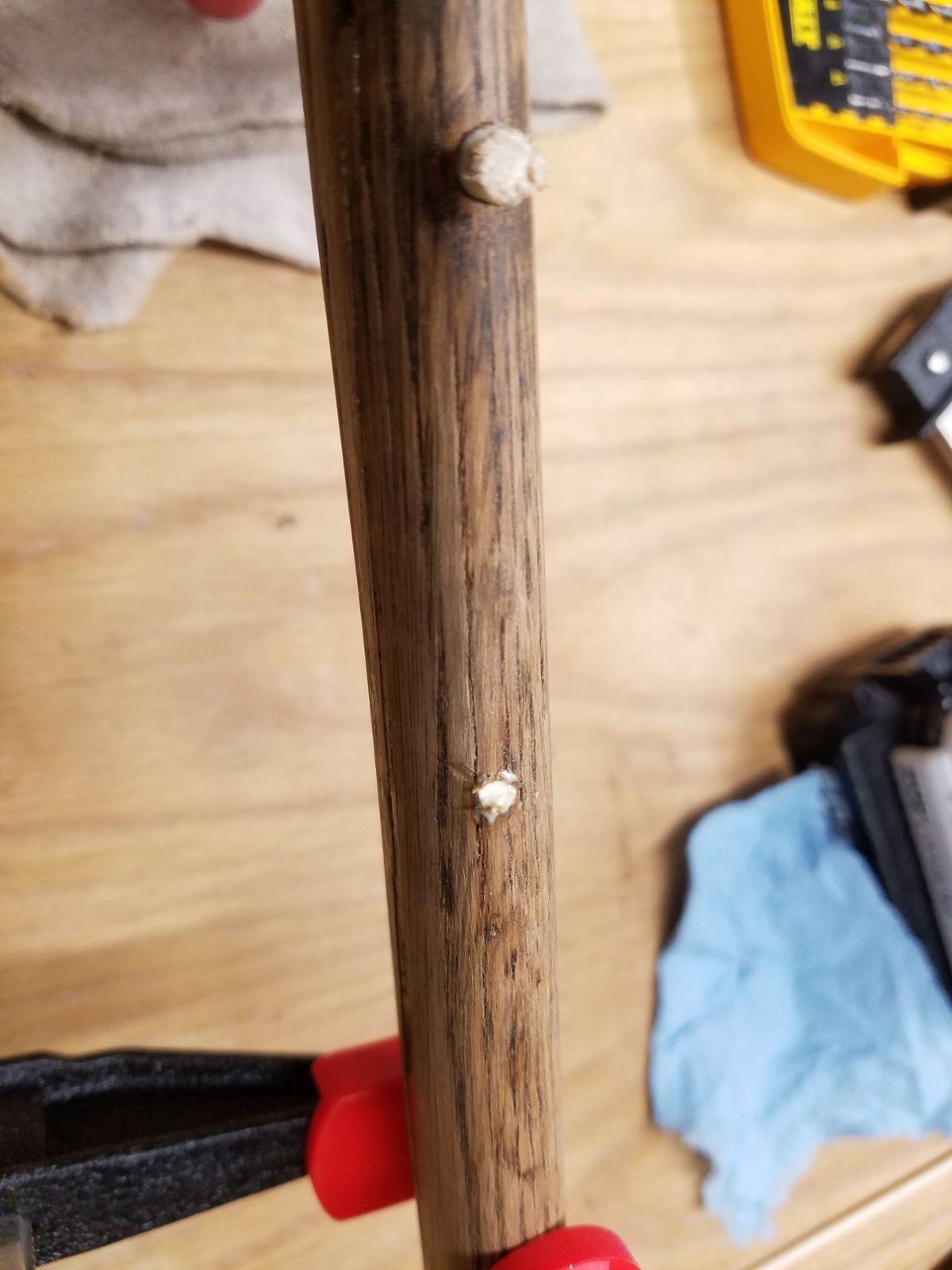

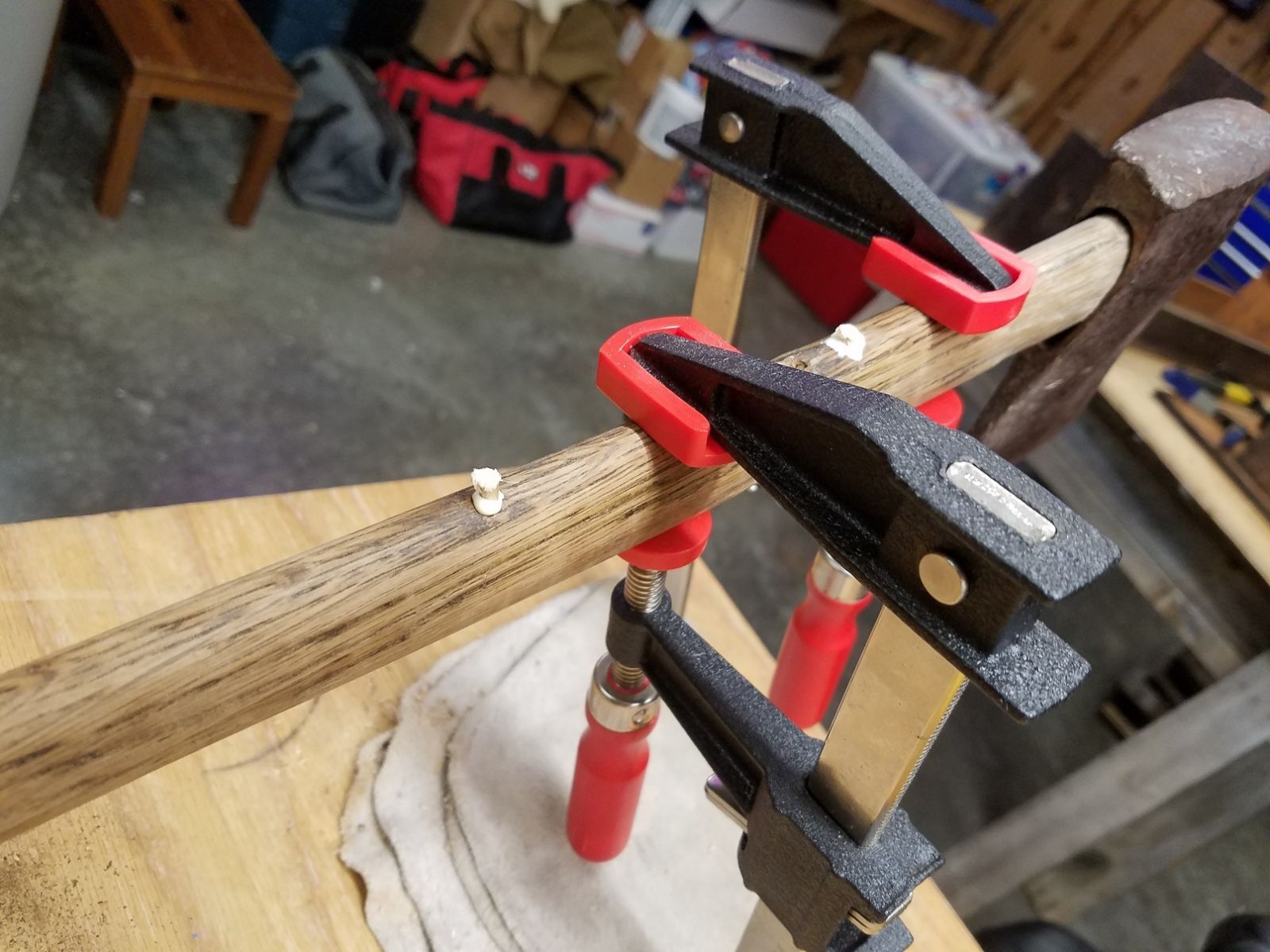

Cleaned out my screw holes... and made a few more. Got the ones going in from the top glued up with some small dowels.

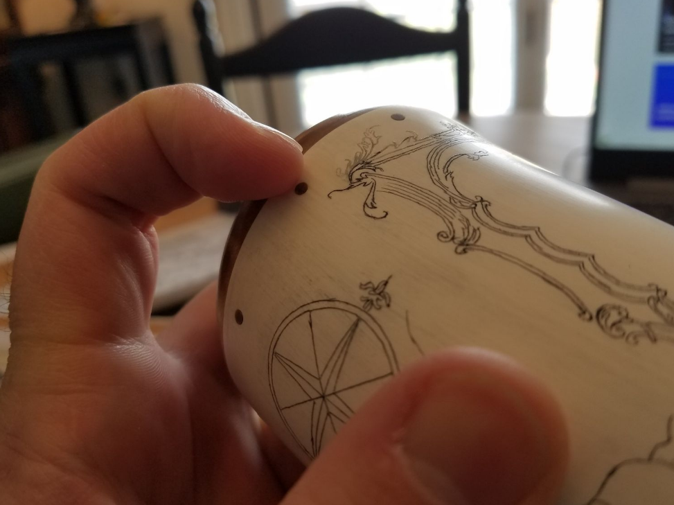

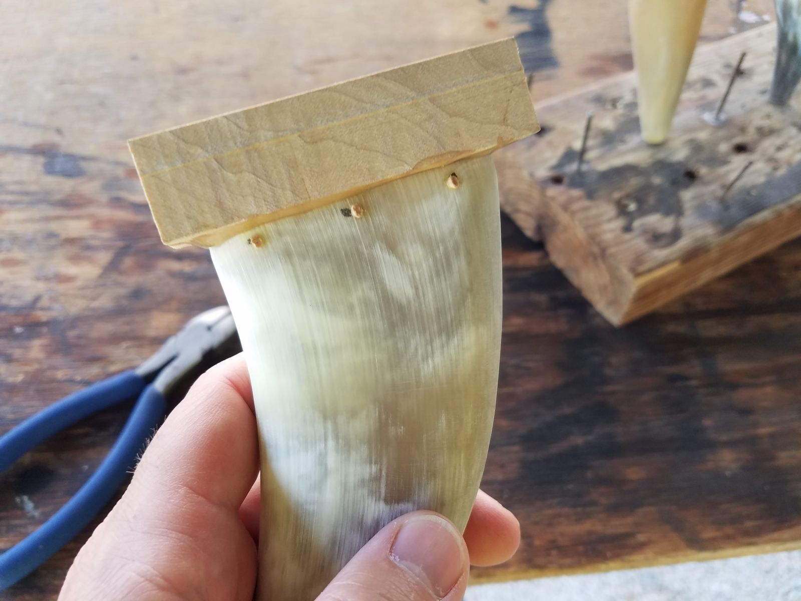

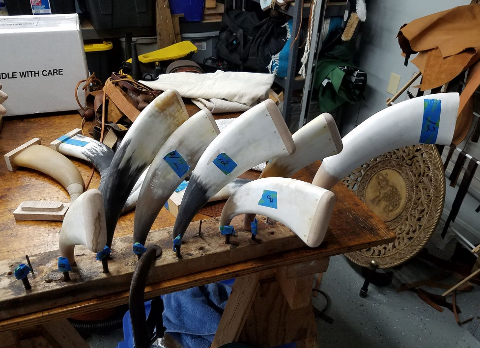

Appreciate the aging finishing tips :TwoThumbsUp:On the dowels I use enough taper to get it started...and it's tight enough to need some good taps from a little tack hammer to get seated, but that's just me. I fitted the existing holes from the screws to fit the dowels and drilled a couple of extra. I picked this up from my powder horn buddy..it's how we secure base plugs to horns. The guy has been doing it for over 3 decades and many of those horns have been in heavy use...I like the way it looks but it's quality build also imo. I prefer the look over metal nails/screws. I'll see if I have some pics...
The handle on this axe does not and never did fit the eye of the axe head. It probably did some one handed splitting in it's life but as previously stated in this thread it very likely spent much of it's life as a wedge. This thing is going straight back to the shelf when the handle is refinished...I just do this stuff to keep the voices in my head quiet :D :ROFL:
Note the 3 small dowels going in on each side. THey are catching the 1/4 inch of wood going down in the horn. When everything is sanded and finished your only left with perfect little circles. On round horns it's the same....just use as many as you need. Usually about 6.
Here ya go...I even found a pic of Bill staining them..they get stained 1 by 1 to "pop" off of the horn. I won't be staining these on the axe...other than the overall stain for the handle.
