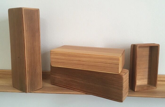

February 3, 20224 yr Popular Post comment_283191 13 hours ago, John Hechel said: it's a slow and tedious process Back when I had zero patience, old Harry North was teaching me silver smithing [his brother was Alex North]. I once complained that something was taking soooo loooongggg. Harry replied, "What, kid? You have somewhere you have to go? Got to go run off to put out a fire? Have somewhere you have to be? Some big emergency?" He was in his 80s, had seen it all, and had a way of telling you like it was. It took many more years to get a degree of patience. Restringing a mandolin. That takes patience. Now I look at some jobs, knowing they will take two weeks or four months, and stick to the program. Is a planer to level against the grain different from other planers? That's some pile of wood. My little blocks are jealous. Report
