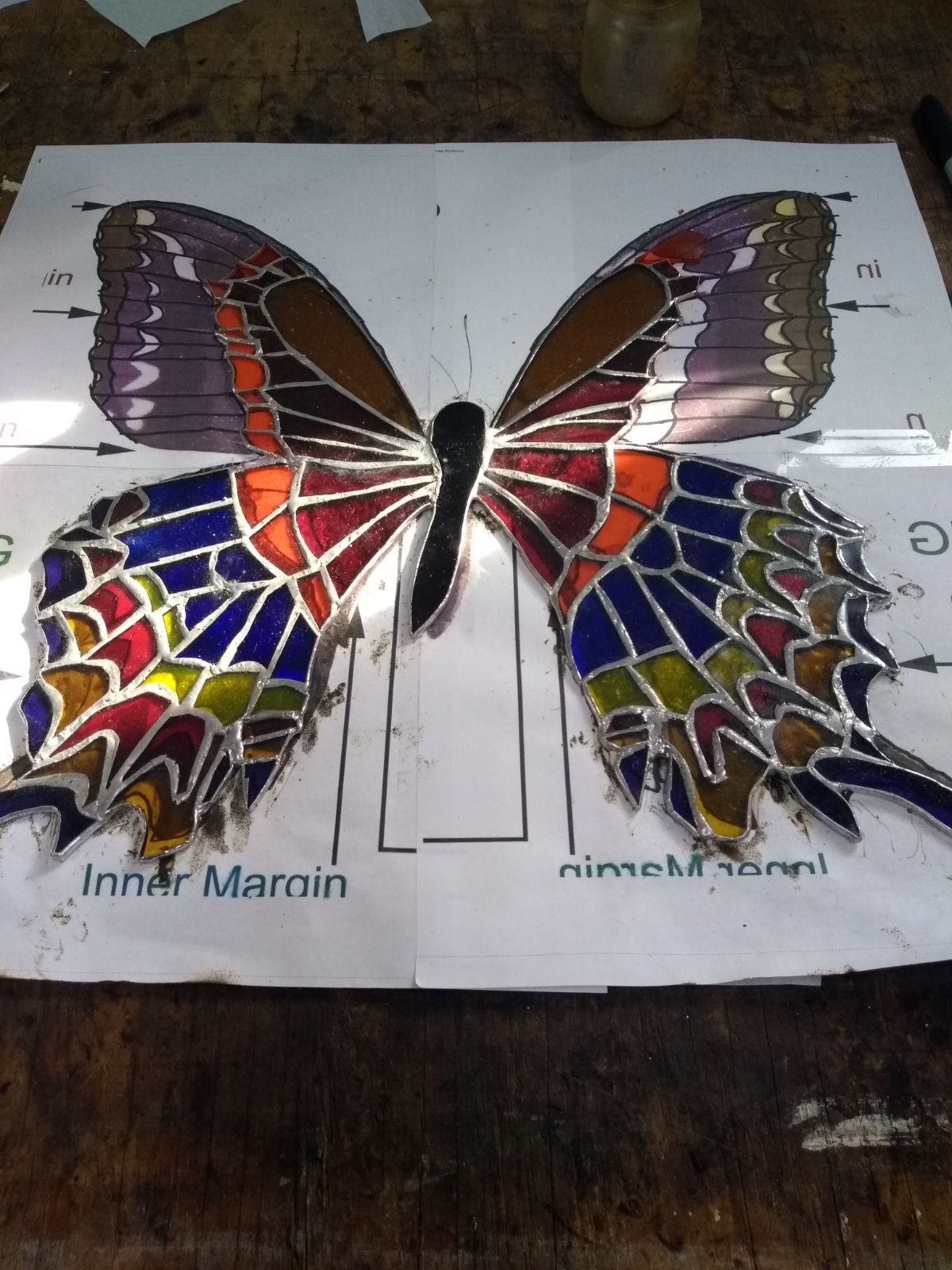

Having to put wife to work on a project fo I can frame it with wood
I couldn't think of anything to make until I saw this butterfly and since it has an unusual outline I thought it would look good with lots of wild colors wife can fab in to it.
 She still has some of the top outside of the wings to build but you get the idea as what she is doing. My request was all see through glass and plenty of wild colors!1965622412_IMG_20220131_101327493largestainedglassbutterfly.jpg.3b3c984154a87c04dfffecdea6813242.jpg

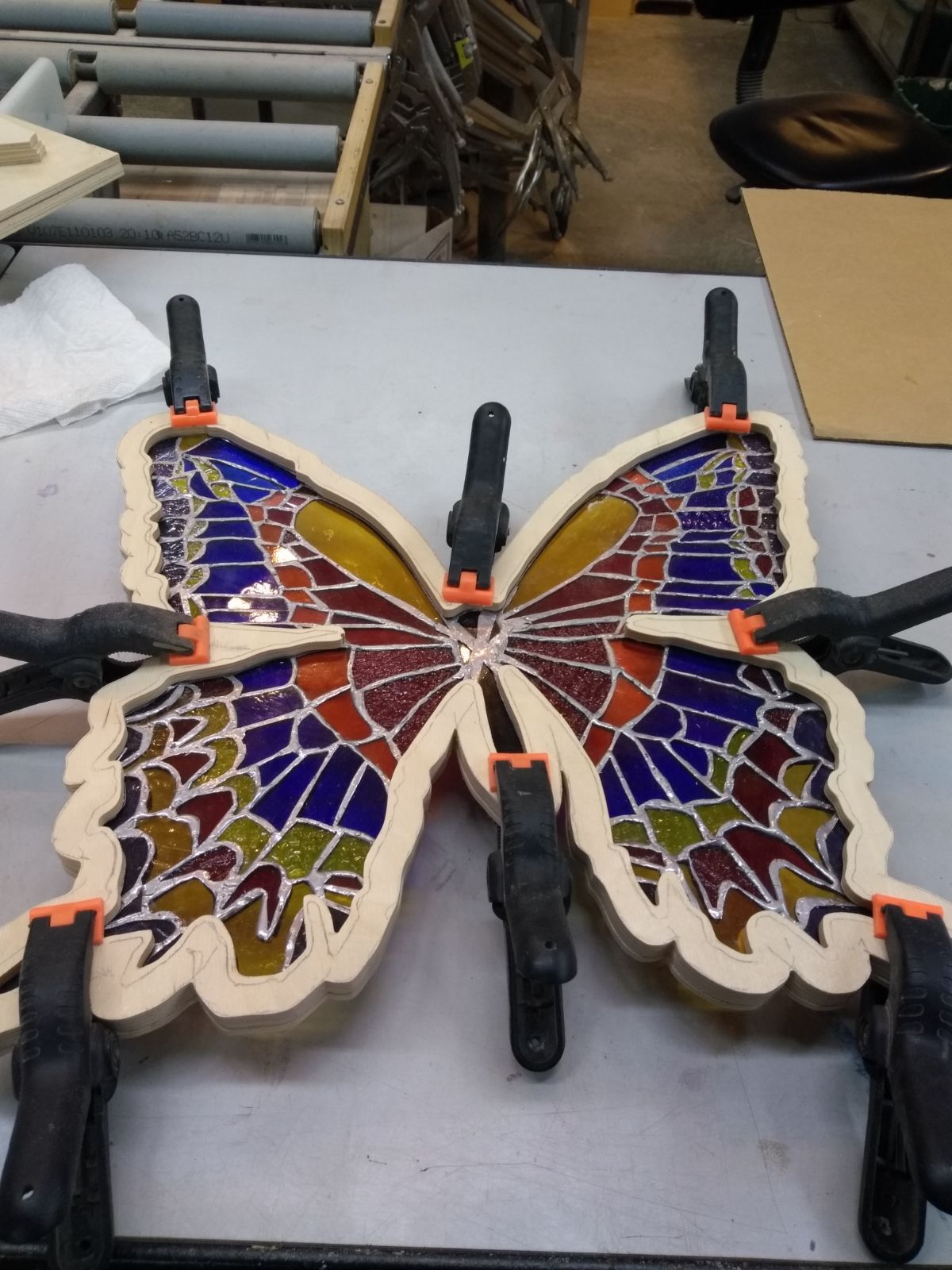

She has all the glass soldered together now its my turn to try and make a frame around the glass.
65035669_IMG_20220205_174347897frameforbutterflystainedglass.jpg.562f15d12069f532de7abfa8b69bc728.jpg

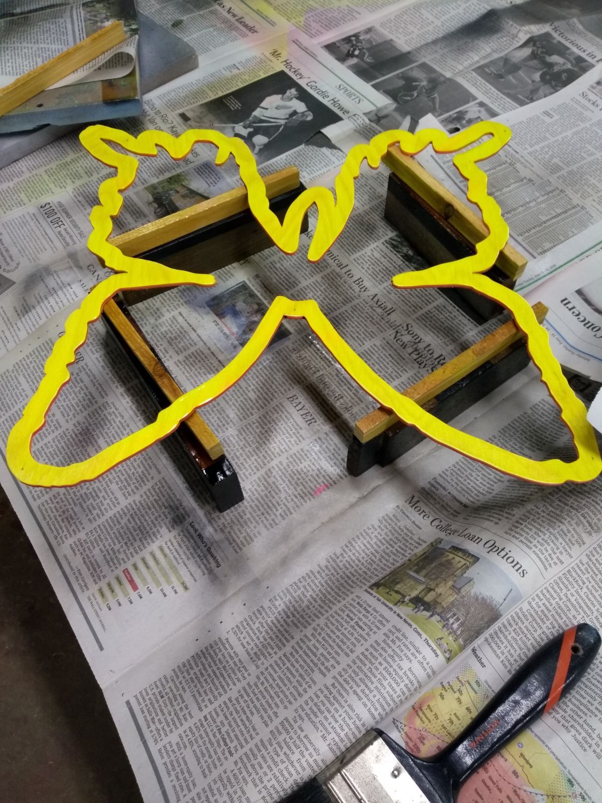

  This is much harder to do than it looks...I used 3 pieces of Baltic Birch plywood . Two pieces are 1/4" and one piece is 1/8". All three pieces I traced around the outside of the butterfly then extended that line almost 1/2" all the way around then nailed all three together and scroll sawed them out.
since the glass is all 1/8" thick I intended to use the 1/8" piece of plywood but maw and the solder made the glass and solder closer to 1/4" thick so smart thinking I used the 1/4" thick in the middle and the 1/8" for the back side. So now the middle piece of wood has to be cut so the glass will lay in and hold the glass so it will not slide around and for sure not drop out of the frame. The 1/8" piece will hold the pieces from the rear and the front piece of the frame being 1/4" thick will hold every thing secure. Tomorrow I will color and finish the frame which will become the rest of the butterfly's wings.

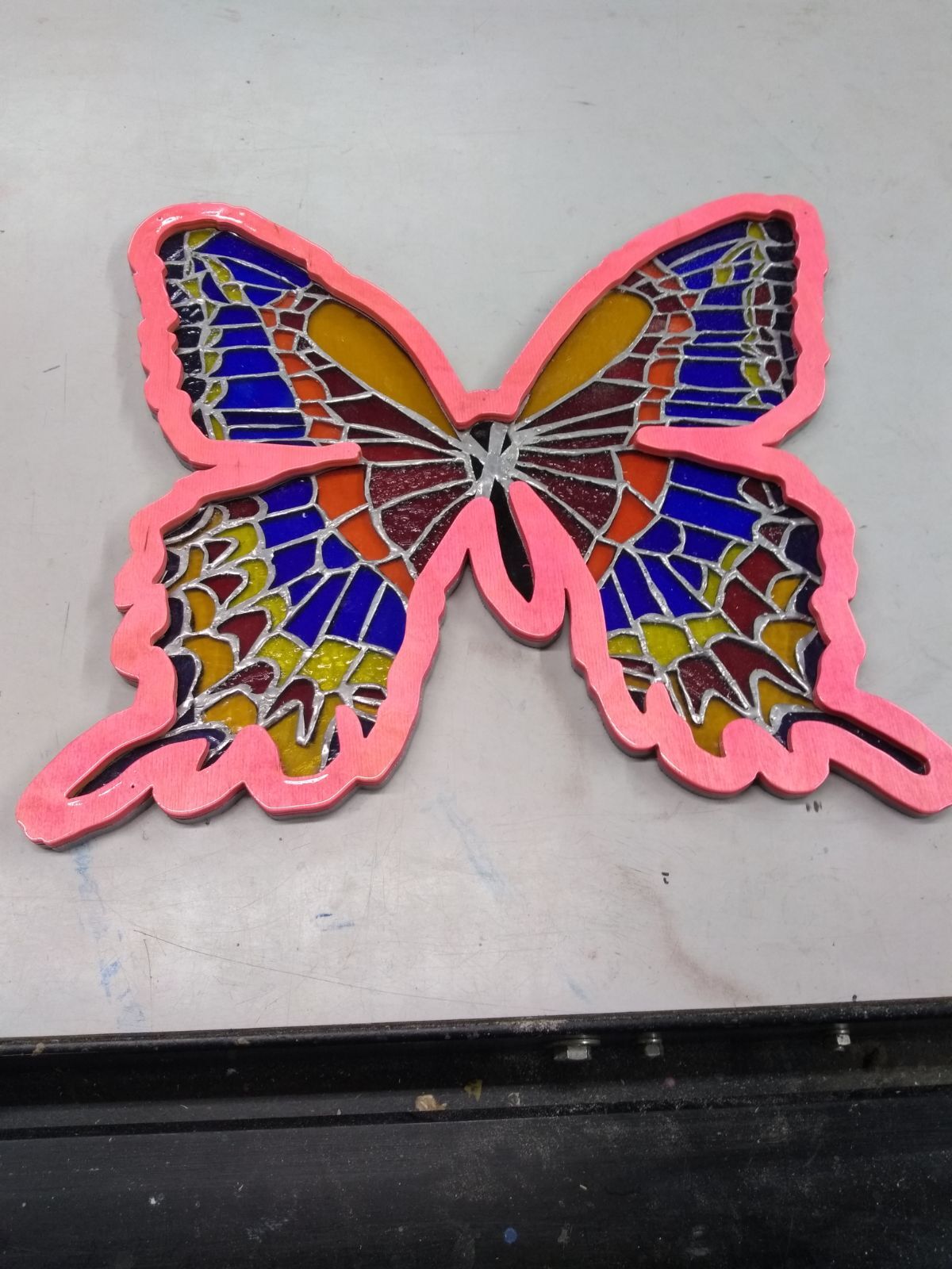

It seemed like the butterfly needed some color so I added some.190078933_IMG_20220207_192209197addedcolortothisdullbutterfly.jpg.1ddc8cdb711cdd7482e21819320a451e.jpg472858907_IMG_20220207_192214798beacksideneededcoloralso.jpg.ed88a6182ff085aba5e2a82362df6efe.jpg
IDK Patch, what's the missus think?
Just my take Patch. Beautifully done frame and glass work.  I think the added color draws the eye away from the beautiful glass work. Not criticizing by any means.
That’s what I want to know. I would listen to her.

You guy are seeing right, but when the glass is hanging in the window you hardly see the frame on the two we already have hanging in the frames!!! The brightness of out side kinda turns off the frame and turns on the glass, so to speak. So what I am doing is make this butterfly stays turned on both day and night.
As long as Mrs. Patch is fine with it, then I'm onboard.
