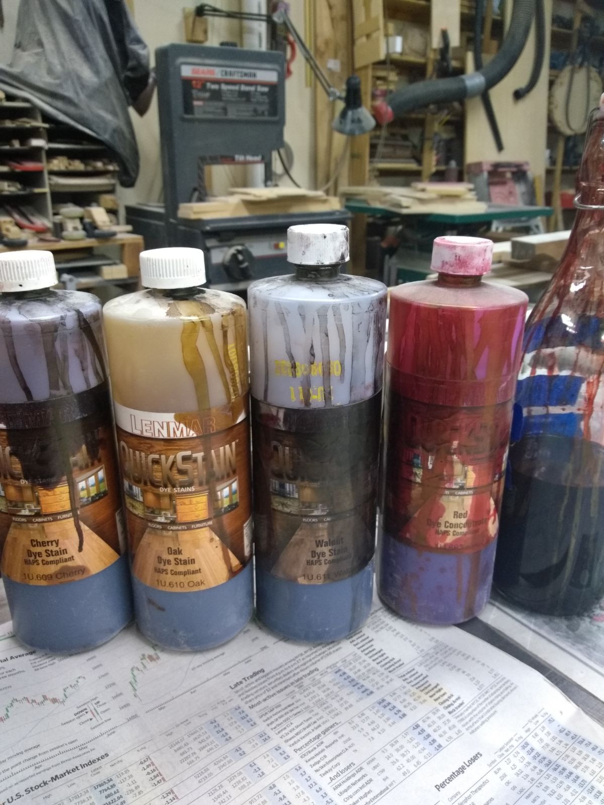

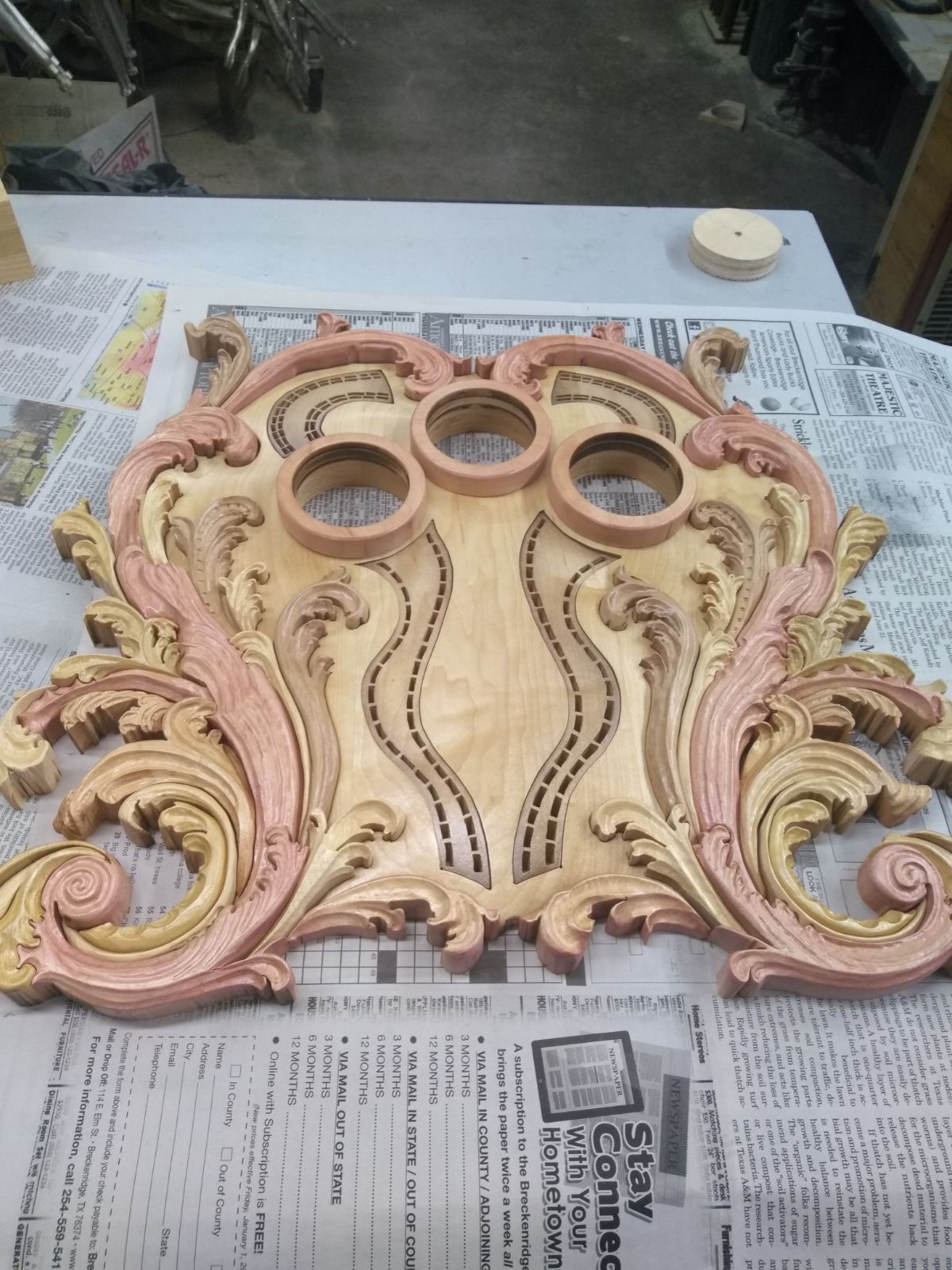

January 22, 20224 yr comment_282062 I might be different but I don't use Poly and don't use Minwax. I don' even know what you mean when you say Poly. I also find gloss will show improper preparations and flaws big time. Also if you stick with a good hardwood with a closed grain you have much less work to make something look good. This piece has three of four coats of semi-gloss lacquer with the stain being all Lenmar dye stain. The was applied with an air brush with about six or 7 drops of stain and the rest of the little 1 oz jar was lacquer thinner. This is my go to stain and probably they are not in business anymore for these bottles are at least 20 years old. If used in spraying applications a bottle will last forever, almost. In my opinion min wax or anything else should never be rubbed on with a rag being saturated with straight stuff. Thats what makes blotches and every one should know this already. These five colors are what is on the clock body. It's still laying in the bathroom with the exhaust fan running to oust the lacquer fumes before I stick the movements in and hang it up somewhere. I put the last coat on wednesday afternoon. It needs no rubbing after the last coat for I used 4 0000 steel wool between each coat to remove fuzzies. Report

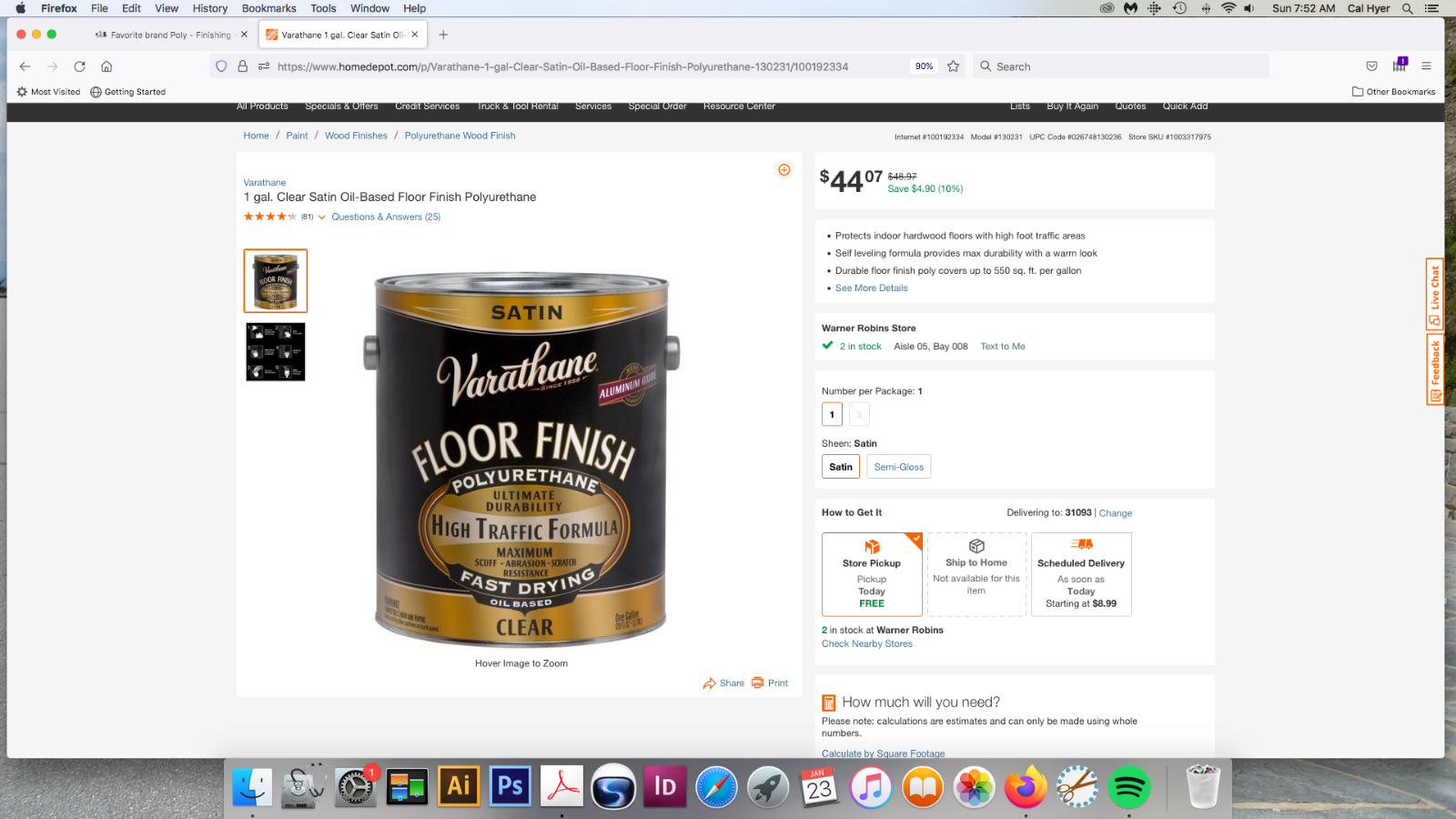

January 23, 20224 yr comment_282161 When I redone our stairway a few years back (2018) I used Varathane floor poly from BORG. Looking over my finishing schedule I applied an oil based stain, a coat of this poly thinned 10% and then three coats at full strength. The stairs still look as good as they did in 2018. YMMV Report
January 23, 20224 yr comment_282170 41 minutes ago, Cal said: When I redone our stairway a few years back (2018) I used Varathane floor poly from BORG. Looking over my finishing schedule I applied an oil based stain, a coat of this poly thinned 10% and then three coats at full strength. The stairs still look as good as they did in 2018. YMMV Over the years, I've used a good bit of rattle can Varathane on my boxes and other small items and, have been quite happy with it. However, that floor finish is new to me. Thanks for the post, Cal. And, thanks for the application tips, too. If it's good for floors, it should be great for the tables I'm building for two college bound grandkids. It should hold up for their future needs. Report
