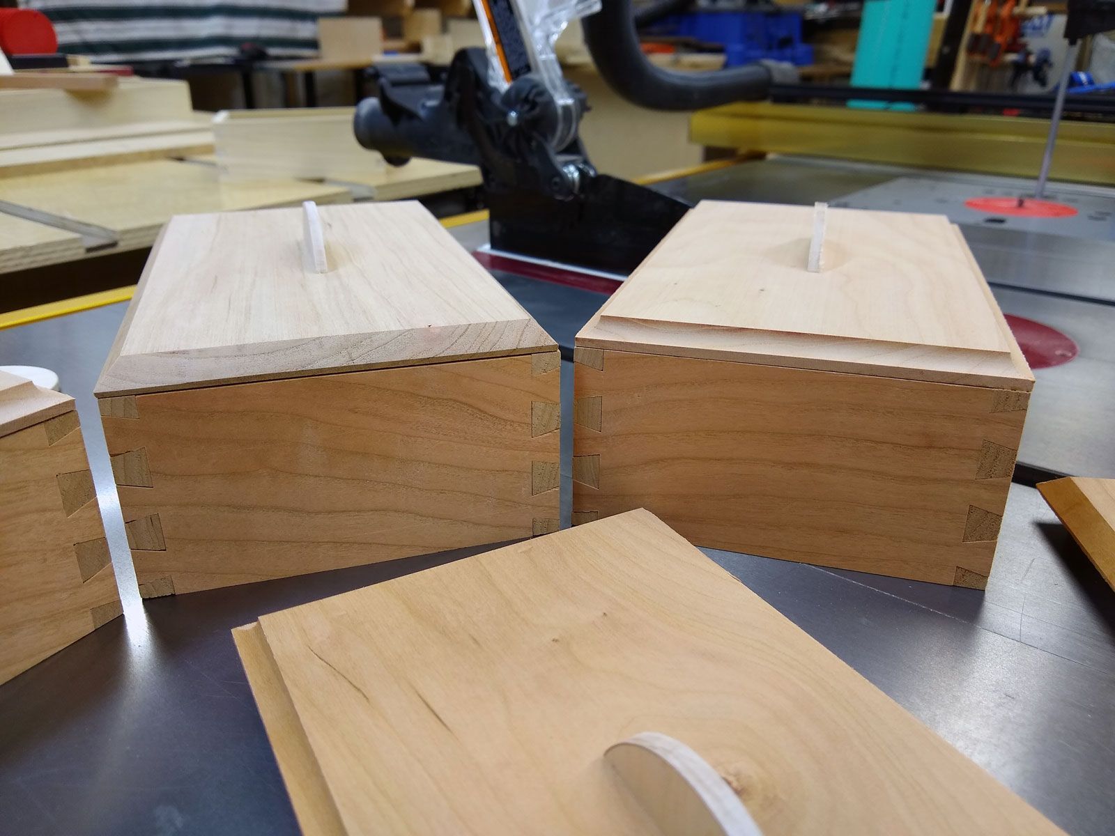

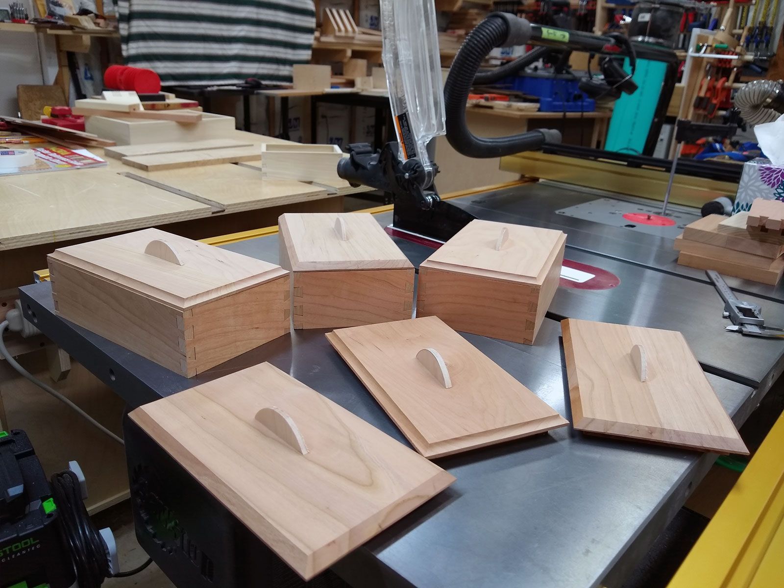

January 17, 20224 yr Popular Post comment_281598 OK, sounds a bit vague but as I'm making some of my 1st dovetail wooden boxes I'm left to wonder...assemble the box then apply finish, sand, apply finish....you get the idea. The tops and bottom pieces are being finished now before hand but I'm unsure about the box itself. I think it would be proper to glue the boxes together 1st hence the bottoms and tops being finished now but again it's only a guess. I made two styles of tops (no hinges on these) because I couldn't decide which I liked most. In my mind I envision gluing the 4 sides after the bottom is ready and cleaning up the glue as best as possible. My intent is very light coat of Titebond II on both pins and tails then assemble. The bottom can float. These boxes are small with 3 dovetails each so drying fast shouldn't be an issue and they dry fit just fine. These are made of cherry with 3/16" white oak bottoms and I cut circular handles fro the top made of soft maple. They are pictured simply sitting on the tops. I'm thinking I need to cut a shallow channel to glue the flat section onto the box. Following no plans but just as I go which I'm beginning to regret....... So any advice on my missteps or better suggestions? -Steve Report

January 17, 20224 yr Popular Post comment_281600 Nice looking boxes. Not sure if this is what you want but here goes. For any exposed joint I do sanding after assembly. There are so many thing that may need correction from glue to splits. If complex I would finish first but in this case a simple box not needed. IF you plan to finish inside do that before assembly. Report
January 17, 20224 yr Popular Post comment_281601 My boxes are finished before any lining(s) are applied. Other than that, the finish schedule is like Gerald's. Edited January 17, 20224 yr by Gene Howe Report
January 17, 20224 yr Author Popular Post comment_281608 Good advice guys and I hadn't really thought of the inside which makes total sense. Thanks for the nudge in the right direction. Gene, no liners on these. Just keeping the 1st ones simple for now. Thanks Report
