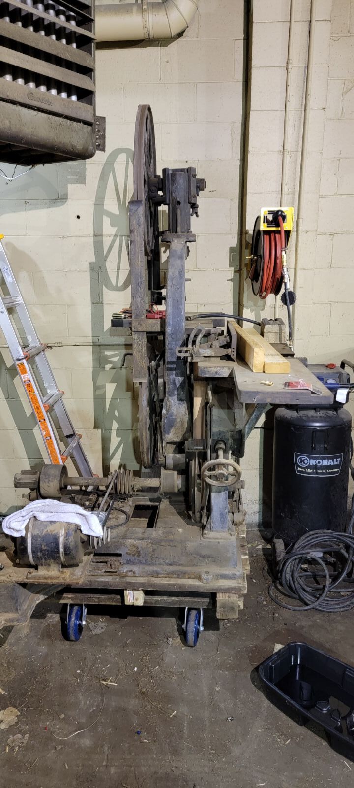

Thank you! I'll see if i can get some pictures uploaded. My machine looks a bit different. It's missing the table saw and the jointer is smaller i believe. I also can't find any markings on it to indicate manufacturer or model.

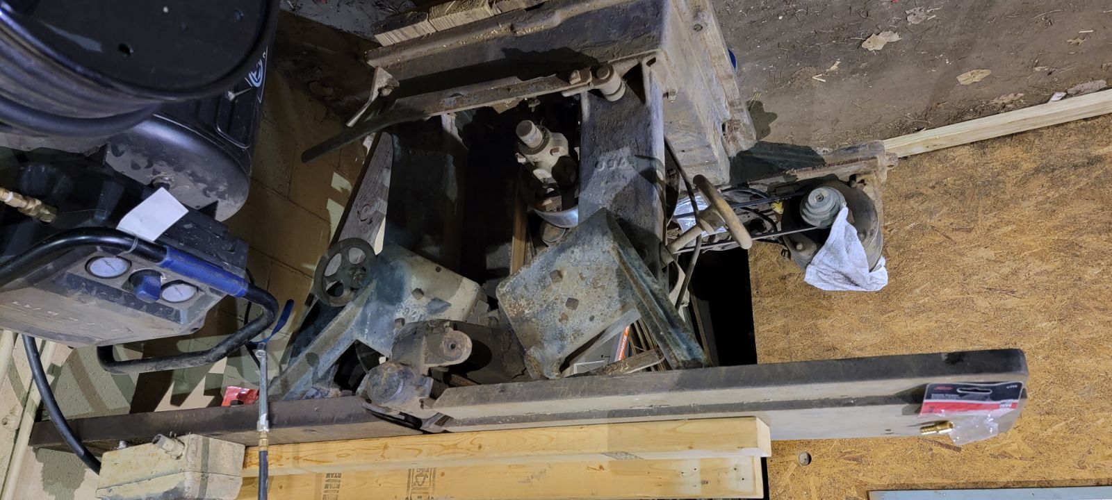

Here are a couple pictures. I know the motor isn't original and probably needs replaced.
What a cool old tool !
Paul
Quite a bit of iron right there.  Good luck with it.

Certainly, looks like a Crescent Universal Wood Worker.
If you can tell me the Band Saw and Jointer sizes, I'll see if I can ID it and find a manual.
So I'm not exactly sure how to measure the bandsaw. Its about 69" from the top of the wheel to the bottom and somewhere around 166" around for the blade. The jointer has an 8" blade.
What is the cutting width capacity? re: from center line of the blade to inside edge (distance) of support column.
Ok it looks like 26". I got the jointer running, just need to clean up the surface of all the grim to get a board to slide. The bandsaw spins free, but when I try to run it under power it hardly moves. I'm thinking its just a worn out belt.
