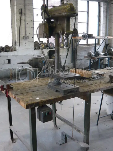

When I'm drilling holes for my fretwork, I drill a lot of holes. If I'm using the drill press (preferred method) I can only support the piece I'm drilling with one hand. The other hand has to pull the drill bit down into the wood. I want to rig up a jig when a rod extends from the drill press handle to a foot pedal that will pull the spindle down and when released the drill press handle will raise back up, this would allow me to have both hands on the piece of wood for more control. Since I'm using 1/16 inch and smaller drill bits there is little danger of the work piece being pulled out of my grip. I have used a molding chopper and a double miter saw that used this technique (factory built for it) so the concept has been used in the past.

I've heard of that being done, but couldn't find much in a search other than this old Rockwell press with a foot pedal. Looks pretty much like your idea.

Found a couple of ideas but they use some electronic actuating boards.
Fred,
  That's it!
  Thanks
