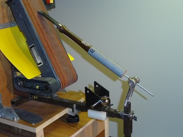

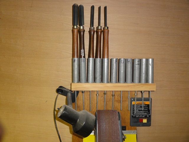

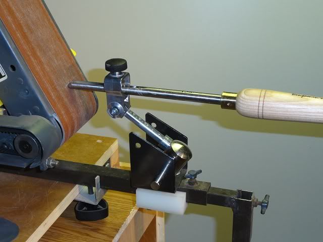

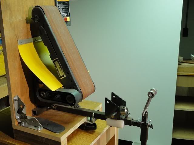

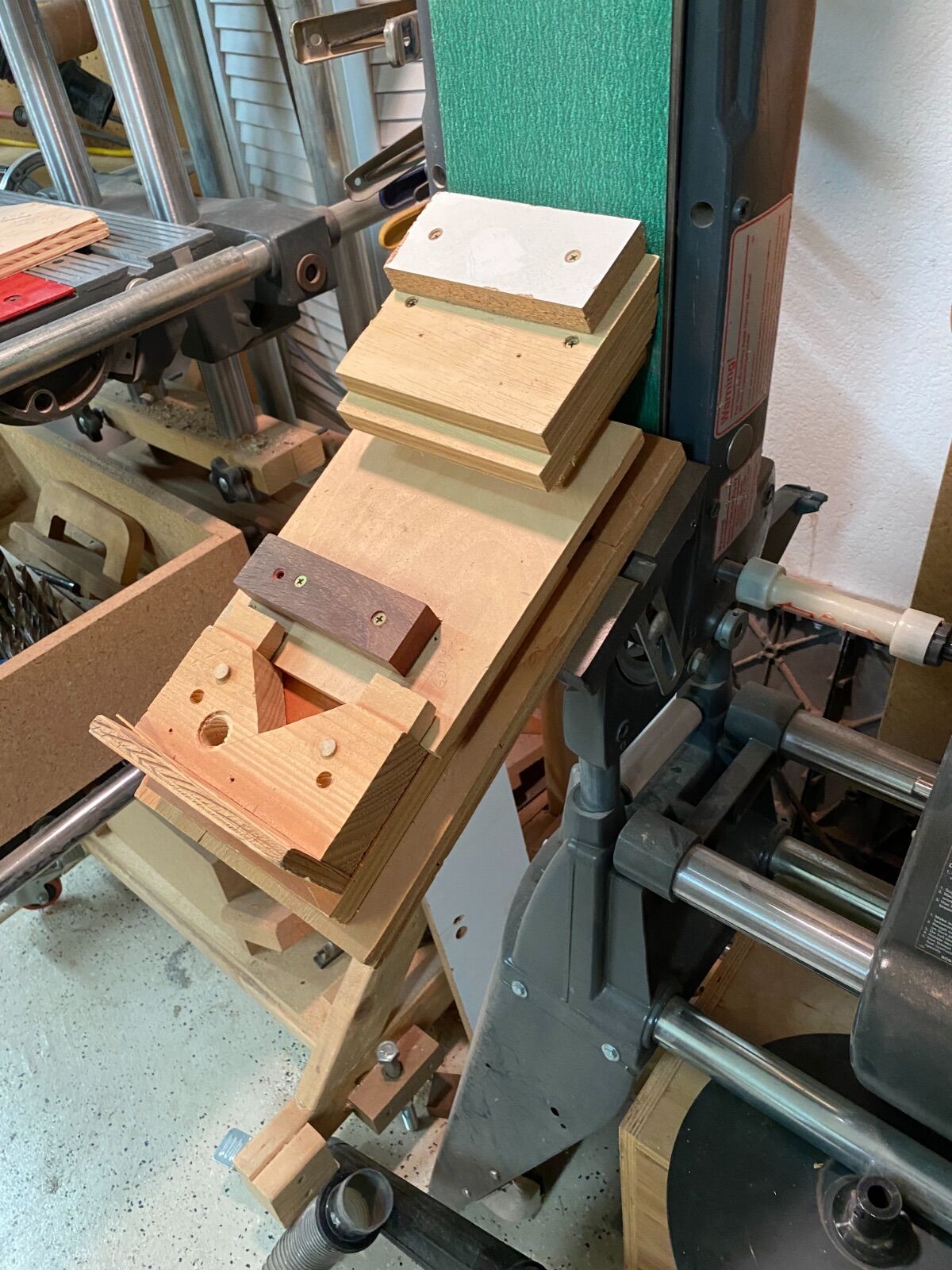

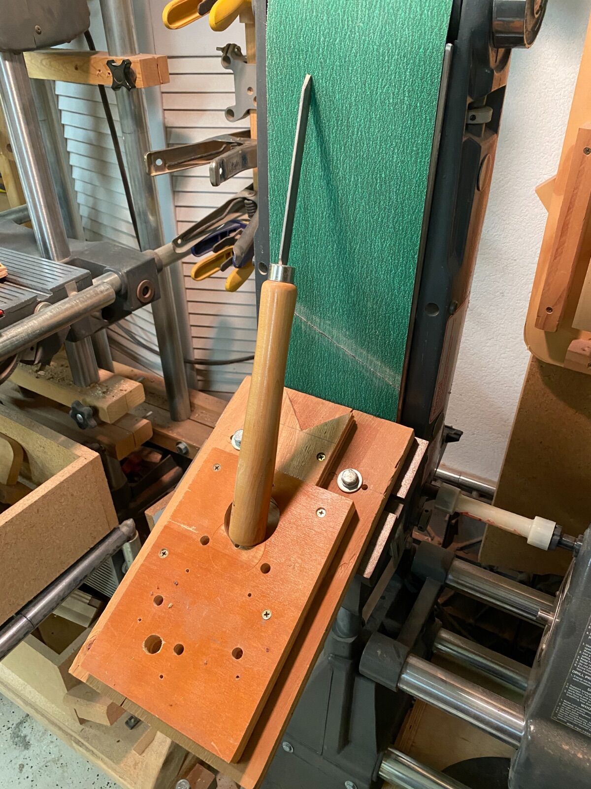

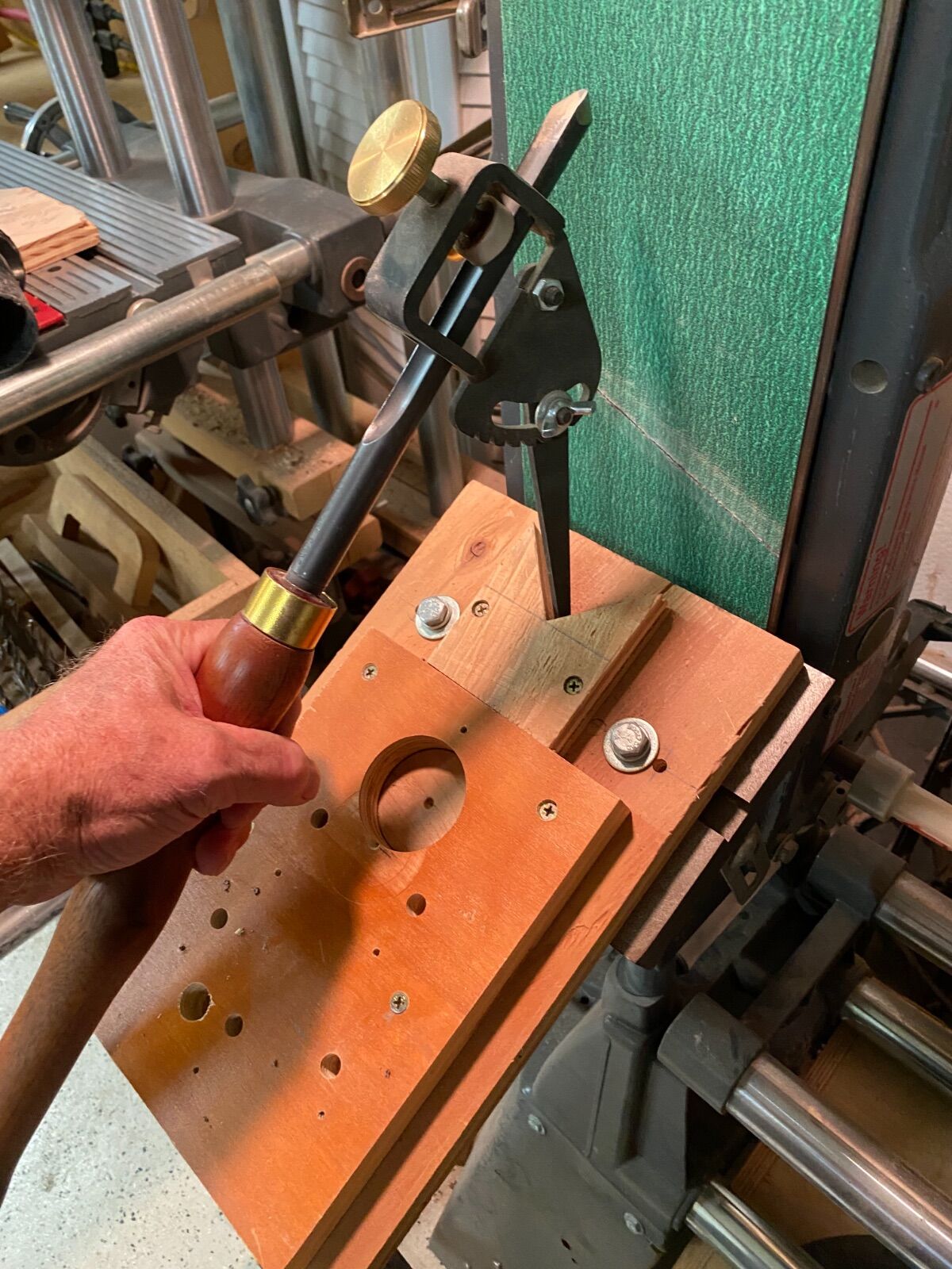

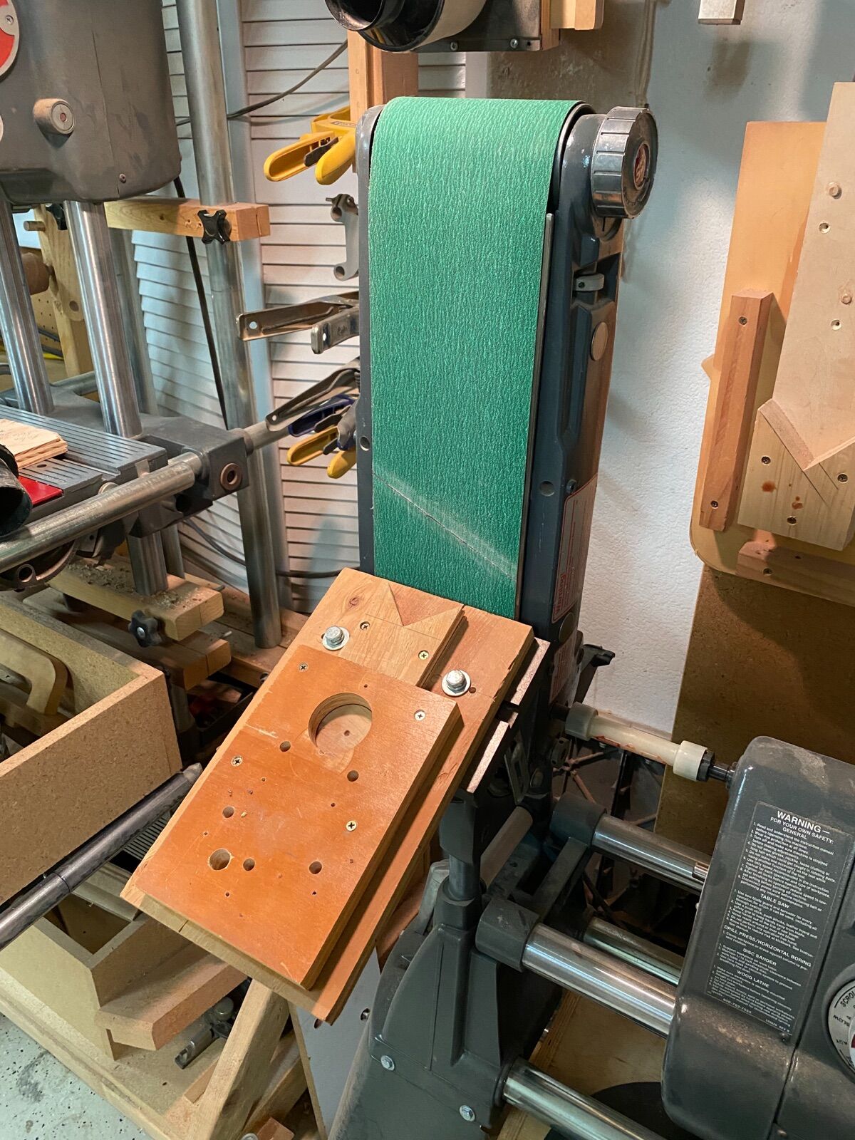

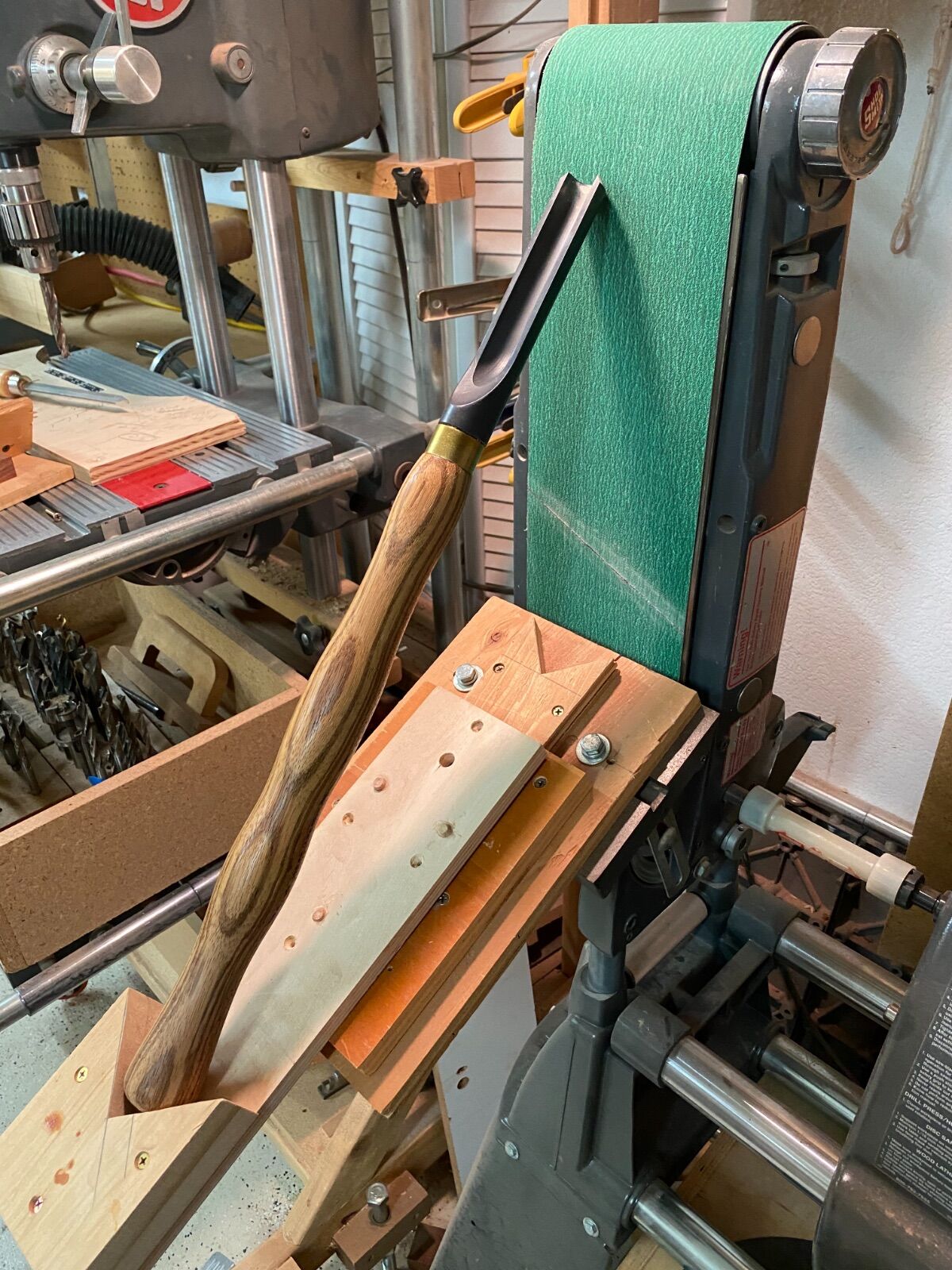

September 18, 20215 yr Popular Post comment_271356 I use a shop built version of the belt sander. I use a ceramic belt which is a worn 320 grit that gives me a very good edge. The jig has a position for every chisel I use. It allows me to switch between chisels in a few seconds. The first one of these I built used a HF 4X24 belt sander that I built a cradle for. The SS version came years later. Paul Edited September 18, 20215 yr by Masonsailor Report

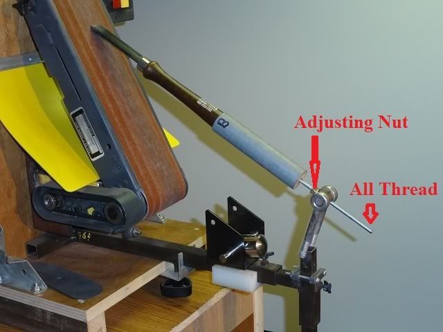

September 18, 20215 yr Popular Post comment_271357 My version has tubular pockets with all thread and an adjusting nut to compensate for length as the tool gets ground shorter. and a pocket for each tool coded with letters. then the mount for the bowl gouges and a Sorby jig. Edited September 18, 20215 yr by HandyDan Report
