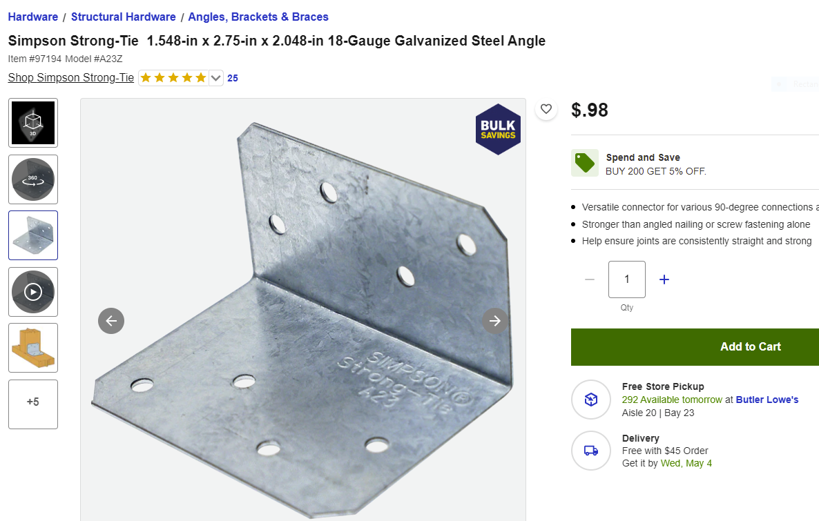

April 30, 20224 yr comment_289682 47 minutes ago, Danl said: I haven't fixed the problem yet, but I do know the reason for the problem. @HandyDan, your concerns are correct. The fascia board had moved away from the rafter tails ~ 1+". Answer me this. Why? The gutters are installed with screws and ice can build up in and over the gutter, the fascia boards with nails would be the weak link. Other possibility is a leak rotted the ends of the rafters weakening it. I would remove the soffit pieces for inspection. If all is well with the rafters you could get some, strong ties, and screw them to the fascia and rafters to hold them in place. If you need longer pieces get rafter ties and bend one end to form an angle. That would leave the gutters and fascia trim in place. Report
