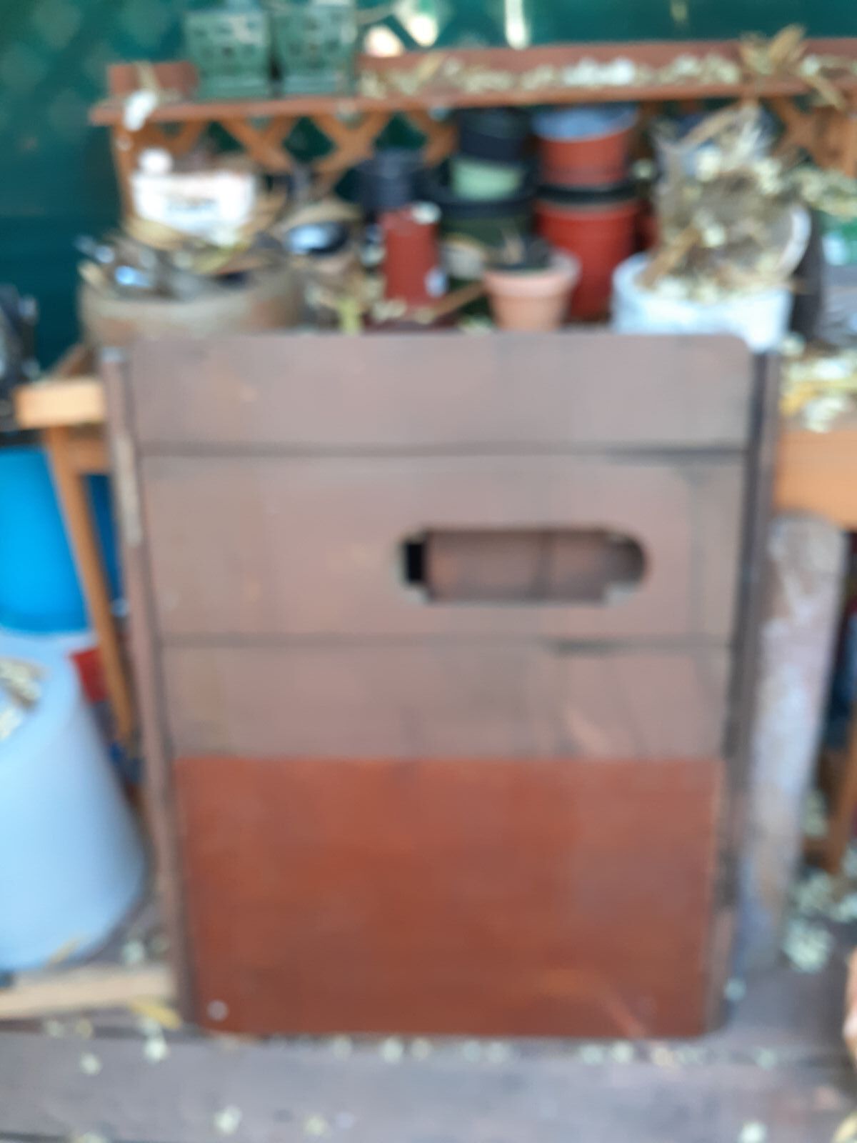

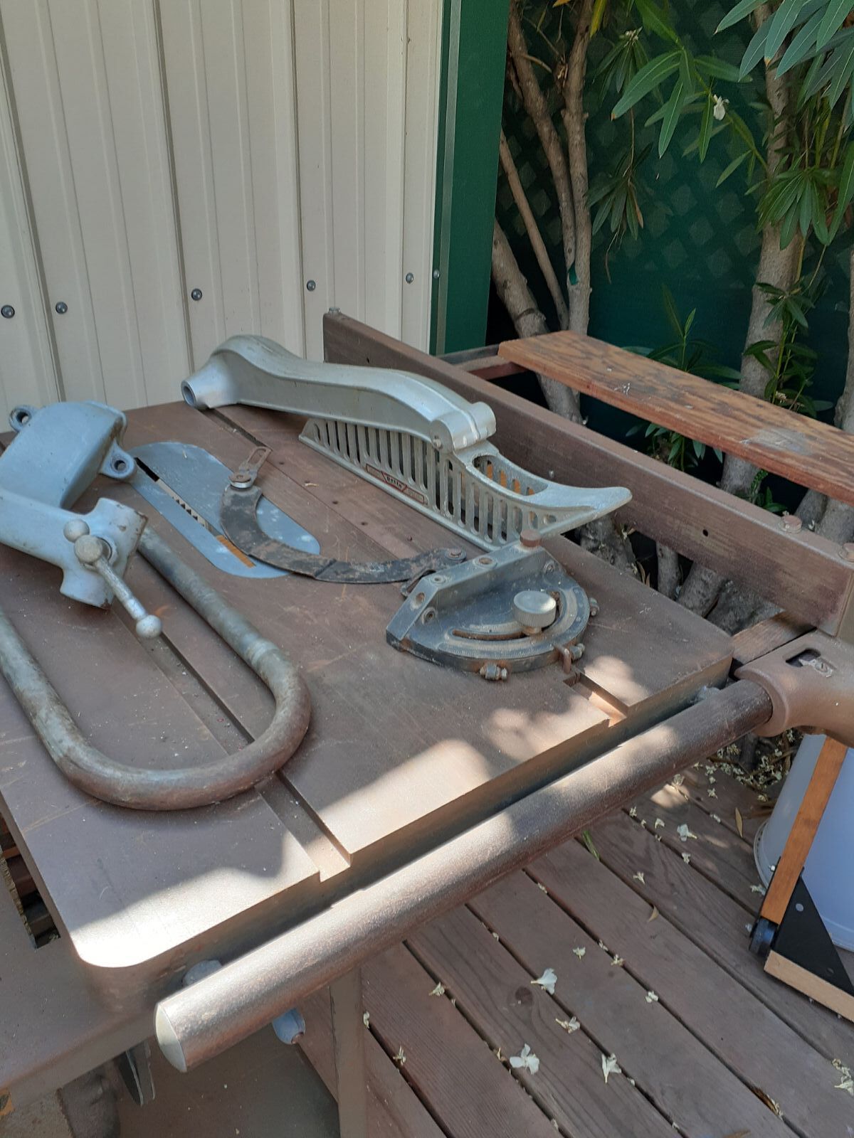

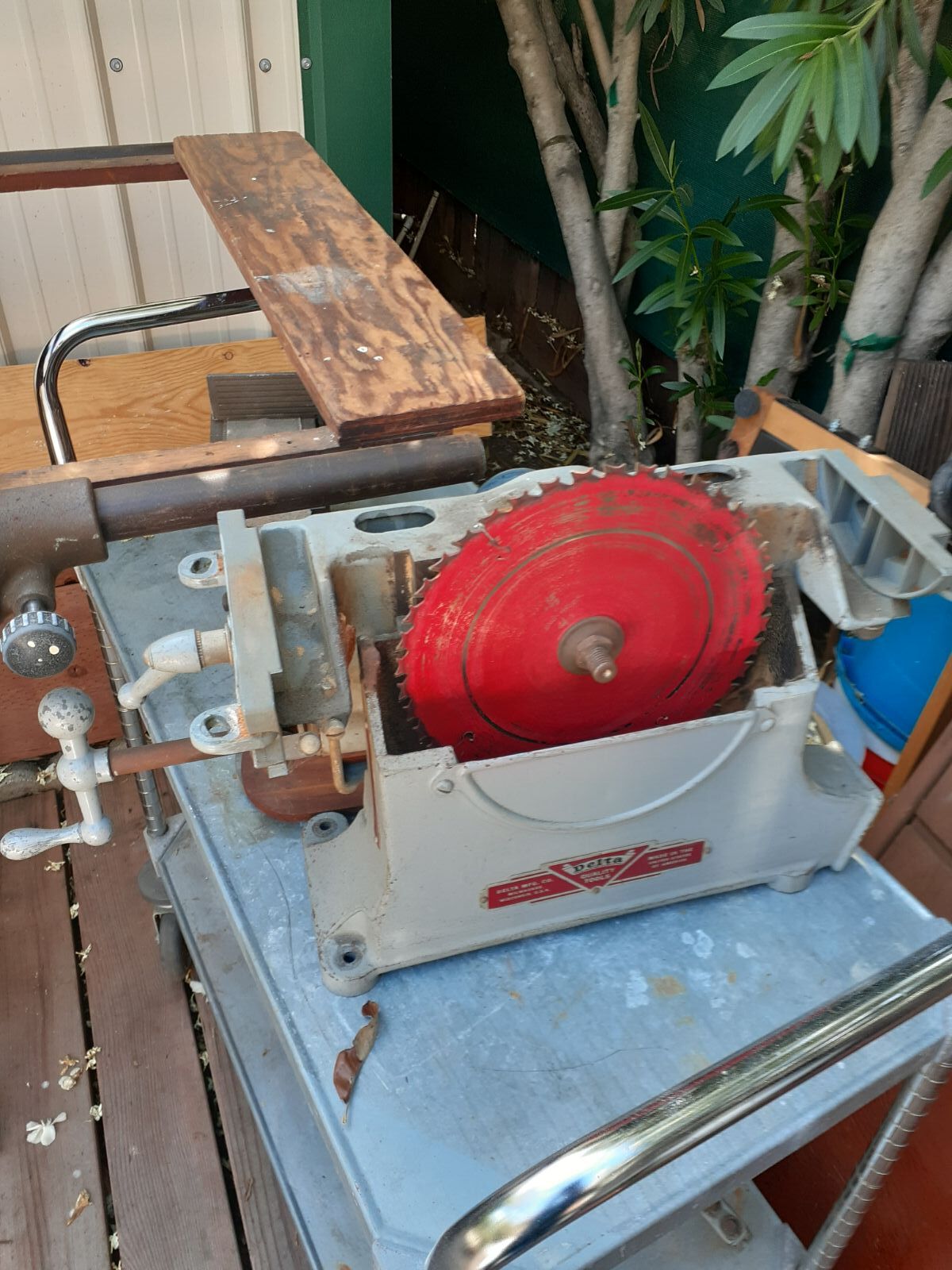

Delta 1164 10" tilt table saw and 6" jointer. Splayed foot stand, original delta motor - runs.
Un-restored - original. Great project
Jointer fence has weld on it - but is straight and true.
Also have 2 additional tilt tables, 1 tilt saw complete saw casting and wood machine roller with wheels.
$100 OBO for all - hoping it goes to a good home.
Can help load - local PU only

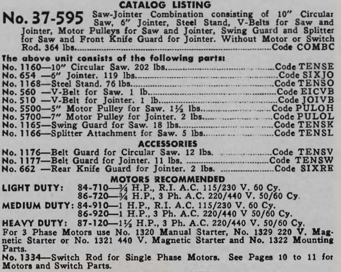

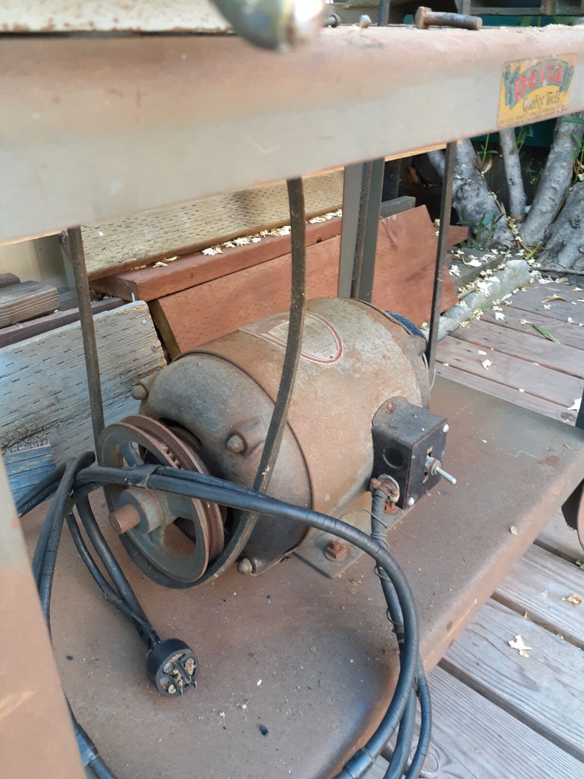

Greetings, Years ago I was given a complete 1945 saw and planer combo setup in multiple boxes. Have it all together but cannot find the correct belt sizes. It appears to have a working original motor with a 7 inch and 5 inch pulley on it. Can anyone point me to the correct belt sizes.Thank you
Your combo machines specs.
And the Delta belt size conversion chart.
@Steve Davis
For off the shelf belts these come close to the original specifications.
For the #560 a 4L580, for the #510 a 4L525.
These belts are a bit shorter so may require the use of spacer/s under the motor.
