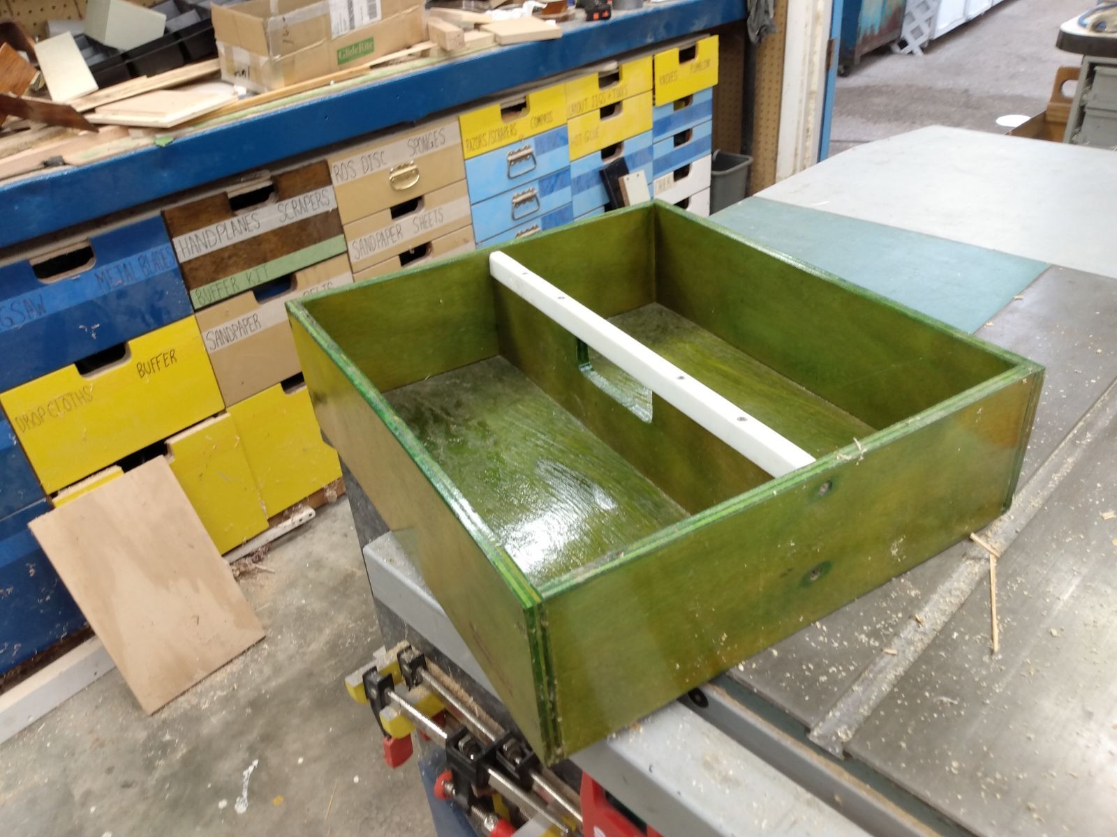

July 17, 20215 yr comment_268445 Having just brushed on coat #3 of shellac onto the Spokeshave case...was wondering IF I could do a top coat of Clear Gloss Poly over that...? Report
July 17, 20215 yr Popular Post comment_268447 My understanding is that you can put just about any finish over shellac- including poly. Report
July 17, 20215 yr comment_268450 35 minutes ago, steven newman said: case...was wondering IF I could do a top coat of Clear Gloss Poly over that...? Yes, do it all the time. Report
July 17, 20215 yr comment_268462 The rub that comes up at times is with the shellac not being dewaxed. Polyurethane finishes don't always adhere to it very good.....and sometimes they do. But if it's dewaxed (Sealcoat label) there's no problem at all. If it's not dewaxed, there may or may not be a problem. But as mentioned above, a lot of folks have done this without a hiccup. Edited July 17, 20215 yr by Fred W. Hargis Jr Report
July 18, 20215 yr Author comment_268471 Doing a Test Run, tonight....underside of the lid has a coat of clear gloss poly....waiting until the morning to see how that turns out...before a new brush and do the outsides.... Report
July 18, 20215 yr comment_268481 16 hours ago, Fred W. Hargis Jr said: The rub that comes up at times is with the shellac not being dewaxed. Polyurethane finishes don't always adhere to it very good.....and sometimes they do. But if it's dewaxed (Sealcoat label) there's no problem at all. If it's not dewaxed, there may or may not be a problem. But as mentioned above, a lot of folks have done this without a hiccup. Agree on this. You need dewaxed for poly to stick well. Sorry for the delay, internet dropped out yesterday late afternoon here. Report
