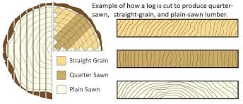

July 15, 20215 yr Popular Post comment_268362 Wood movement 101: Wood moves in two ways, radially and tangentially. Radial means from the center out, tangentially means from around the growth rings Wood species move about twice as much tangentially as radially when they absorb or desorb moisture The distance around a ring (tangential) is directly proportional to how far it is from the center (radial) [Circumference = 2*pi*radius] Therefore, if left to dry, there will be one or more pie-piece shaped cracks open up. You see this all the time in firewood that's not been split. The pith, while weak, does not cause the problem. Now, on the other hand, if you rip out a section containing the pith (center), you can end up with two quarter-sawn pieces of lumber. These are very stable and not prone to warp since most of the movement is in thickness, not width, and not a little of both that can cause cupping. I have done a number of utility projects where I buy pithy 2x12 SYP and rip it down to 2x4 or 2x6 or something in that range and end up with quarter-sawn or rift-sawn stock. In addition, 2x12 is generally used for things like floor joists and tends to be less knotty than other stuff. Menards carries #1 SYP in those sizes. Report
July 15, 20215 yr Author Popular Post comment_268367 1 hour ago, kmealy said: Wood movement 101: Wood moves in two ways, radially and tangentially. Radial means from the center out, tangentially means from around the growth rings Wood species move about twice as much tangentially as radially when they absorb or desorb moisture The distance around a ring (tangential) is directly proportional to how far it is from the center (radial) [Circumference = 2*pi*radius] Therefore, if left to dry, there will be one or more pie-piece shaped cracks open up. You see this all the time in firewood that's not been split. The pith, while weak, does not cause the problem. Now, on the other hand, if you rip out a section containing the pith (center), you can end up with two quarter-sawn pieces of lumber. These are very stable and not prone to warp since most of the movement is in thickness, not width, and not a little of both that can cause cupping. I have done a number of utility projects where I buy pithy 2x12 SYP and rip it down to 2x4 or 2x6 or something in that range and end up with quarter-sawn or rift-sawn stock. In addition, 2x12 is generally used for things like floor joists and tends to be less knotty than other stuff. Menards carries #1 SYP in those sizes. Thanks, very good explanation and pictures. Report

August 9, 20215 yr Popular Post comment_269322 I just looked at this again and the article @kmealy posted is in reference to flat lumber and you will note none of the pictures show a cut with the pith left in. I have cut the pith out of many logs and when it dries that piece (from 1-2 inches thick) always cracks thru the the pith. In turning things are a little different . The CA is a solution on green wood turned to finish. If the wood is left whole and allowed to dry before turning the crack will be thru the pith. Now there are exceptions to everything and I have had some logs for 3-5 years and no crack. Report
