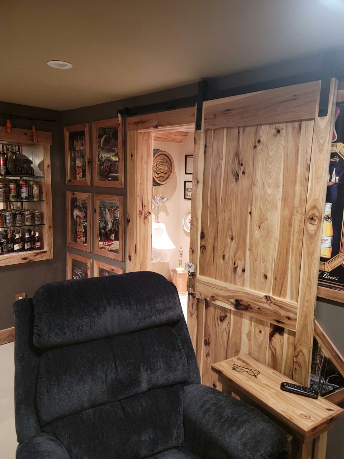

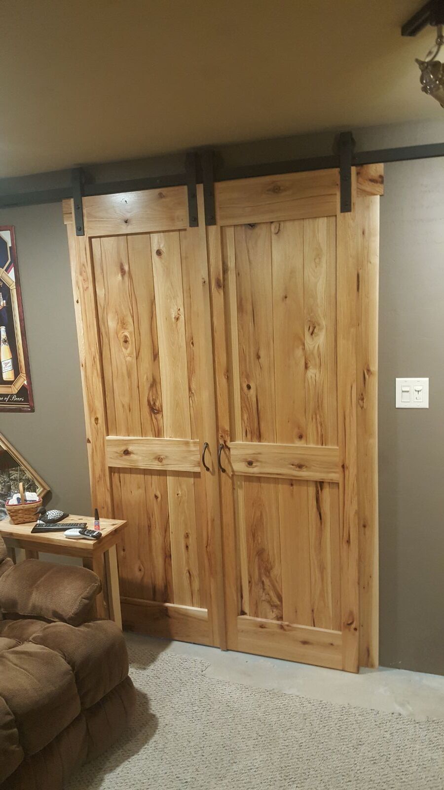

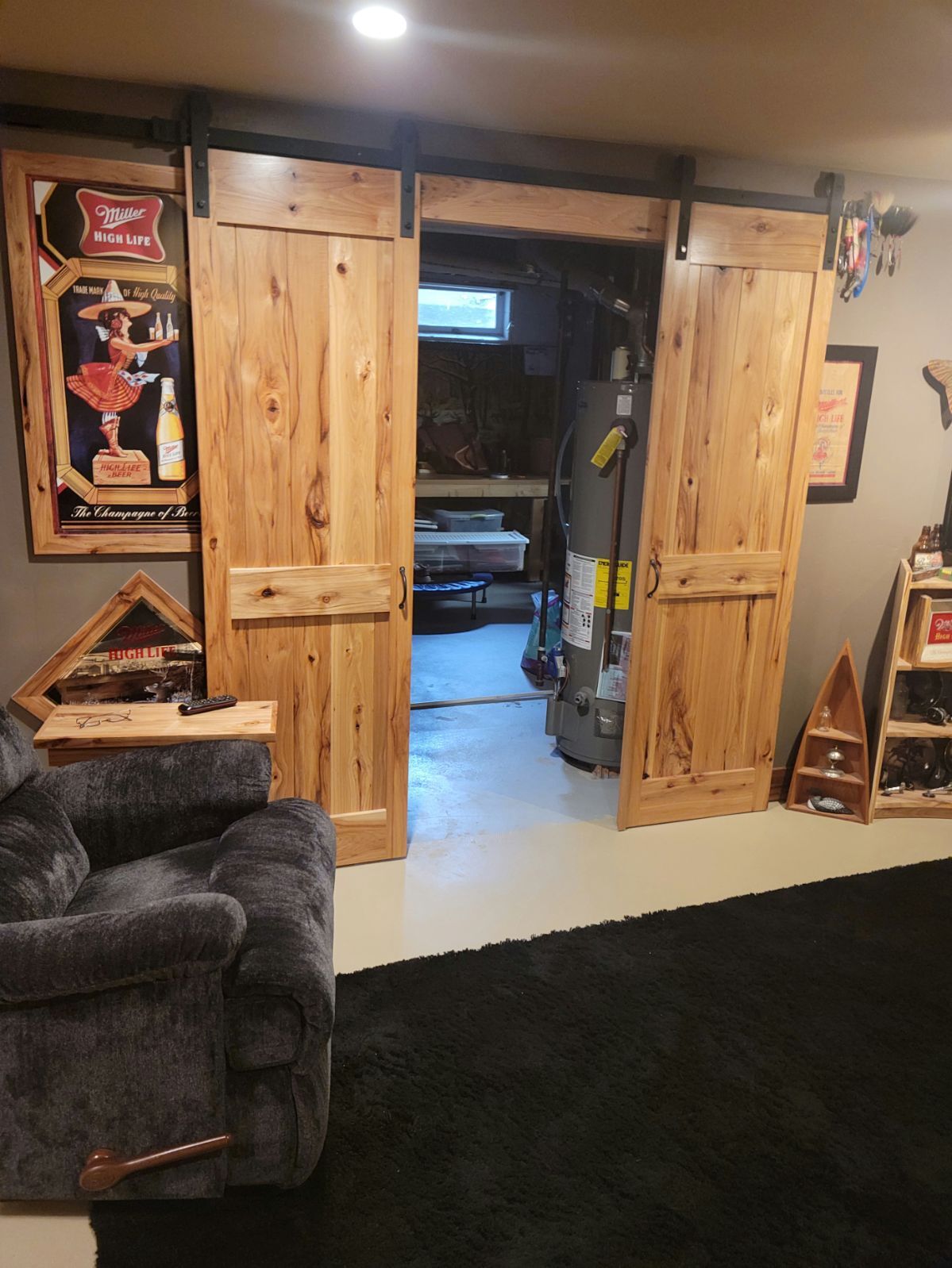

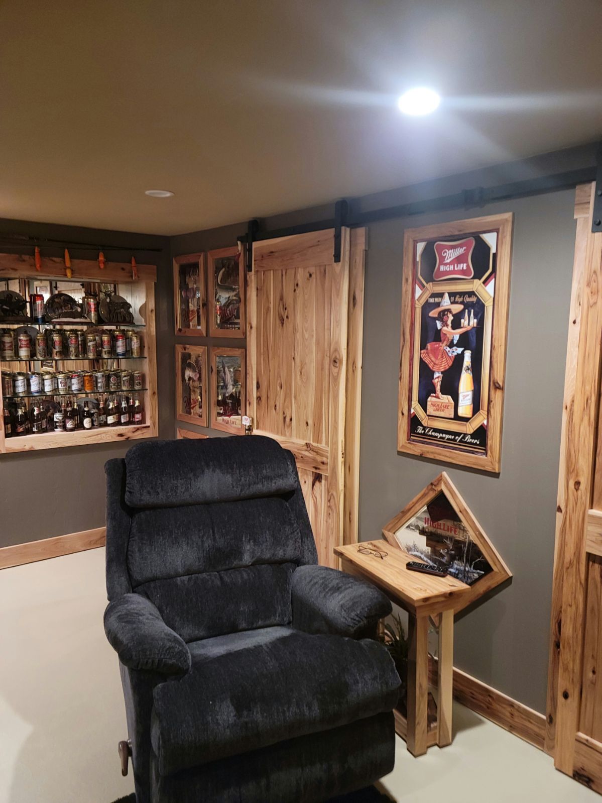

June 26, 20215 yr Popular Post comment_267413 Was included in the hardware package when I made mine. I cut a groove in the bottom of the door, so the retainer is concealed. Report
June 26, 20215 yr Popular Post comment_267414 Should say the retainer was included in the hardware kit. The plastic dealy didn't last long, I replaced it with a piece of aluminum angle stock Edited June 26, 20215 yr by Kenny Tarmack Had to add more subject Report
June 26, 20215 yr comment_267416 Kenny, that's a beautiful set of doors, well done. Does the left door slide over that wall hanging? Report
June 26, 20215 yr comment_267418 3 hours ago, Fred W. Hargis Jr said: Kenny, that's a beautiful set of doors, well done. Does the left door slide over that wall hanging? Yes it does, the bathroom door also slides over it when open, having problems posting more pics, will keep trying. Pic sizes are 9-10 mb?? Report
June 27, 20215 yr Popular Post comment_267441 BTW, the groove in the bottom of the door sounds like a much better idea than a guide that spans either side. Well done! Report
June 29, 20215 yr comment_267560 Nice doors ! One way to make the bottom guides is to cut the slot and then use a piece of painted metal angle that can be screwed to the floor for the guide. Paul Report
