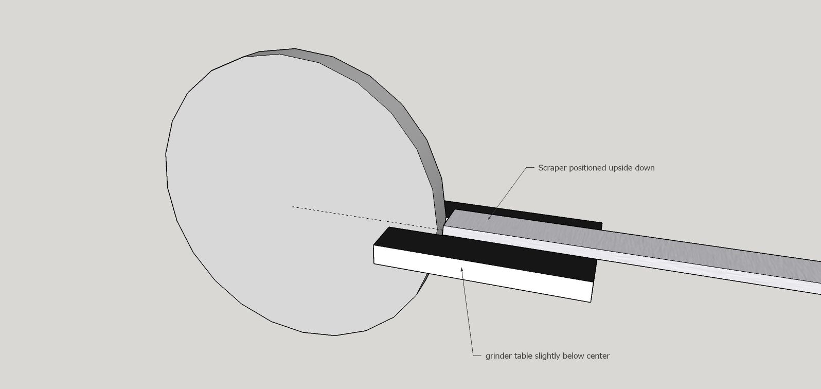

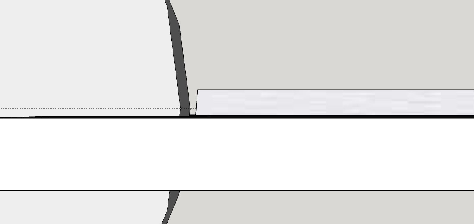

Somewhere along the line, I started doing this for my scrapers. I think the idea was totally by accident. I set the grinder table slightly below center and perpendicular to the wheel center (level). Then place the scraper upside down on the table.
The curvature of the grinding wheel creates a grind that is a few degrees off of 90 on the scraper business end. Because the scraper is presented to the grinding wheel with the top edge down, the top cutting edge leads the non cutting edge.
I found this method also creates a slight burr on the top edge- due to the grinding wheel cutting direction. That's a little easier than trying to burnish a burr on the top edge.
I should have made the wheel, in these drawings, have more segments but I think you can see what I'm talking about-
The upside down method is favored by Jimmy Clewes. I grind my scrapers face up at 70 degrees.
