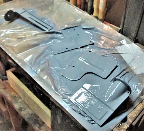

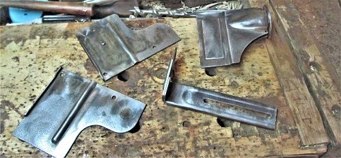

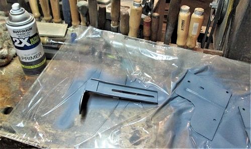

April 13, 20215 yr Author Popular Post comment_263371 Update....Those bolts and screws are now rust free and shiny. The 4 parts... Are now rust-free...had to install a new wire wheel in the 6" Bench grinder. Then lay out a "protector" on the top of the bench.. Single coat of gray primer... Let this dry a day or 2...sand things smooth, then coat with some Semi-gloss black paint...and see about a brand new deck... Hmmm...too fancy for a Miter Box Deck? Still need to fabricate two clips for the front edge....used to attach the box to a bench or sawhorse...have the metal on hand....needs cut to size, drill two countersunk holes in each one....Maybe use a Gun Blue Paste on them? Scratch Awl to bring out the scale markings, and that logo.... Stay tuned... Report

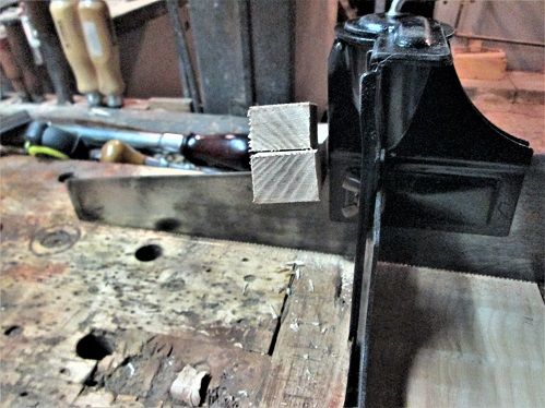

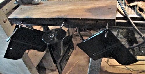

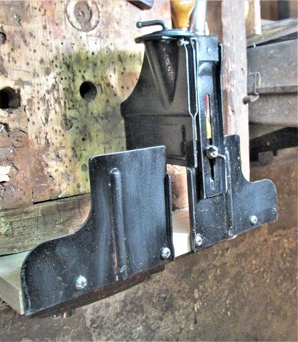

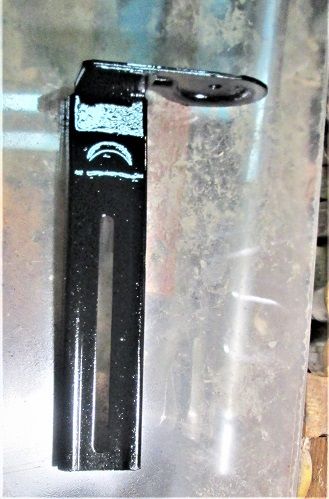

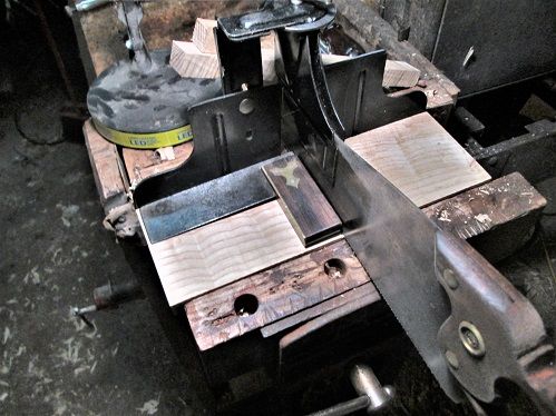

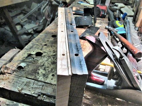

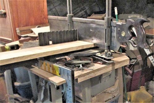

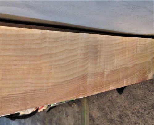

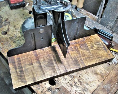

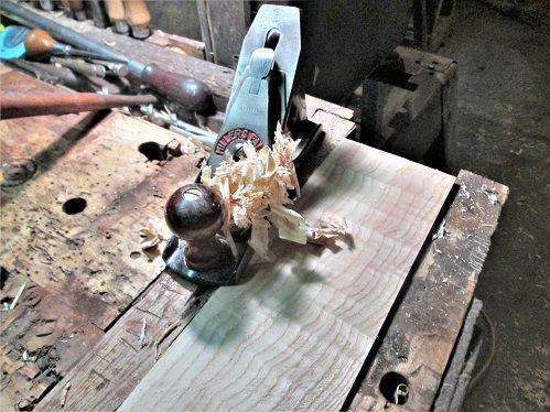

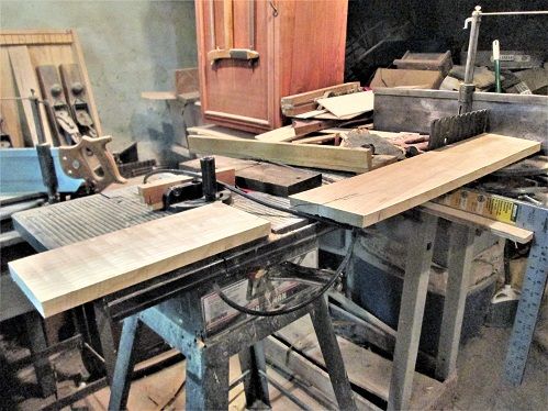

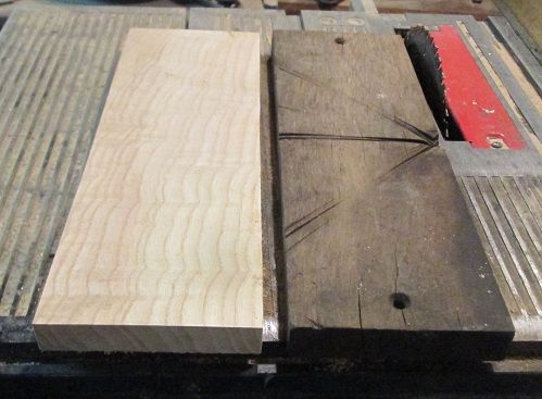

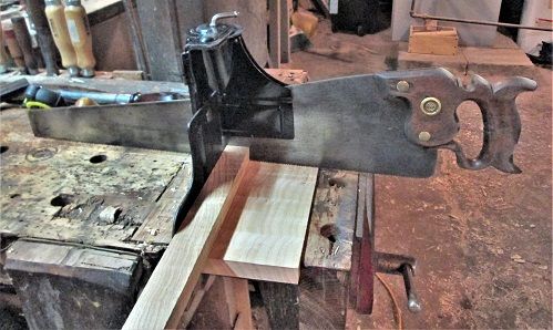

April 14, 20215 yr Author Popular Post comment_263440 Nope, just wire wheels. Black paint .. Supposed to be Semi-gloss? Cardio for today.. Cut a good section out of a 4' long plank...Mitre saw to rehab a mitrebox.. Tablesaw to rip for width.. . So the best part of the board matches the old deck board....then smooth things a bit.. Lay out and drill some BIG pilot holes, and run a groove.. Still, I needed a LOT of wax on these threads.. Test drive? Backsaw wasn't sharp enough, so.. A 20" long 10ppi Disston D-8 Panel saw seems to work quite well...and fast Coat of stain...may be a working in progress.. Set the scales to 90 degrees, and checked with a square... I left the paint off the scales, wanted to be able to READ them. Not a bad little miter box. Report
