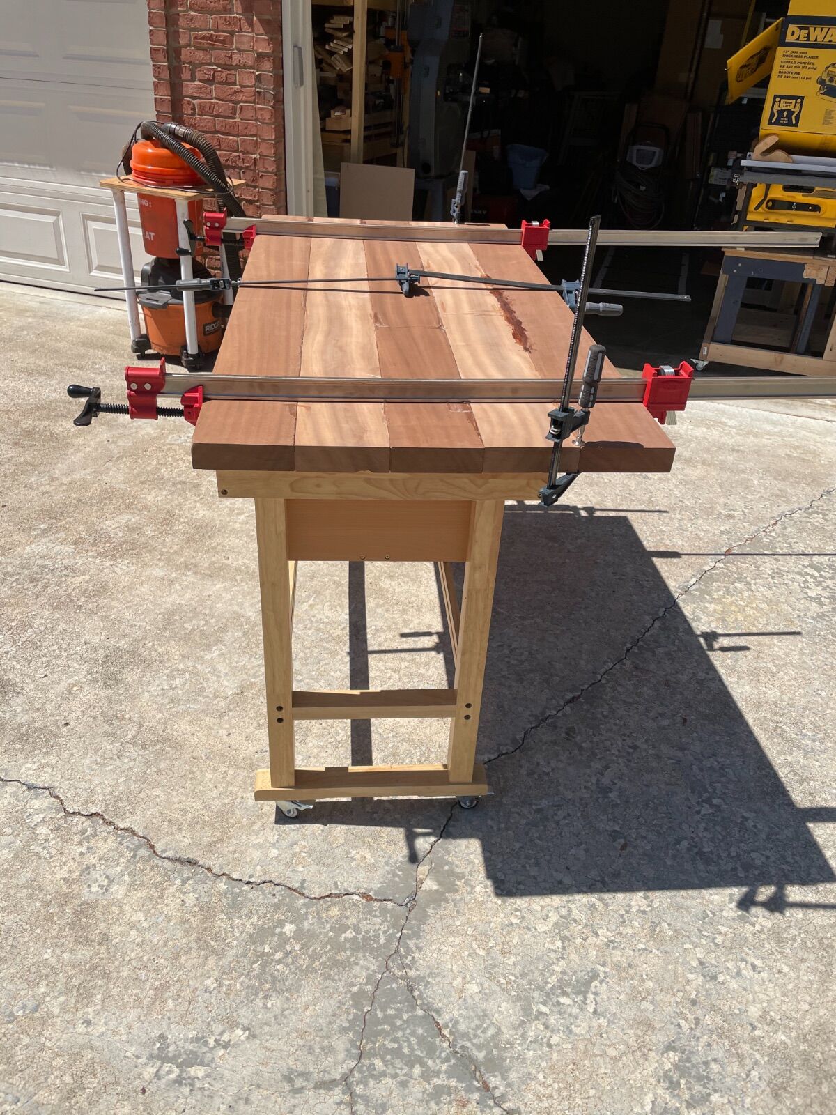

Good news the local Woodcraft hooked me up with someone with a planer. All the wood to same thickness and sanded to 150 grit before all the batteries pooped out. Here is how I am thinking of the board layout.
Happy Easter
Nice effect, and it is natural.
Looks like a nice layout, glad you found a reasonable way to address the earlier problem.  Looking forward to more pip's...:)
Looking very good ! Glad the surfacing all worked out.
Paul
Thanks Cal and Paul. I appreciate y’all’s encouragement! Started the glue up. Due to work I hope to work a bit on it Friday.
took a little time to fill in little caps with saw dust and glue.
Looks like a substantial desktop. I am guessing the rest will be similarly built.

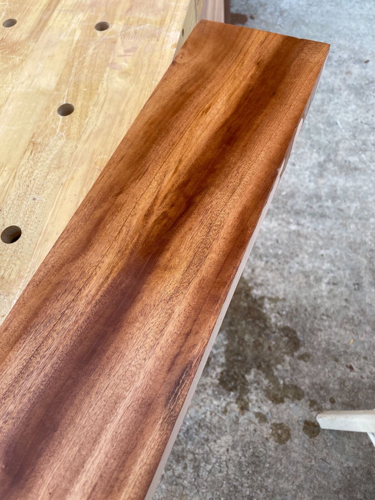

69D0F76B-2727-4F29-A40F-E823172937AE.jpeg.4db7f3cba613f4e683c6f8b8effb4f2f.jpegFinally got the final coat on today. I will problem smooth out with 0000 Sunday.
Looks good! :TwoThumbsUp:
