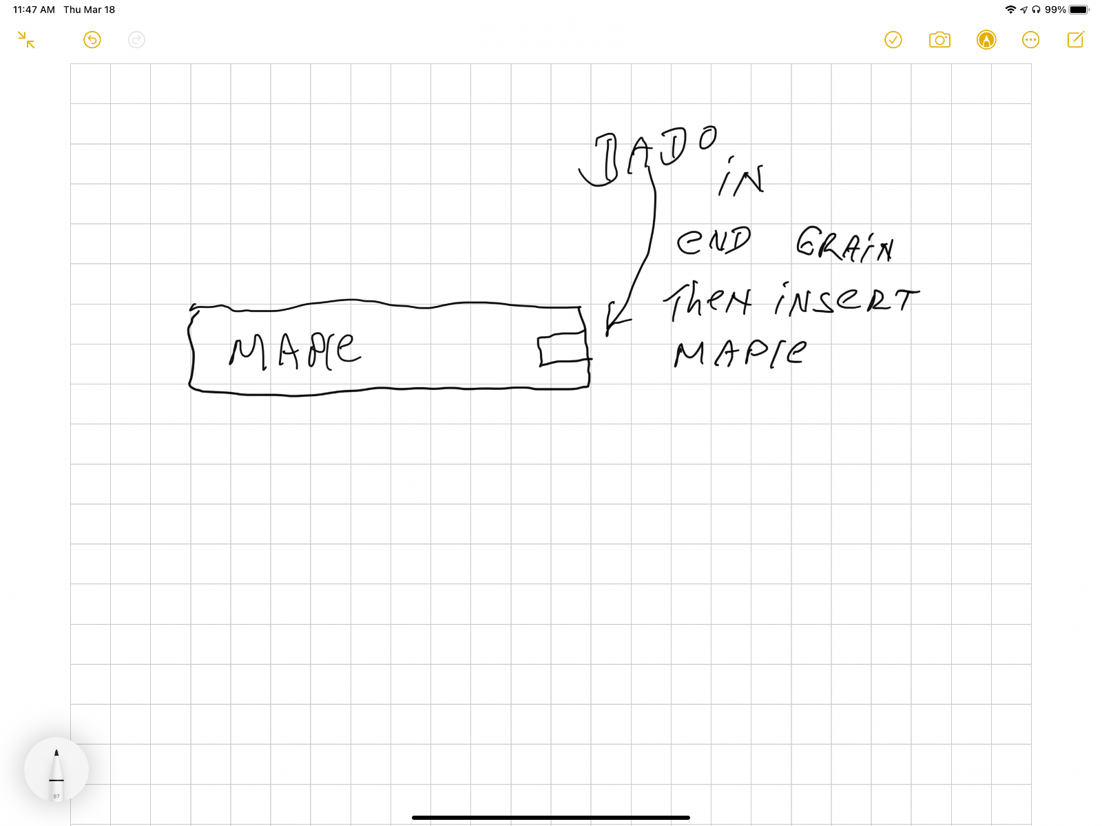

I “think” I know what you mean about the dado in the end grain.  Would I just insert the piece of maple flush with the end grain...?
I think this is what you mean. (sorry, my hand shakes a little so the drawing isn’t very good.)
This is hard maple, I don’t think I mentioned that.
Edited by Pauley
Yes that’s the technique I prefer.
Paul
Paul
Awesome.  When I put the maple into the dado, the side gain out...?  Correct?
Do not glue side grain strip into end grain. You can glue the middle or pin the back .
Thanks Gerald.  Once I do that, I’m going to wrap walnut around the maple top.
