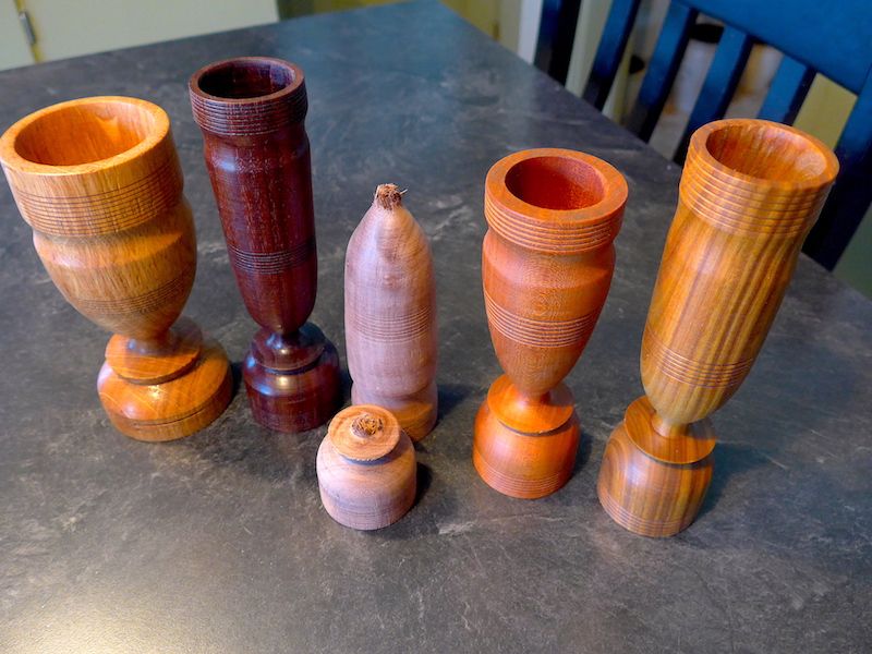

I've turned Lignum a few times and it will quickly dull any gouge..... hard as he**. Go slow and you should be fine. I didn't try a carbide tip so I can't speak for that. The one on the right is Lignum(Guaiacum)811653234_L1080268copy2.JPG.ab514baf320d0143dc5b25119faa2827.JPG
Edited by FrederickH
photo added
