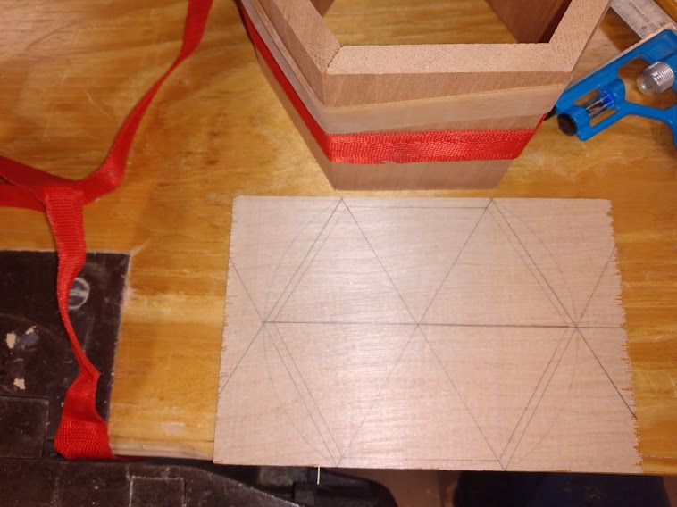

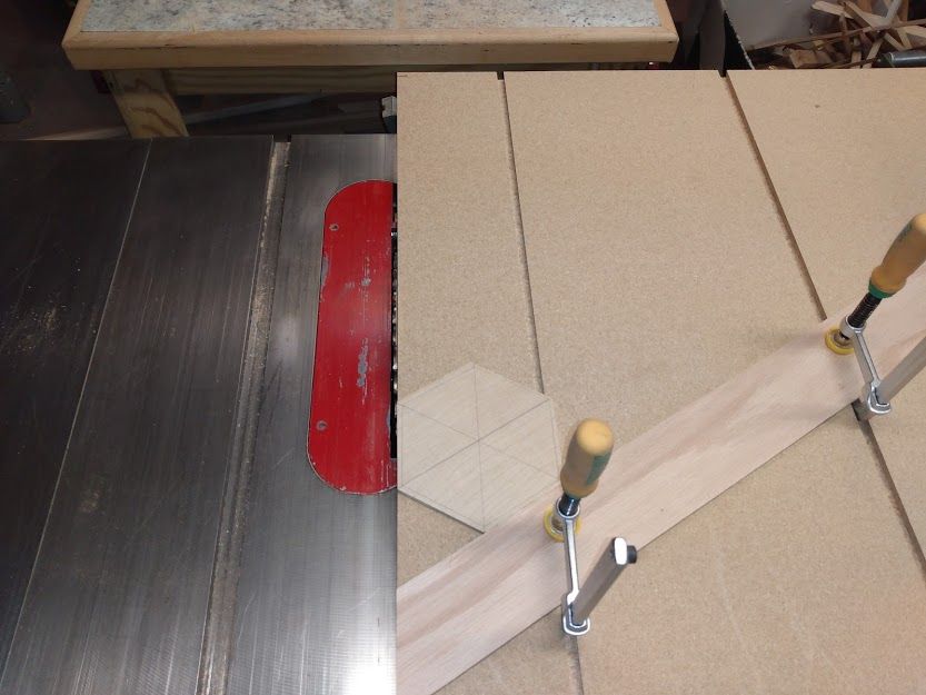

February 25, 20215 yr Popular Post comment_259022 Found a piece of mahogany about 2" x 4" x 30" in my wood storage and decided to make some hexagonal boxes. I read about these again recently in a vintage FWW article by Jim Cummings and I have a (VCR) video of the same era on the same. So I re-sawed the wood about 7/16 thick and beveled the edges. Then cut each strip into 6 pieces, avoiding a giant knot. Five on one side of the knot and the sixth on the other. Then to make a plywood bottom. I channeled my Jr. High math class to use compass and straight edge to map it out. Then cut dados that are 3/16" deep and 5mm wide with a 1/8" blade. Laid out the inserts for the bottom and cut on my recent adjustable angle sliding cutoff table. Tomorrow, I'll be sanding the inside surfaces and doing the glue up. Haven't decided on a lid, if any, yet. Edited February 25, 20215 yr by kmealy Report

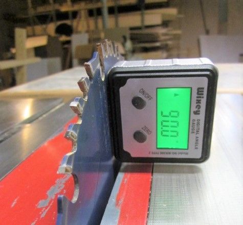

February 26, 20215 yr Author Popular Post comment_259039 I got a digital angle gauge for Xmas. Put it on the table top, zero it out, then on the saw blade. Measures in 0.1 degrees. Just to be sure, I ran a sample with some scrap 2x4. Report
