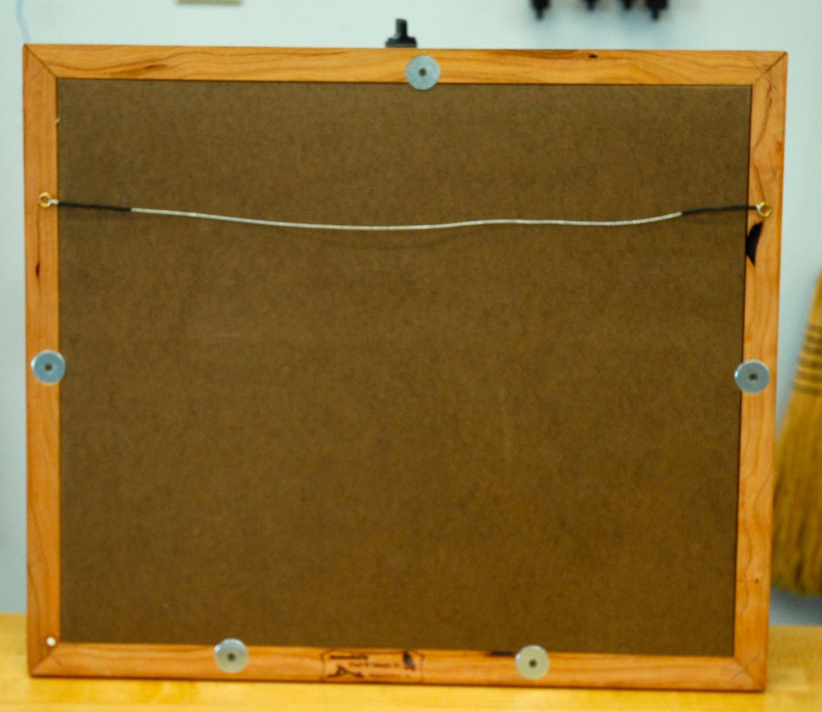

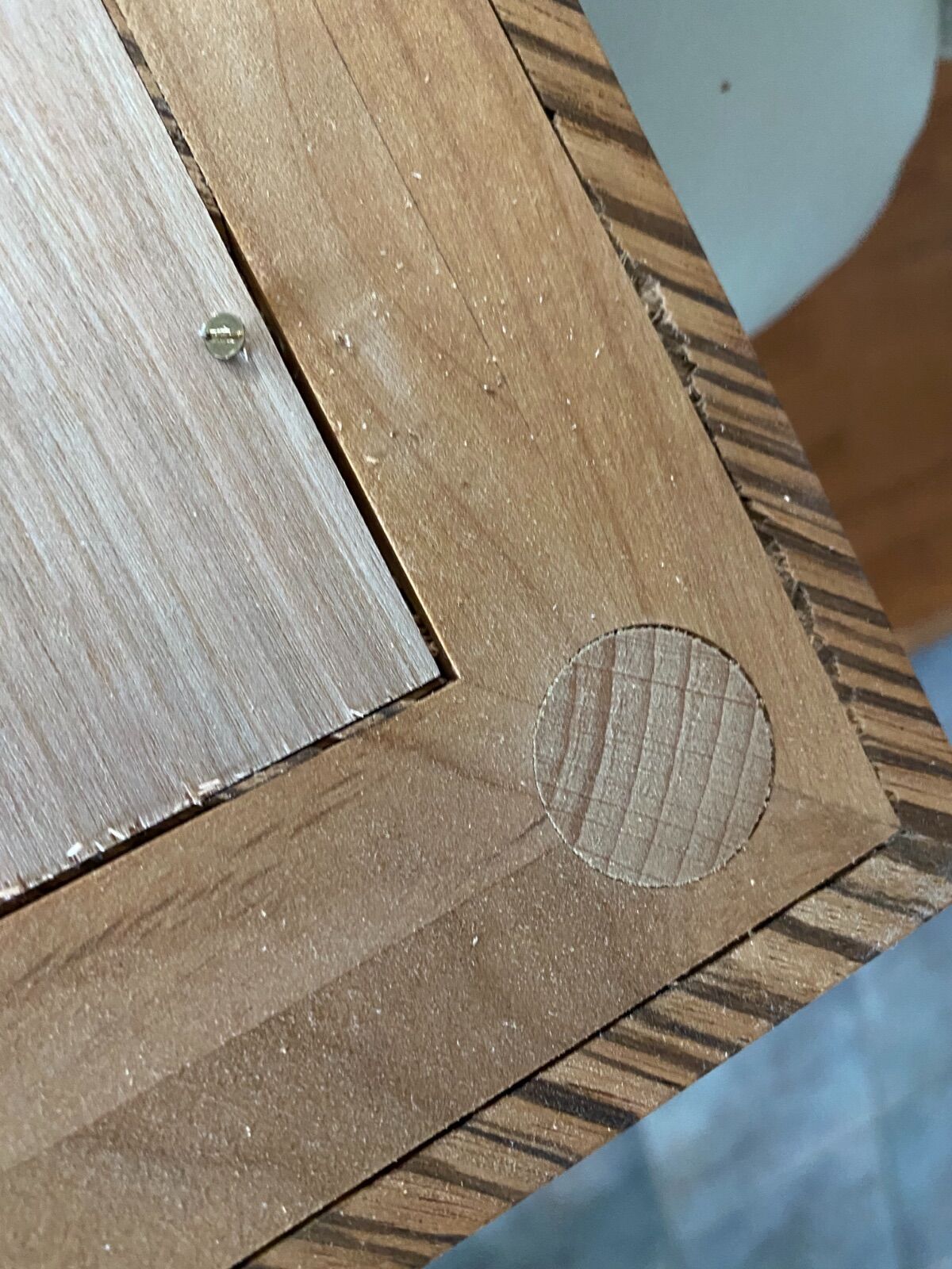

February 12, 20215 yr Popular Post comment_257847 I've just finished a couple more frames, and held the pics/glass in with a better method than I used before. I've been backing my pictures with 1/8" hardboard and dong a sort of toe nail with a pinner to hold them in. This looks half arse, but worse it makes getting things out after the fact a lot harder. So I'm doing this now. I'm pretty sure I didn't think of it, it was probably a tip I saw somewhere in the past and then remembered it when I saw the fenders washers in my hardware box. Anyway, it just a fender washer (these are 7/8" with a 5/32" hole) and a 3/8" screw. I used a forstner bit to cut a relief in the back of the frame to contain the washer. It overlaps probably 3/16" onto the hardboard backing. This allows easy access should I need to get it apart for some reason. Anyway, though I'd mention it in case it's of use to anyone else. Sorry, I just noticed how fuzzy the pic is...but you get the idea.) Edited February 12, 20215 yr by Fred W. Hargis Jr Report
February 12, 20215 yr Popular Post comment_257852 That's a sweet idea and a lot cheaper than those specialized framing point staplers. Report
February 12, 20215 yr Popular Post comment_257853 That works great. Another option is to grind off part of the washer so all you have to do is loosen the screw a bit and rotate it around. I have some metal thingies that work similarly. For the life of me, I cannot remember when or how i got them. They are much thinner than the z-clips for table tops. But similar in shape. The difference between a trick and a technique is that a technique is simply a trick used more than once. Edited February 12, 20215 yr by kmealy Report

February 12, 20215 yr comment_257858 Thanks, Fred. Brilliant idea and I will incorporate it modified as per Keith. Thank you to both of you. Report

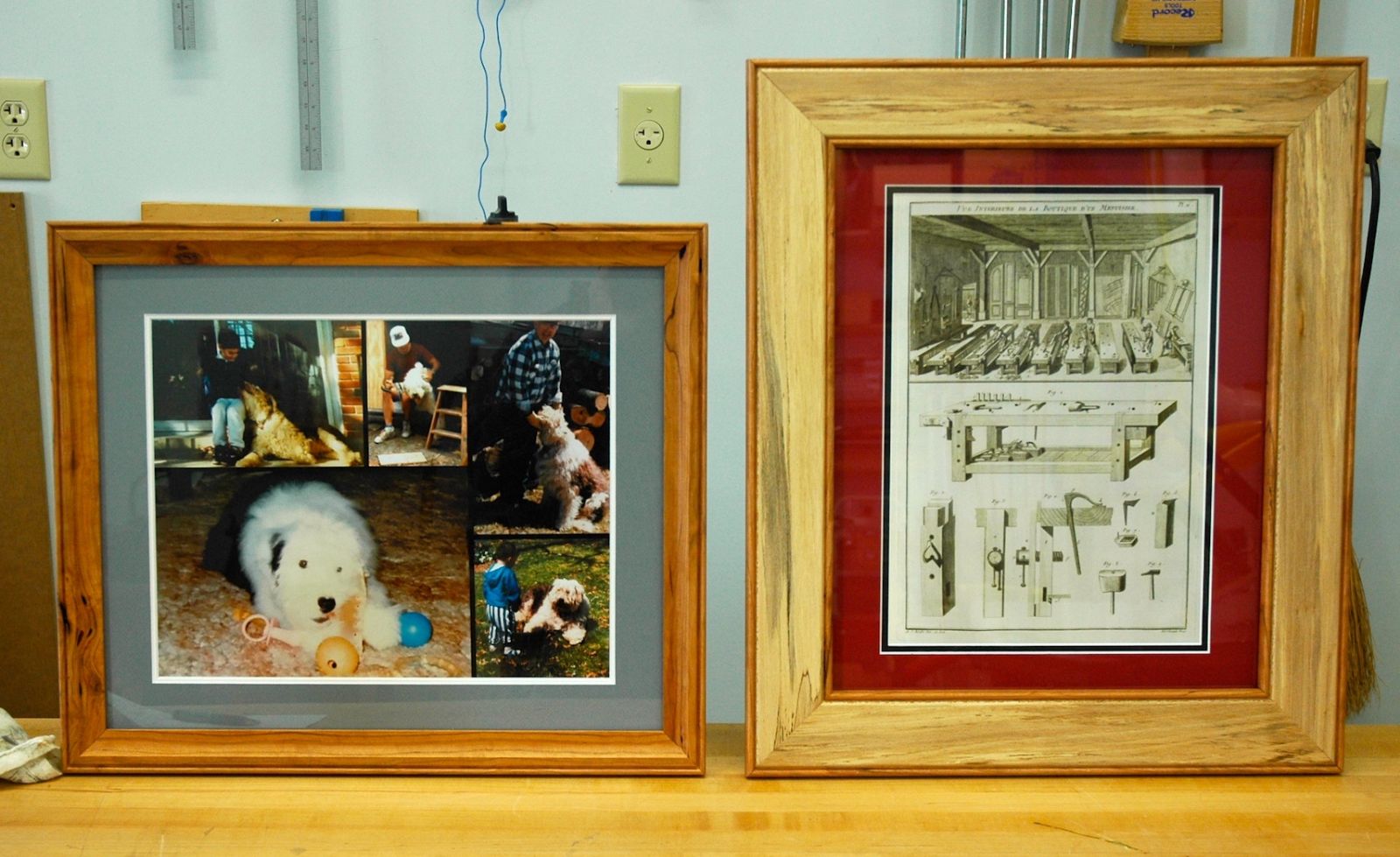

February 13, 20215 yr Author Popular Post comment_257897 I meant to post pics of the 2 frames I had just built with the above and didn't. Here they are. The on on the left is a collage of a dog we had 30+ years ago, Marie had it made as a Christmas gift. The other is that print that Keith had posted a few weeks back and generously shared the source. I had it printed and made the frame. I don't care for the wood I used, it was more of an experiment. The light streaky wood is actually spalted elm, I had bout 60 bd. ft. or so at my supplier for $1/bd ft., then couldn't figure out what to do with it. I made this frame thinking the wood had an aged look that might go well with the print. So even though I'm not crazy about it, Marie thought it was great...so I guess I won't remake it. Anyway, one thing that did happen was with the finish. It's varnish, but I didn't have any satin in my stash...so I got to try a new-to-me product. I went to SW and bought a can of Min-wax Fast Dry Varnish. This is an alkyd resin/linseed oil (I think) formula. At first I thought it was the old SW fast dry with a new label. Now I'm not so sure. It's a wonderful product, something I've never said about anything with a Min-Wax label. But I don't think it's as dark as the old SW product, it's actually very light much like the soya oil varnish I usually use. Anyway, if any of you need an oil based finish for something I recommend giving this a try. Edited February 13, 20215 yr by Fred W. Hargis Jr Report

February 14, 20215 yr Popular Post comment_258008 Another method you could try is small brass wood screws. Easy to remove later but secure and they don’t hold the frame away from the wall. Paul Report
