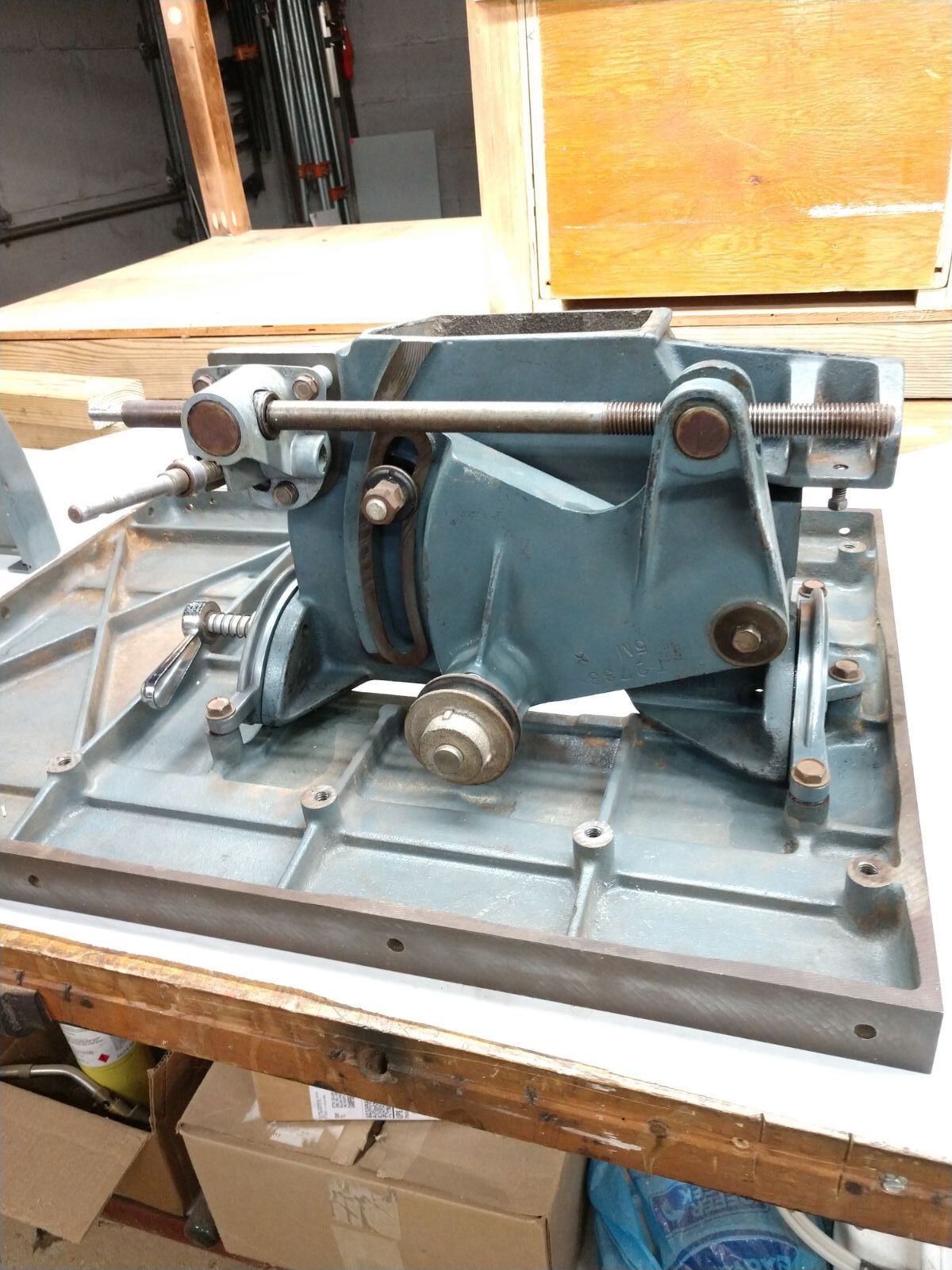

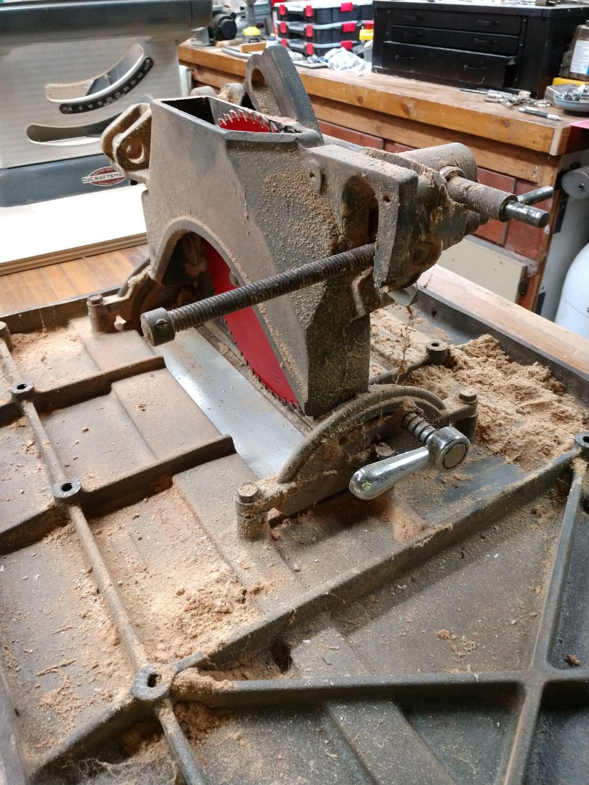

Started cleaning up my table saw. Body style has many shelves & pockets for saw dust to accumulate, blew it out & turned it over and the dust was still falling out.
Why didn't I remove the blade, I don't know, but it was a lot harder to remove this way:BangingHead:
Without the motor this is a heavy beast.
Cleaned out all the old grease & crud from the threads. Moving parts are still snug and moving freely. I had changed the arbor 15+ years ago and the bearings are tight & roll free.
Broke it down as far as I feel comfortable. Didn't mess with any pivot points, they are tight and move easily.
I'm open to any suggestions for lubrications on the moving parts. Last time it was apart I greased all the screws & pivot points.

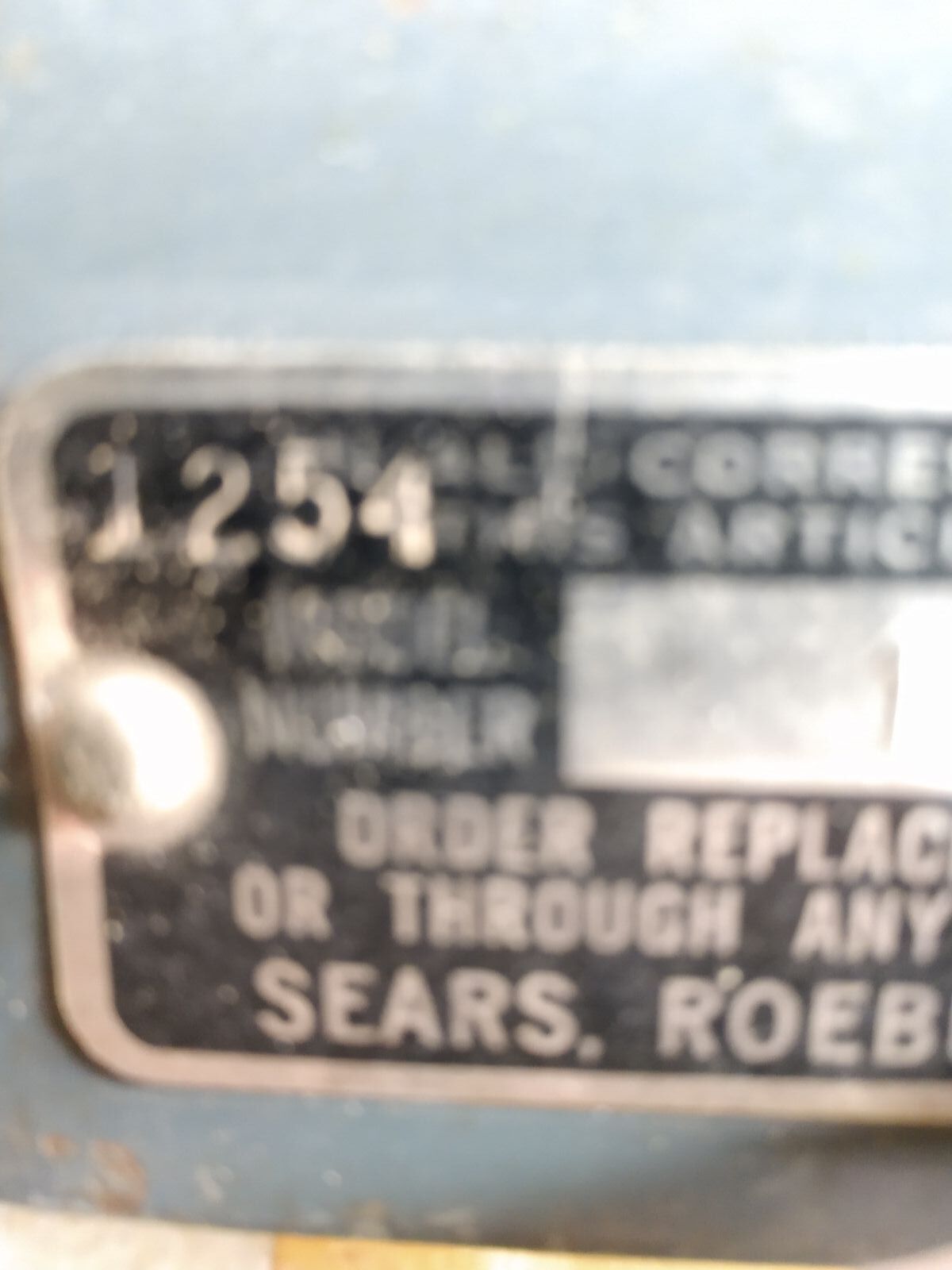

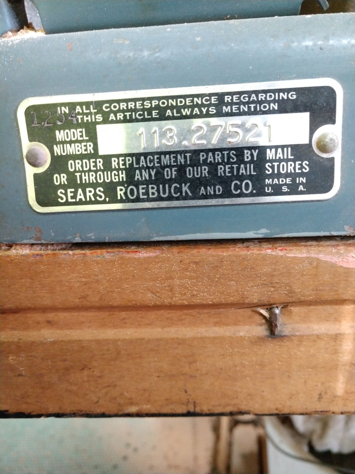

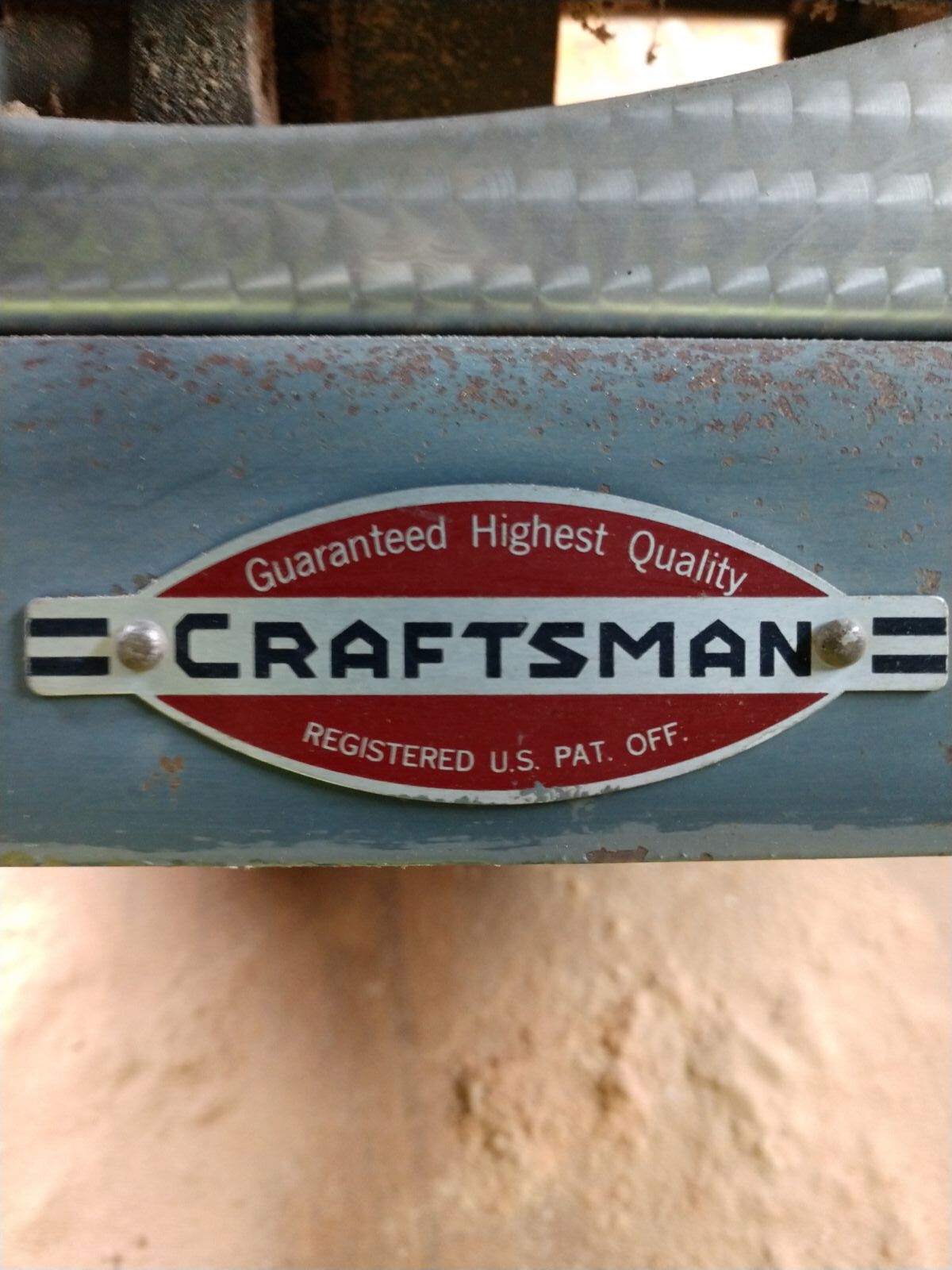

Name badge & model #113.27521. Left corner of the model tag # 1254 & my research shows this to be a manufacture date.

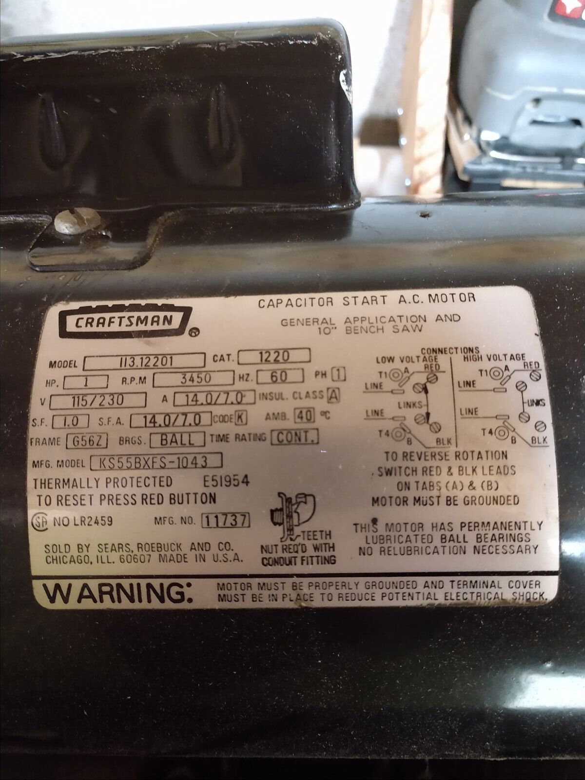

The motor tag is correct for the saw but I'm not quite sure of the year. There is a number, E51954, to the right of Thermally Protected. I would be surprised if the motor was original to the saw. Any help with the year of the motor is appreciated.

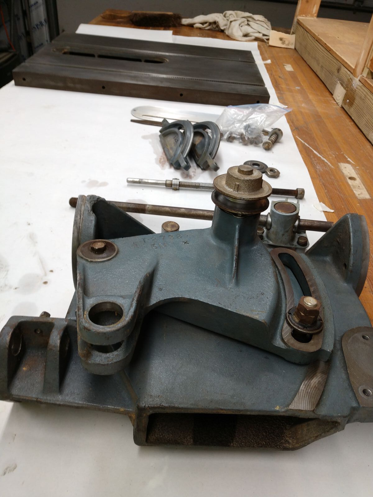

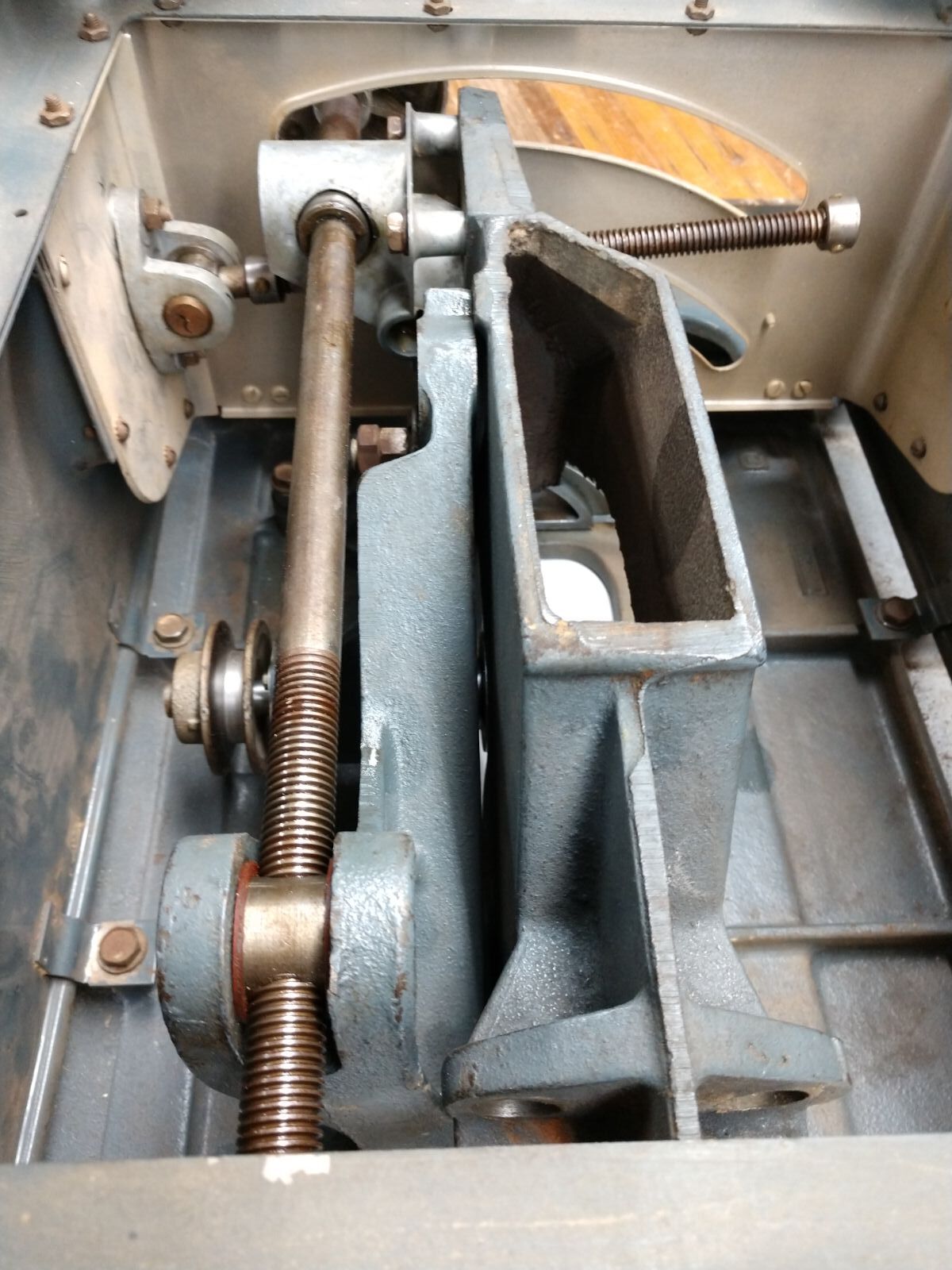

I did get the saw back together, thanks camera phone.
Blade is at 90 degrees and parallel, within 2/1000, to the miter slots. It wasn't the easiest thing to do, kind of like balancing a tire with water in it.

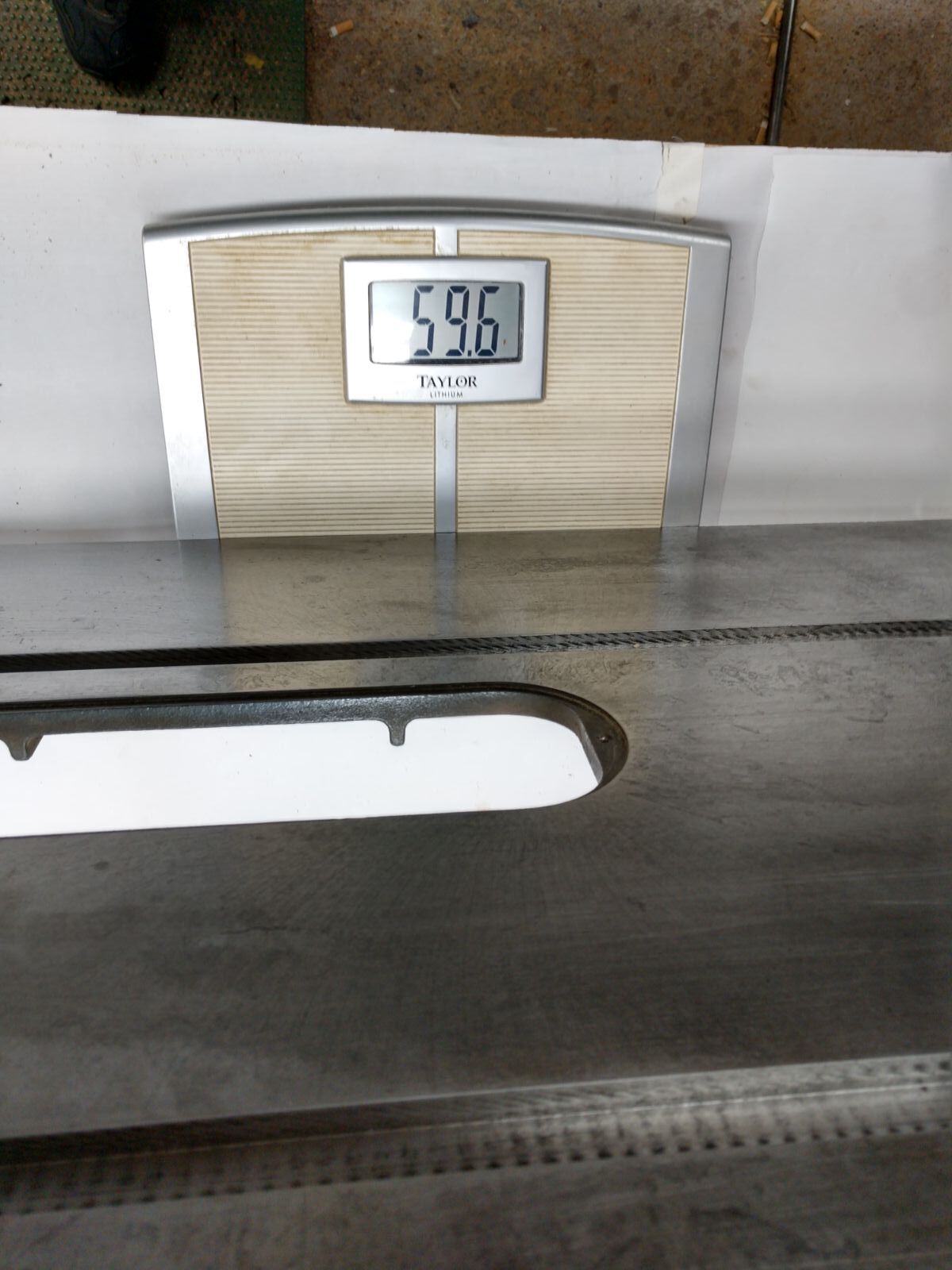

My curiosity got the better of me and I hauled the bath scale to the shop to weigh just the table top.
