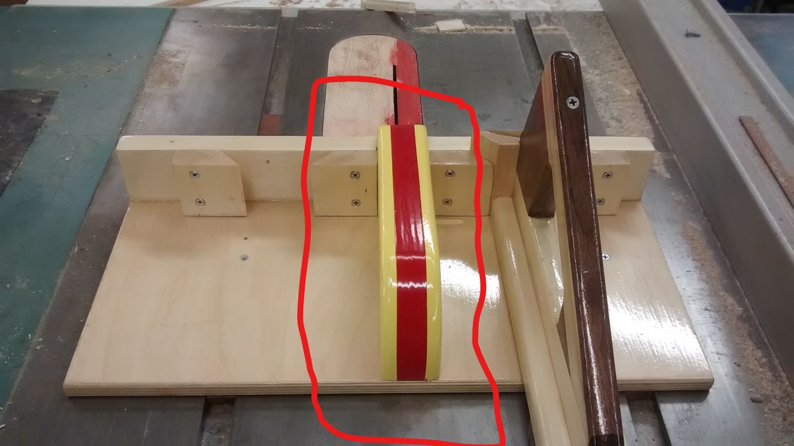

For years I've read that a crosscut sled is a necessity in the shop, yet I never felt inclined to make one. (let me mention I have a panel sled to square up panels.)But while putzing with tissue box covers I wasn't happy handling such small pieces on the saw. Then I came across a smaller sled in a magazine (Woodcraft, maybe) that I though would be useful for smaller pieces. This is my version. Let me mention again, I'm very much function over form, so I don't dress such things up to look nice. I just want them to perform as they should. Anyway, what's different about this sled from others I've seen is that it's a single runner sled. That allows you to move from one miter slot to the other. The idea is that (on my saw) when it's in the left slot, you cut 90º more or less in the middle of the sled. When it's in the right slot, you can tilt the blade to 45º and cut miters for mitered corner boxes. Because you only have one runner I bought a metal one that adjusts for tightness and not worry about wear on it. Anyway, here's what I came up with: The pics show it in the left slot and the right slot. So far this looks handy for smaller pieces, it's only 14" between the fences and I kinda wished I had made it a little smaller. But it's 25" wide and that seems to be about right.

Aren't they wonderful?  I have a suggestion.  On the 2 X where you place your hands to push and pull, I would put a big block of wood for the sawblade to bury in.  I would rather it cut the block of wood than one of my thumbs.  I found it to be beneficial one day after using it.  I had not realized that I would have my thumb right where the saw blade comes whirring through.  So thankful for that block.  Does this make sense to anyone?
Yes, I took that and went a bit farther but keep in mind I am crippled with right hand so just pushing the jig as you guys do is difficult.  Thus a handle that can be used both sides to aid in cutting.
I have two 1x4s serving this purpose.   I'd recommend it.

Well, back in the shop I went ahead and added a cover around the blade exit spot on the back as Steve suggested. Rather than screw some pieces of solid wood, I just used a few scrap pieces and built a box that sticks back another 2" or so.
I have seen that done on others builds as well. With my method of holding to one side it is less of issue. Others may have various issues.  My son finds the angle of my push sticks uncomfortable.:D
I did that on mine, too. Also added a sled stop so that I couldn't accidently push the sled too far a cut thru the wood block.
