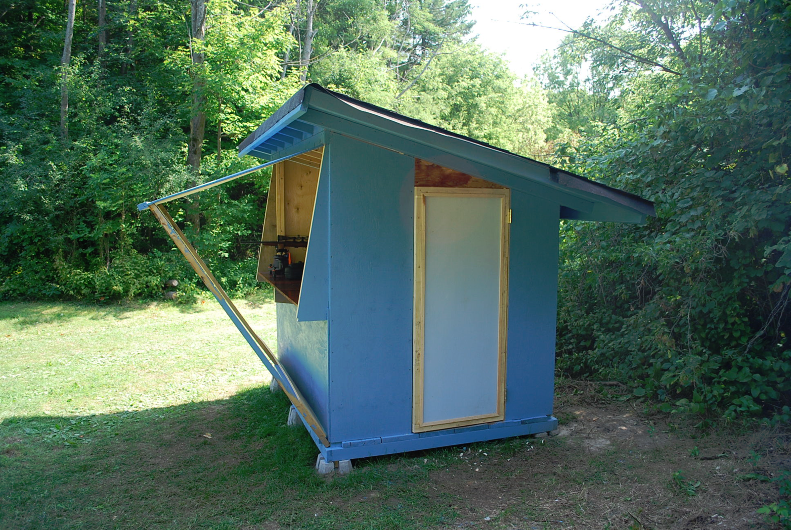

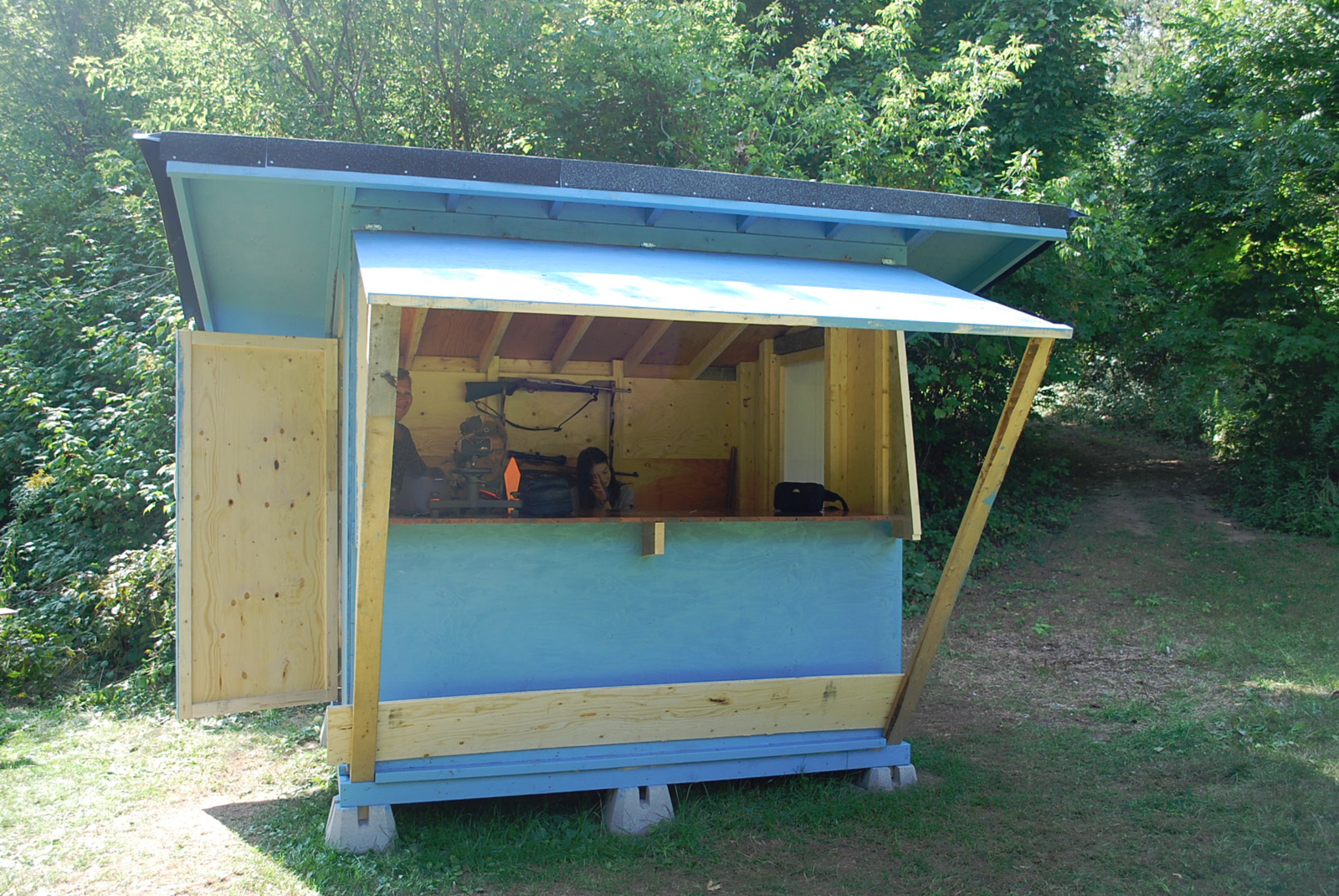

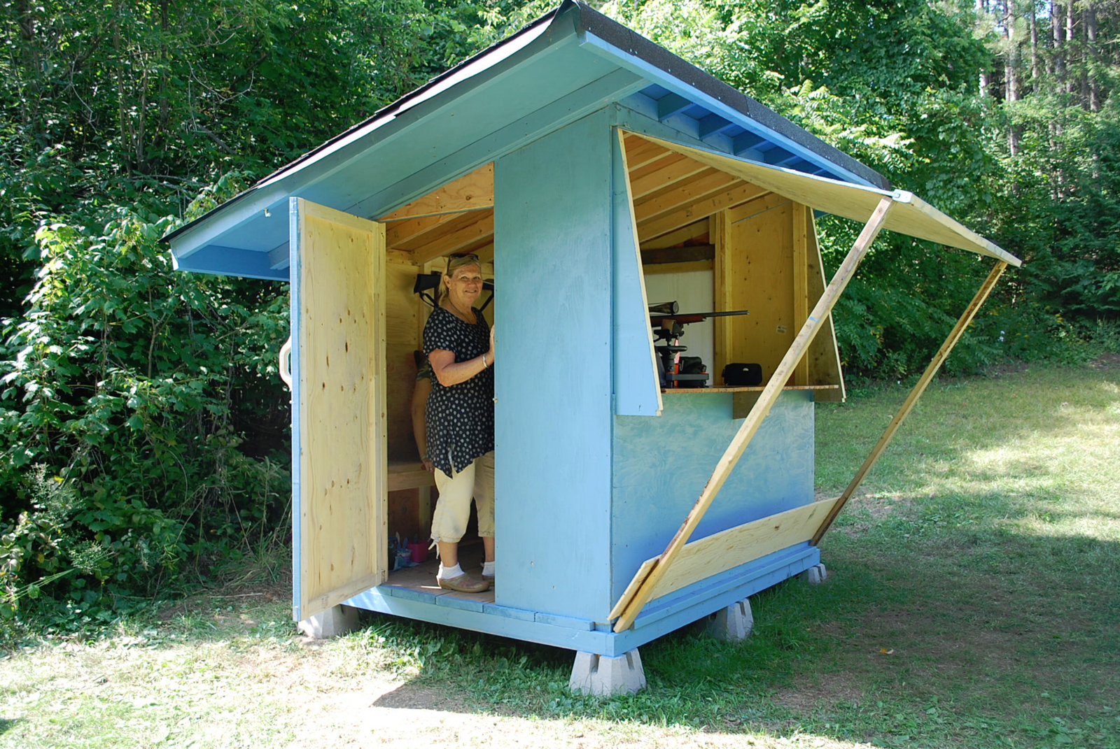

September 7, 20206 yr Author Popular Post comment_241620 Long day today, but it's pretty near finished. He had the kids paint it (not my choice of colour) during the week, but I put on the last few pieces of plywood today. The front open, ready for use. The front supports are temporary, stilllooking for a better solution. This door locks from the outside, ... while this one lock from the inside only. The panel is greenhouse lexan, to let in some light. The gun rack was donated by a friend (they're no longer legal, since all firearms have to be locked up) and is holding my grand-daughter's 10-22. She's an avid shooter, while her brother has not the slightest interest in the sport. And here it is, closed down for the night. The edges of the shingles still need to be trimmed, and one of these nights I'll sneak over there and do the whole thing in camo, which was MY preference in the first place! John Report

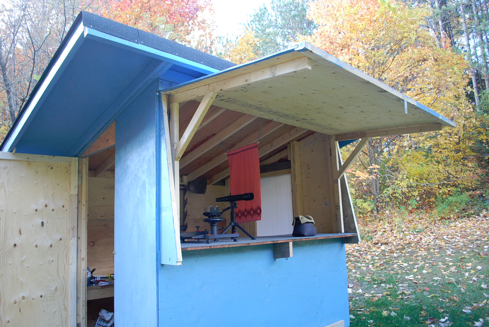

September 7, 20206 yr Popular Post comment_241635 I love it, and the camo paint idea is great. What about just putting some legs that are hinged on the flap, then when you open it you swing them into position to support it? Report
September 8, 20206 yr Author Popular Post comment_241742 On 9/7/2020 at 7:03 AM, Fred W. Hargis Jr said: What about just putting some legs that are hinged on the flap, then when you open it you swing them into position to support it? I was thinking about that, but when I did some calculating, the numbers just didn't add up! The legs would have to be almost 6' long, and would block entrance to the shed when closed. Thinking of two welded upside-down "L" brackets that rotate outward from the sides. That way the arms stay up near the ceiling and against the front of the shed. FWIW, this is the view from the bench. The paper targets are about 85 yards away, while the four "T" structures have assorted yard-sales pots and pans hanging from them, as well as nails through the tops that hold various items such as old fruit or small plastic or metal containers. The flap will be higher, and the arms will, of course, be gone. You can't see it, but there is a big mound of dirt behind the paper targets to stop the bullets. John Edited September 8, 20206 yr by HARO50 Report
September 9, 20206 yr comment_241805 What about placing a 1x across just below the window. Cut the supports shorter and they will go onto that 1x and since you would hinge them on the popup they fold under it when it is closed. Report
December 3, 20205 yr Author Popular Post comment_249822 Got kinda busy and forgot about this thread! I made these two supports and hinged them to the sides, so that they swing inward to close the window. Works like a charm! John Report
