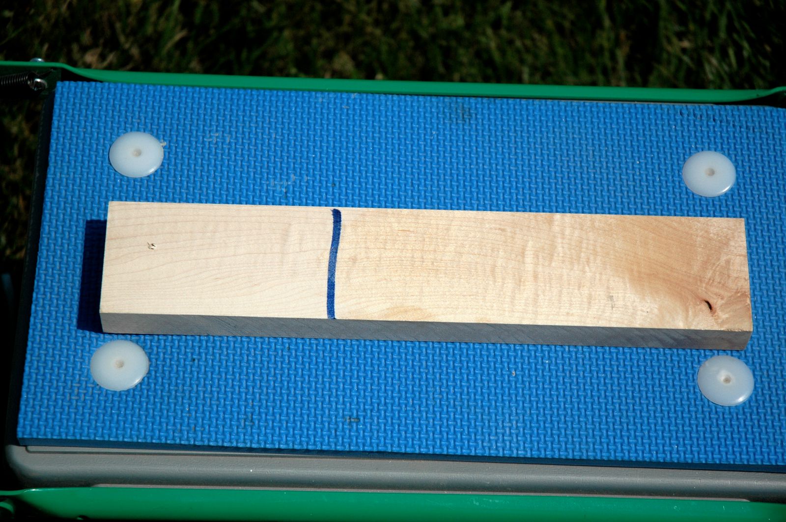

Your approach wetting the wood is the correct one. Like they said above, the waterborne finishes may be your best bet, though be sure to check the label. Some of them are tinted to mimic an oil based finish and you won't want that. The other thing is they will raise the grain. Not a problem, after the first coat, smooth the wood and then your done with it. But a big warning about what was mentioned above, the wood itself will change over time....there's actually nothing you can do that will keep it as it is now.One otehr thign, there is a shellac called "platinum blonde" that is very close to being clear...and shellac is light-fast (doesn't change over time). Here's a pic of some I put on a hard maple test piece. The right side has the shellac on it.
How long ago was the test piece done, Fred?
It's a guess, but I'm thinking I did that 6-7 years ago when someone else asked the same question (clear finish). I can't find the date on the file, it's a little harder to do with a Mac. I'm also sure I still have that piece, but I can't find it at the moment. I keep looking later today and see if I can give you an updated pic.

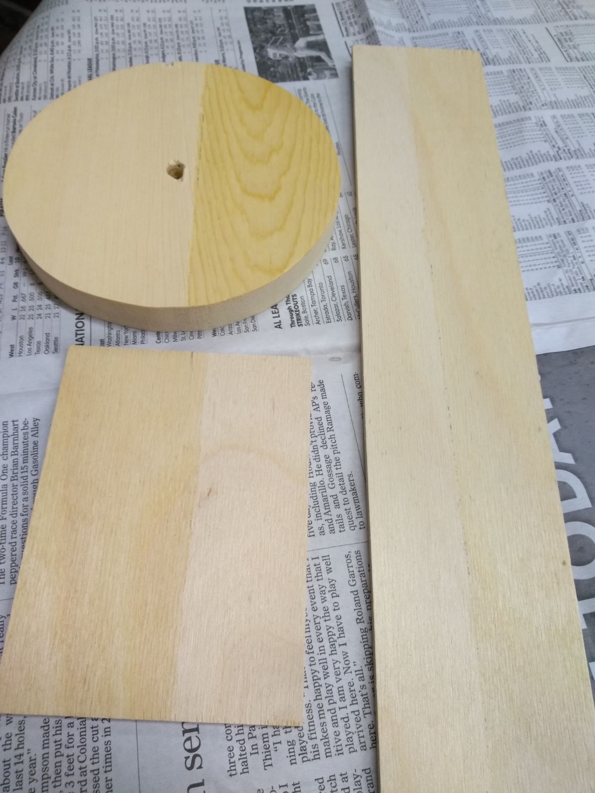

This is lacquer over white pine or spruce and the other two are Baltic Birch which is whiter than most woods..
I also think this is actually the color of these two woods right when a person cuts a tree down...And the sanded versions are not the actual colors.IMG_20201205_112016756.jpg.72f764b2aaf1431cf265b12aabc5f5c0.jpg

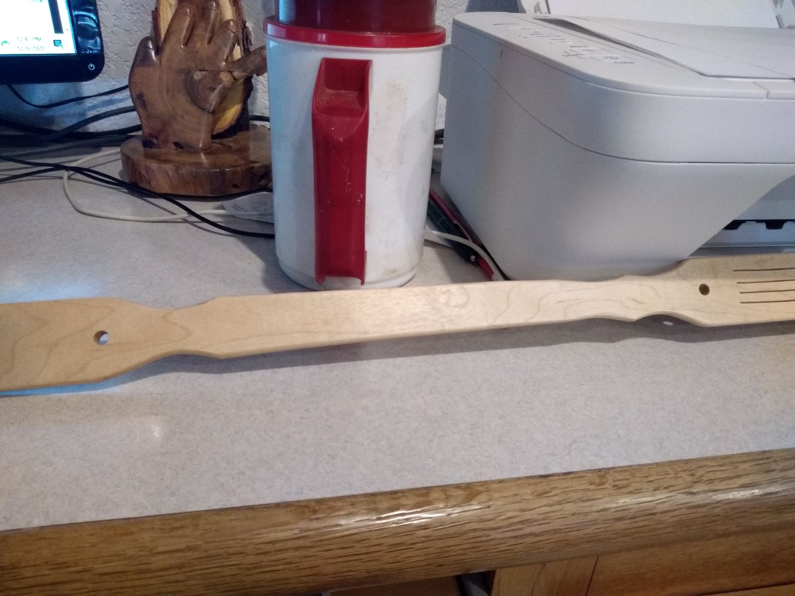

 I have used lacquer all my adult life and every thing in the house is under lacquer and can't see any yellowing using any other varieties of wood.
 These were sprayed this morning.. and this back scratcher was sprayed a month or so ago using lacquer.. I think if someone wants a very light color after lacquer goes is to use the lightest colored maple they can find to start with..
