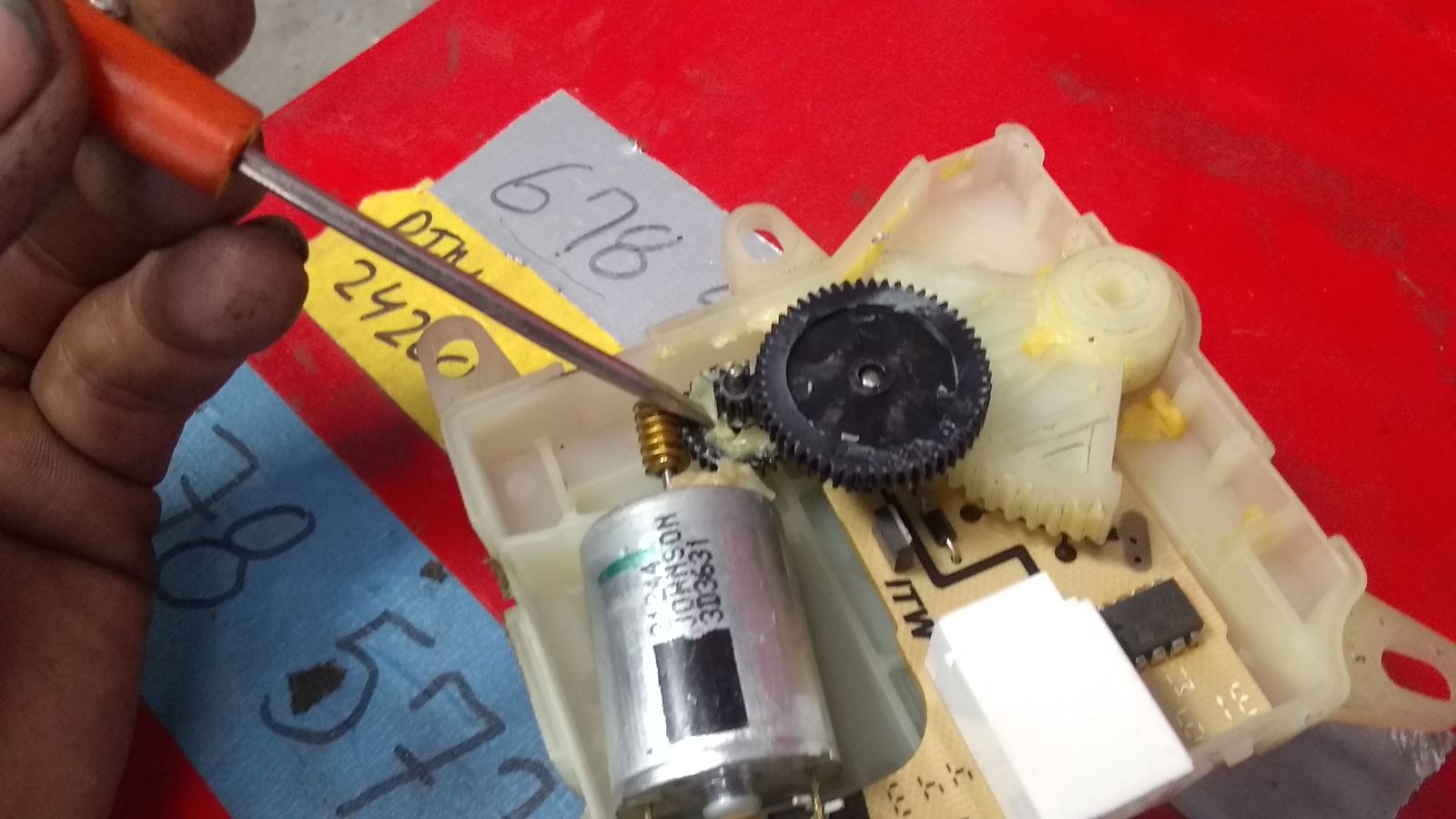

October 24, 20206 yr Popular Post comment_246241 Modern vehicles use actuator motors to adjust temperature and blend door operations. Works okay but the gears are plastic. See picture. Those gears are not serviceable, as in cannot be purchased except as unit. For $125. But when it's the bosses car it's okay you canniablize another unit to make one good. Fun stuff putting this in. Small hands and patience. Or pull the dash out. Report
October 24, 20206 yr comment_246247 Well, Gunny, do you recommend to trade off the vehicle or just break out the wallet and go through the repairs? My Toyota has these doors that open and close all over the van. I can hear them shut after turning off the engine. And, I think the ones for the heater are failing. We had a couple of cool mornings so I turned on the heat for the grandchildren, but I got only cold air. So, I just turned the thing off. It is total climate control. Report
October 24, 20206 yr Popular Post comment_246248 8 minutes ago, FlGatorwood said: Well, Gunny, do you recommend to trade off the vehicle or just break out the wallet and go through the repairs? My Toyota has these doors that open and close all over the van. I can hear them shut after turning off the engine. And, I think the ones for the heater are failing. We had a couple of cool mornings so I turned on the heat for the grandchildren, but I got only cold air. So, I just turned the thing off. It is total climate control. Toyota's are slightly easier to do HVAC blend door actuators. But tend to be expensive. I take stuff apart all the time to show my apprentice how things work. Visual hands on learning. But never have seen a listing for the little gears or a motor. So you pay for the whole thing. It is also possible rear heater core is plugged up. Here I would check that then give estimate. No guessing. For me fixing is better than a car payment. Of course I don't pay for labor either. Report

October 25, 20206 yr Popular Post comment_246268 2 hours ago, FlGatorwood said: so someone else will have to do the labor. Thank you for the information. Glad to help, probably answer about 10-15 questions a week from various people. Sometimes easy stuff for me, other times I have to consult a wiring diagram or flow chart. If we were closer I'd drop by, check it out and get it fixed for ya. Report

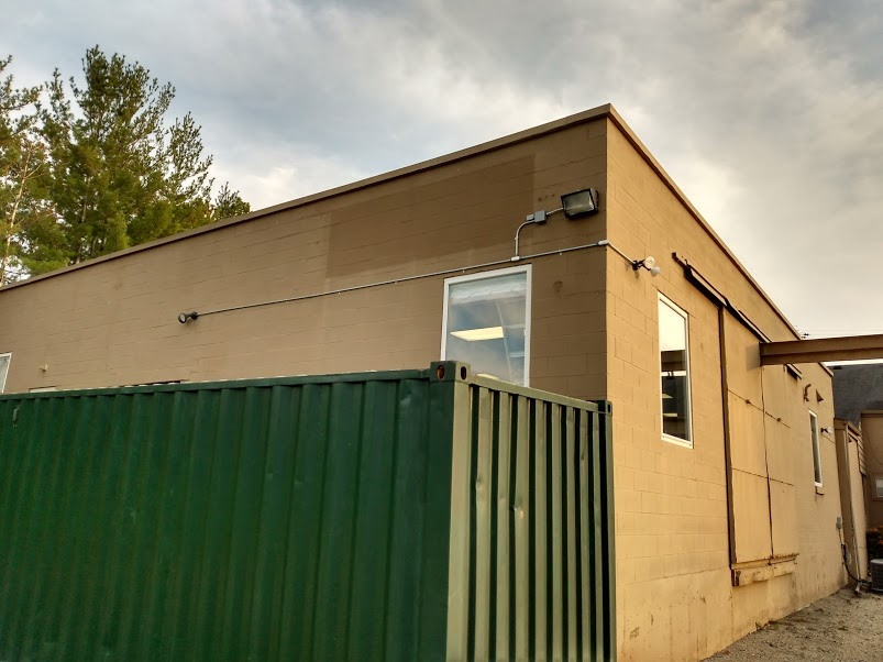

October 25, 20206 yr comment_246272 Spent the day pulling out old wiring, moving boxes and rewiring outdoor floodlights for the youth theatre company building. Trying desperately to light areas needing lit without having to go buy more green THHN. Found out why the old lighting was not working, there was a 2' section of wire above the area with the I-beam sticking out without any insulation at all. Report
