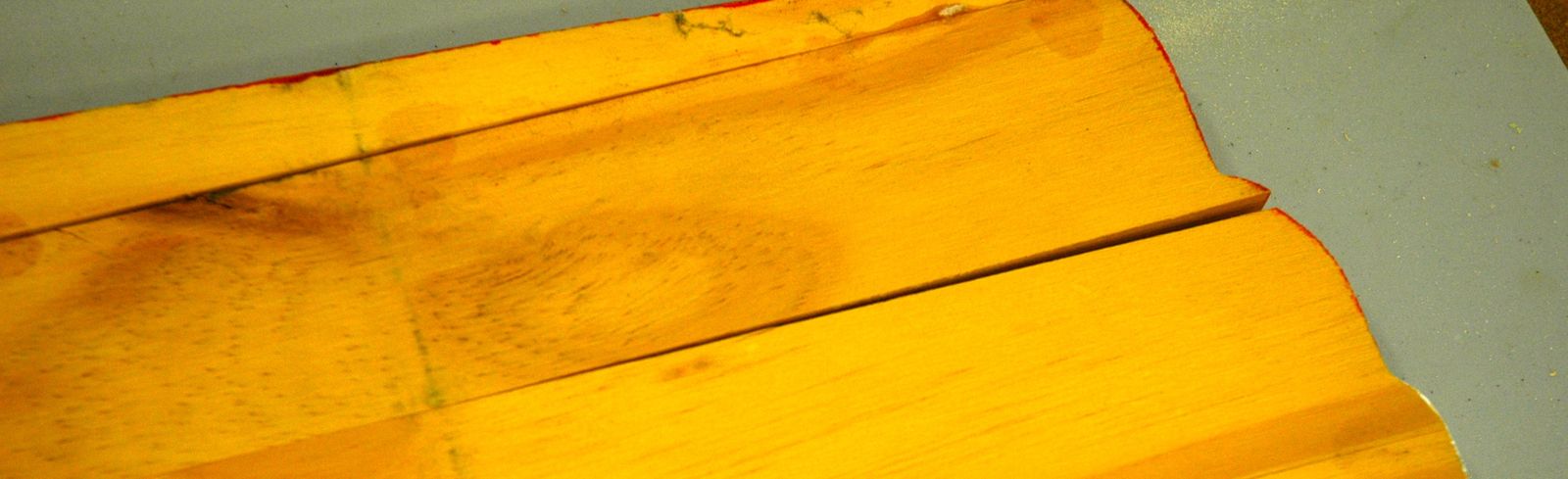

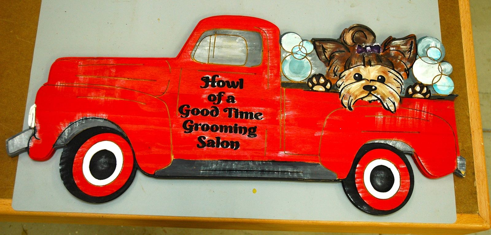

October 23, 20205 yr comment_246138 I'm trying to help out a friend who is also our dog groomer. The quick recap is that she opened her own place after the June startup from Covid, and had this sign made by a local who has a CNC. Nothing about this sign is suiable for the outdoors, though she indicated that would be it's use. Anyway, fast forward to now and the sign has already broke in 2 places and has a serious crack in another 2 places, we're addressing the most serious rack. The sign seems to have been made from a box store pine panel, so the 2 previous breaks were right at the glue seam. Missy's boyfriend "fixed" one using epoxy to re glue the seam. I fixed the second one with biscuits. The edges of the break were covered with whatever glue was used and I couldn't clean it off without (I feared) impacting the sign itself. So I cut it for 4-#0 biscuits and used plastic resin glue to rejoin it, that repair looks solid this morning after I took the clamps off. The reason for biscuits was to get some kind of loose tenon to span the joint, plus I only have 1/2" of wood to work with. The blank was actually about 5/8" thick, but the CNC engraving is just a tad over 1/8" deep and quite profuse across the sign. Now, for the question. I would like to do something to the crack to keep it from getting worse and preventing future failure. I did not think I can safely pull it back together. Anyway I'm considering routing a 1/2" wide groove across the seam, 1/4" deep. Then fill that groove with a douglas fir (that's what i have) piece glued in with plastic resin glue. that glue has good water resistance so should do the job nicely. So, will that work....and other ideas???? After I complete these repairs I told here I wold mount it on a piece of MDO and my plan is to fasten it to the MDO with screws and elongated washers. I'll give that a simple frame and then she can hang it outside. Not part of this, but that paint appears to be fragile, almost like a milk paint I tried using a piece of 3M delicate surface masking tape on it (to mark for the biscuit) and it pulled some off....I had to mark the back side. The pics below are the overall sign (for reference, it's about 29" wide and 13" tall) are the overall sign and closeups of the crack from the front and back side. Report

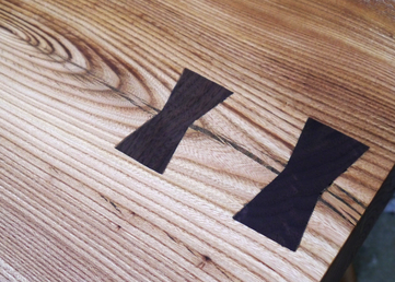

October 23, 20205 yr comment_246150 Pocket screws come to mind first. Bow tie inlays may work too. Report

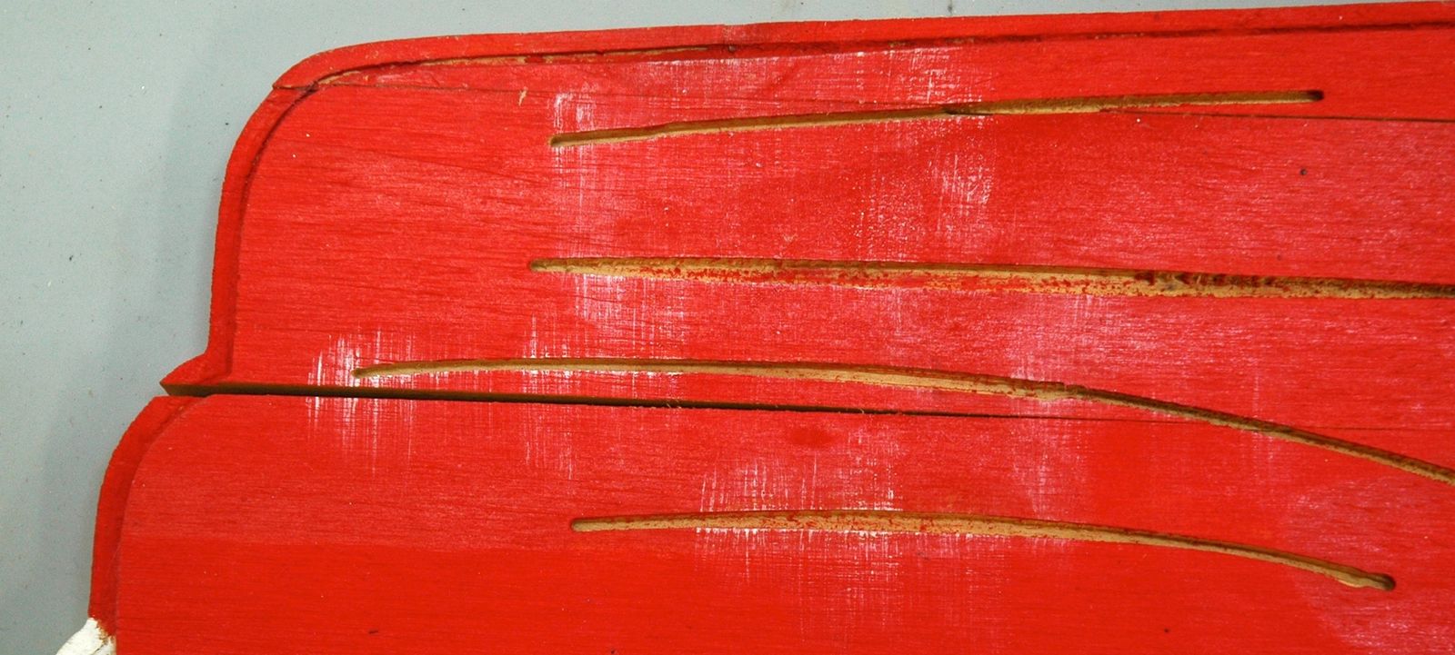

October 23, 20205 yr Author comment_246152 I thought about pocket screws, but given how thin the wood is I'm not sure I could get them to work. However I do have a scrap piece that's the same thickness, I can give that a try this afternoon and see what happens. If that wold work I could put them across all the seams which might be a permanent fix for the whole sign.I also thought about bowties, and that's still an option although that would be a little more involved than my spline trick. I'd have to make the template. Thanks. Edited October 23, 20205 yr by Fred W. Hargis Jr Report

October 23, 20205 yr Popular Post comment_246156 This type sign may last a year in exposed weather so Jess had a good idea to frame and glass or plex over it. Dan's butterfly patches will be much stronger than a biscuit which is only for alignment and not for strength, Report

October 23, 20205 yr Author Popular Post comment_246165 1 hour ago, DAB said: trace the outline of the piece onto some plywood, glue together, fill crack with wood putty, touch up paint. makes no sense to spend $100 of time on a $30 sign. learn her lesson, get better stock, re-make the sign (it's CNC, surely they saved the file, just re-run the cutting program on a better piece again) As I said, I'll be mounting this onto a piece of MDO, but it's a rectangular piece which will be framed I'm afraid to glue it together though, that's why I'll be using screws and elongated washers....that way the sign can move as needed. As I understand it, this is hardly a $30 sign the CNC work was only a part of the cost; the hand painting was a little laborious. On to the biscuit repair I made, the joint is now quite strong. Since the wood was sized by the glue used in the fabrication of the panel and I had no way to clean it off this worked out very well. Anyway, I did try the pocket screws and they seem to do what I want: reinforce the remaining joints in a way that I hope keeps them from separating. Lastly, I don't do this for hire so I'm not worried about how much time I spend on it. I do agree this is not a long term sign, there isn't anything about it that's "outdoor". Report

November 5, 20205 yr Author Popular Post comment_247173 To put a pin in this one, I took the sign back to Missy (our groomer) today. The repairs wound up being what some of you suggested. I used pocket screws on the back to reinforce each glue seam, I managed to cut a sliver (wedge) of wood to fill that gap perfectly (as Scott Phillips would say), and mounted the whole thing on an MDO backboard with allowance for wood movement in the sign. She was quite happy with everything, and she had pre-approved that wedge repair on the gap I pictured above. Anyway, the backboard and frame were primed with an oil based primer, and she gets to finish coat it and touch up the wedge repair. As I said above, it's not a long term sign but should last a little while. It will be hanging under a porch cover and out of most of the direct sunlight so that should help a little. Thanks to all for the suggestions! Report
