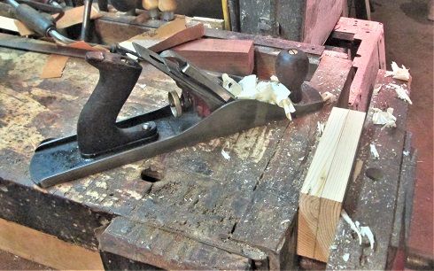

Well, this Craftsman version of that Millers Falls jack plane could do with a new horn...and maybe the correct sized front knob?
He also set that turning square...figure I can chop off a chunk the right length, drill a hole through the center, and turn it down.....except, I don't have a lathe handy...but...I DO have a drill press...I can chuck a bolt through the blank, give it a spin..until a knob takes shape...
As for that Tote blank sitting there...maybe have just the plane for it..
Not only missing the horn, but is is snapped in two...only thing holding it together?  Is the bolt in it...:ArguingSmileys:
Front knob is fine, though.  Stanley No. 5 is about to get a new handle around in back...Still have enough leftovers, I could replace the one on a #4..

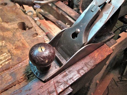

Stanley Type 11 knob...looks a bit rough?:ChinScratch:
You could say that...:ROFL: Will try this one first, as a pattern...work all the kinks out, BEFORE doing the Type 10's replacement..

That Craftsman Jack plane in the background...needed the rear handle fixed, and..
The front handle needed replaced......Tried the drill press, could not keep the "mandrel" in the chuck....had to duck once....took the knob blank to the 6" disc sander...made a BIG mess..
But..
Finally was able to shape a new knob.   Added a chunk to the tote....waited a long while ( mainly while I was sanding the front handle..)
Fun part, was to find the bolt hole, again....so...the "After"?
Like new?   Made by Millers Falls, sold by Sears...Lever cap and the iron are both stamped Craftsman...
