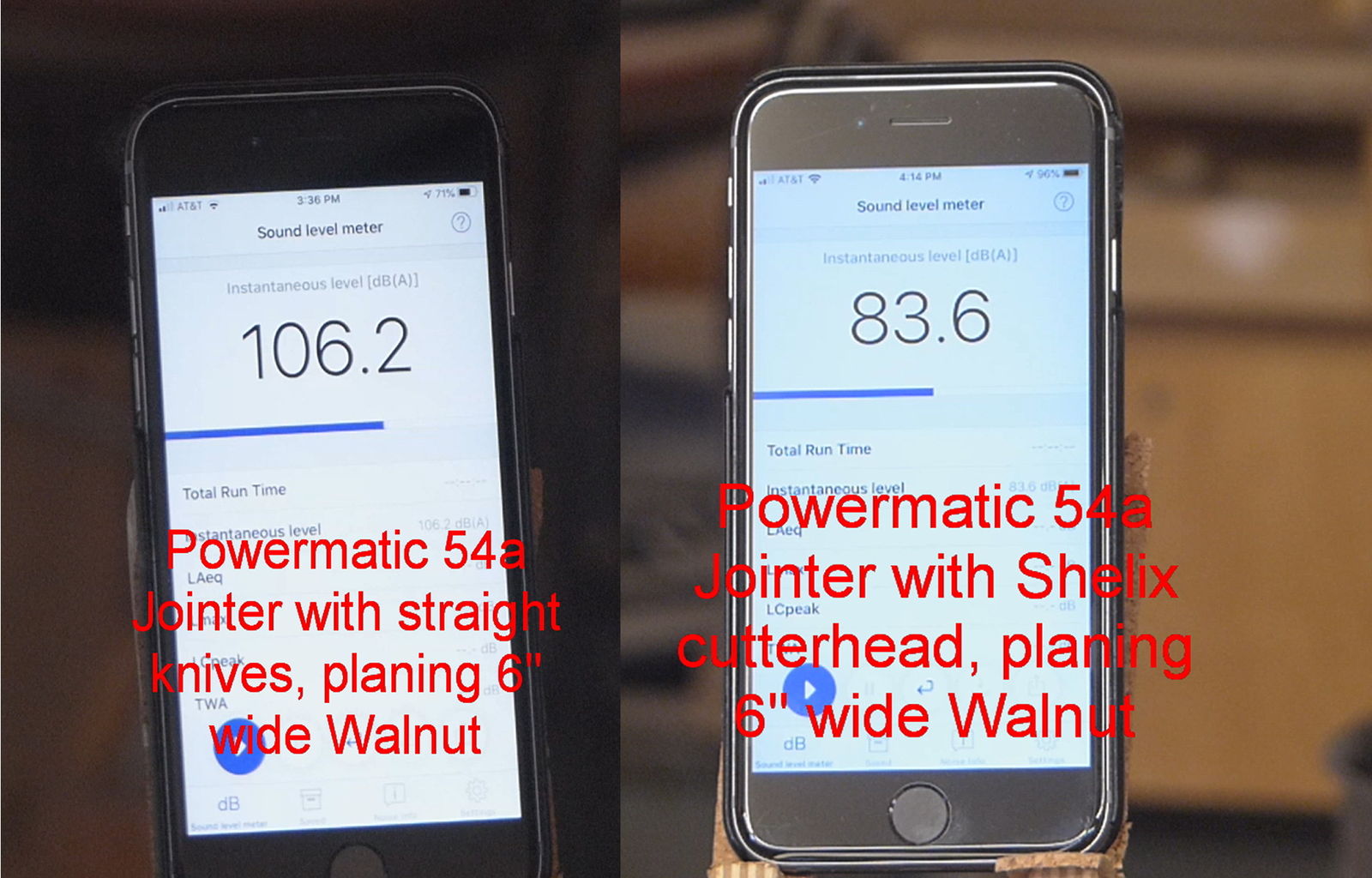

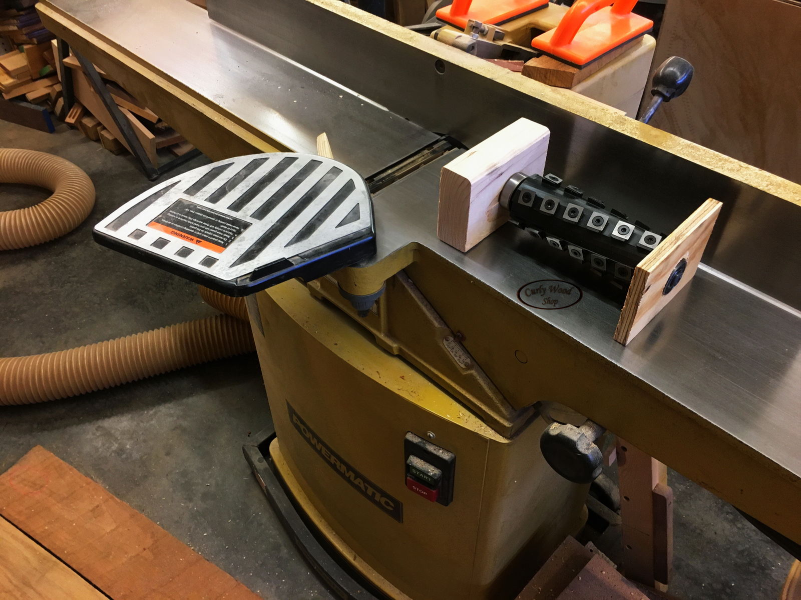

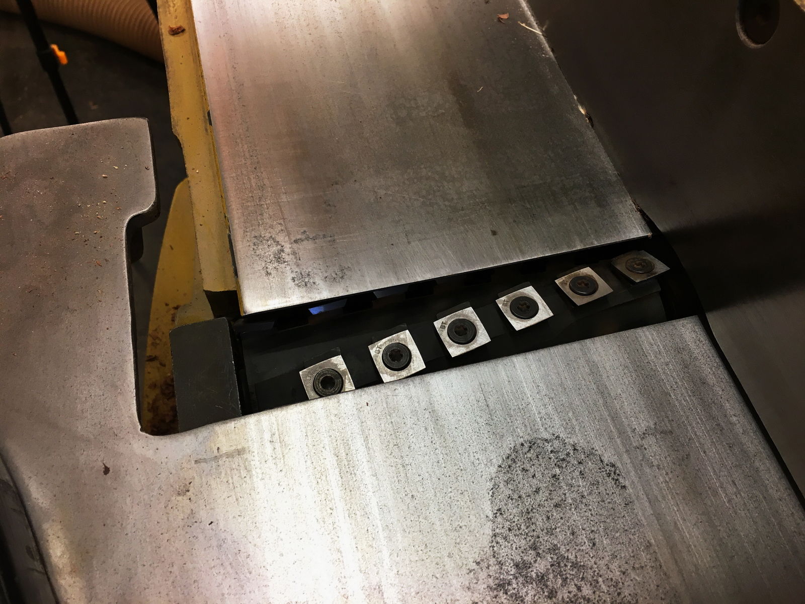

October 11, 20206 yr Popular Post comment_245013 I'm building a Curly Maple and Purpleheart audio rack and the front edge of the Curly Maple needs to be pristine. When I tried to run it across the straight knives of my jointer a while back it did what I expected it to do - it chipped. So I ordered a Shelix cutterhead but they were back ordered and it just came in a few days ago. The install of these is well documented so I won't bother with that except to show a few photos, the most significant being the huge drop in sound level. I wear hearing protection at all times when equipment is running in the shop but it's still cool that the sound dropped this much. The before and after sound tests were on the same piece of Walnut, 6" wide (the capacity of my jointer) and about 11" long, rough side straight off the sawmill for both tests. I took the board from rough to smooth and recorded the highest sound for before and after. David Report

October 12, 20206 yr Author comment_245028 Seems like mine was 5 weeks. It is well worth the wait, though. David Report
