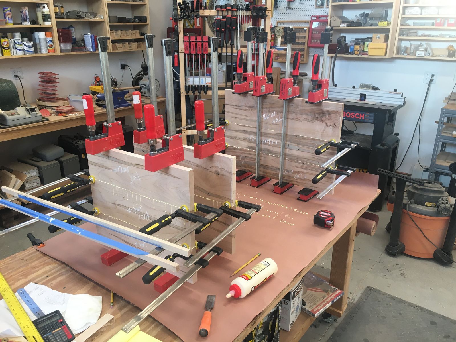

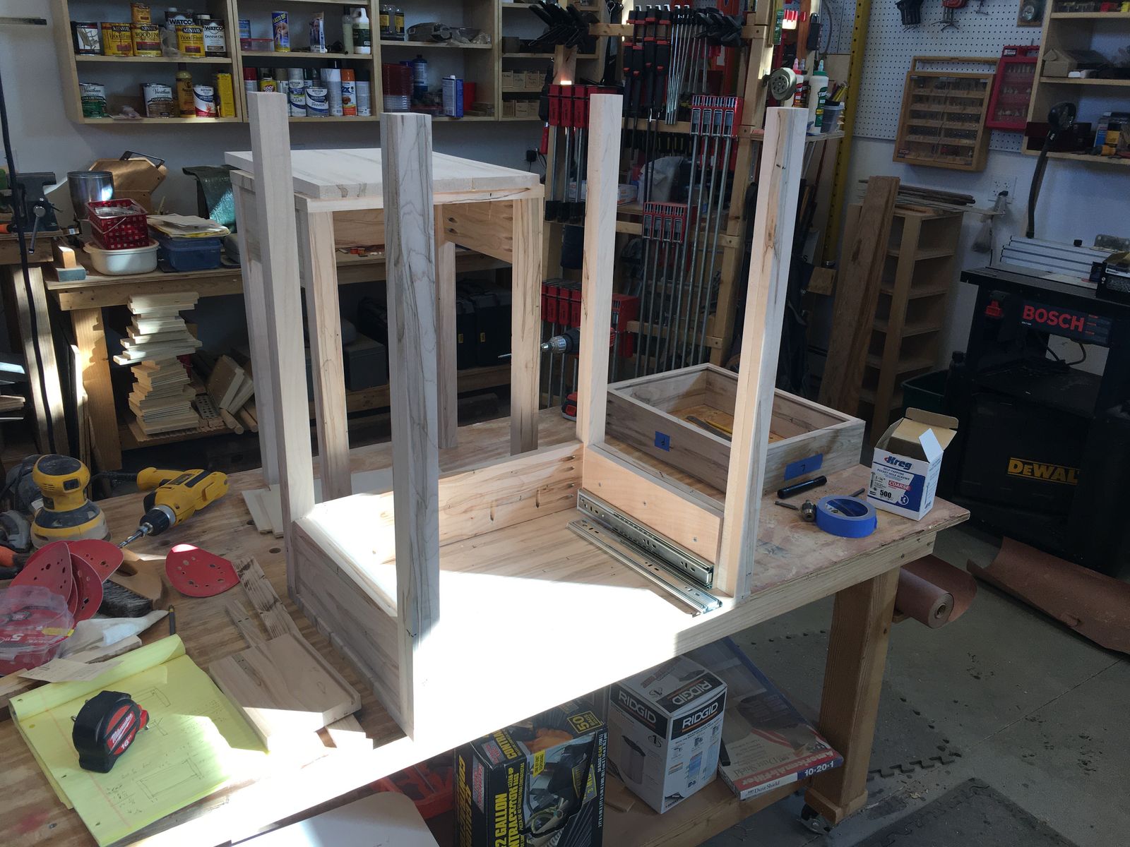

October 7, 20206 yr Author Popular Post comment_244575 did someone ask for pictures? ok, phase 1 under way, gluing up the desk top, the printer table top, and the printer table shelf: more later (need to glue up the legs next, create some 2x2s. Report
October 7, 20206 yr Author comment_244600 tops and shelf cut to size. legs glued up, planed to dimension, and cut to length. skirts cut to size, took a break, just started drilling pocket holes for the skirt to leg connection and skirt to top connection. pics later. Report

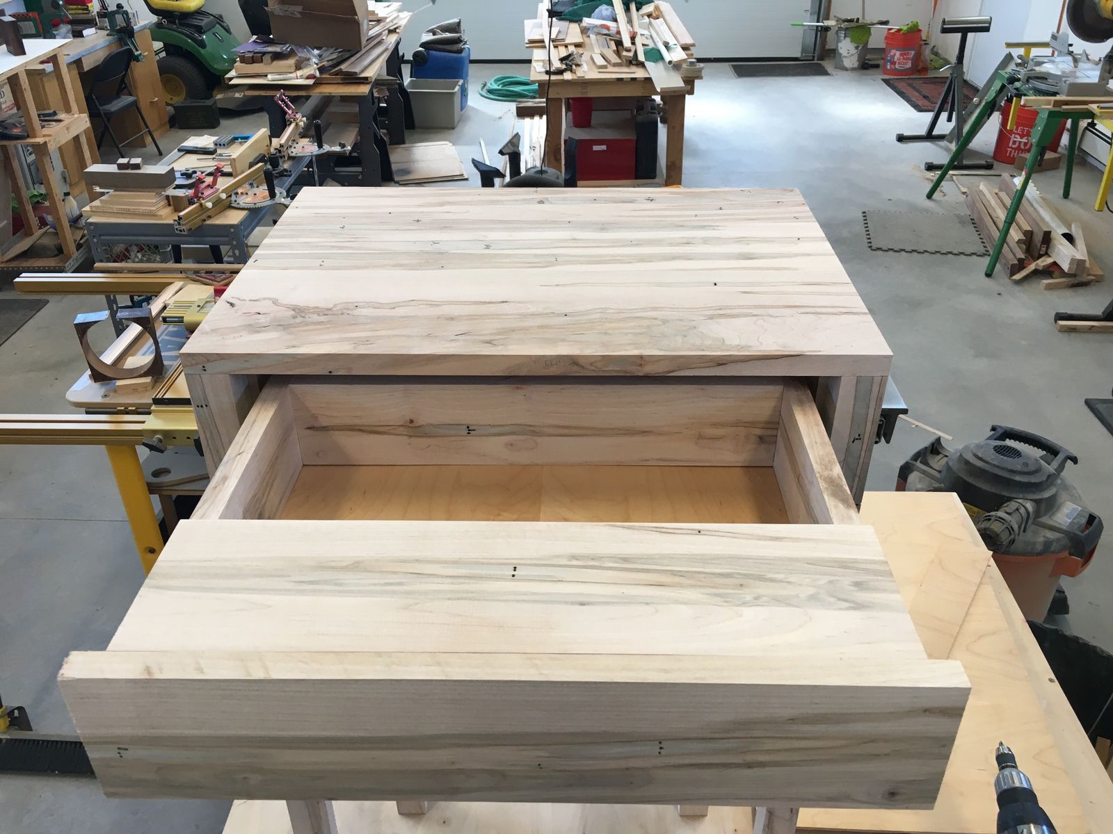

October 8, 20206 yr Author Popular Post comment_244684 making progress. snapped off a pocket screw trying to close a gap. sigh. guess i'll undo things and fix it. need to cut the drawer bottom to size, and need to cut the printer table shelf to size (shorter table). should be wrapped up by lunch. Report

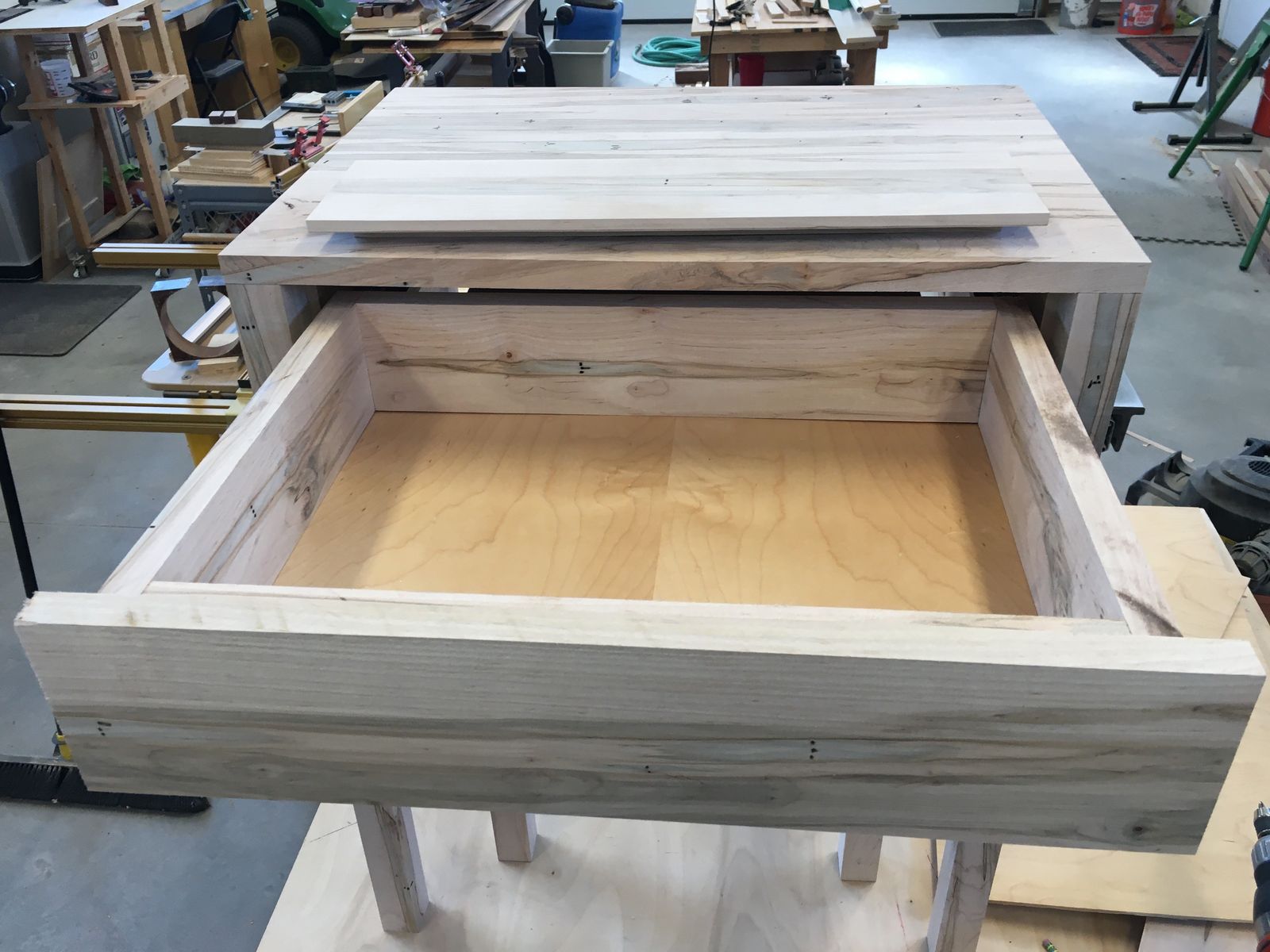

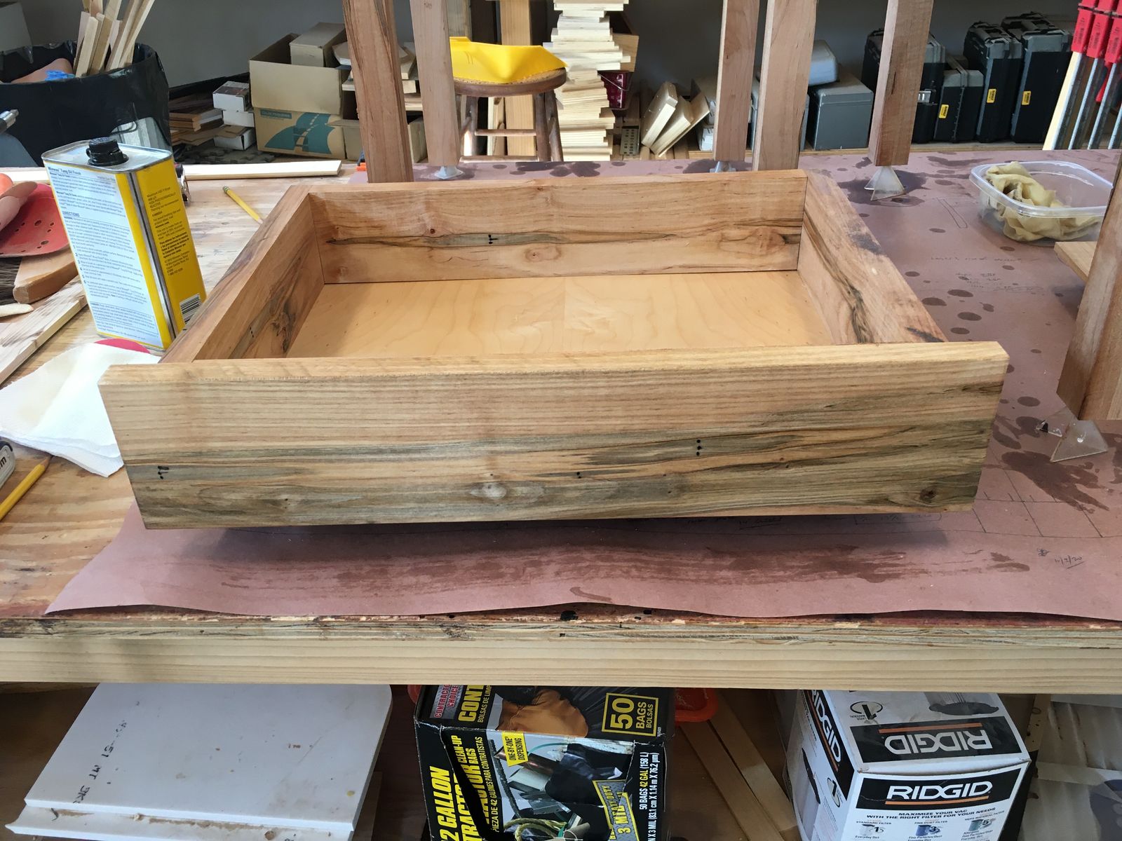

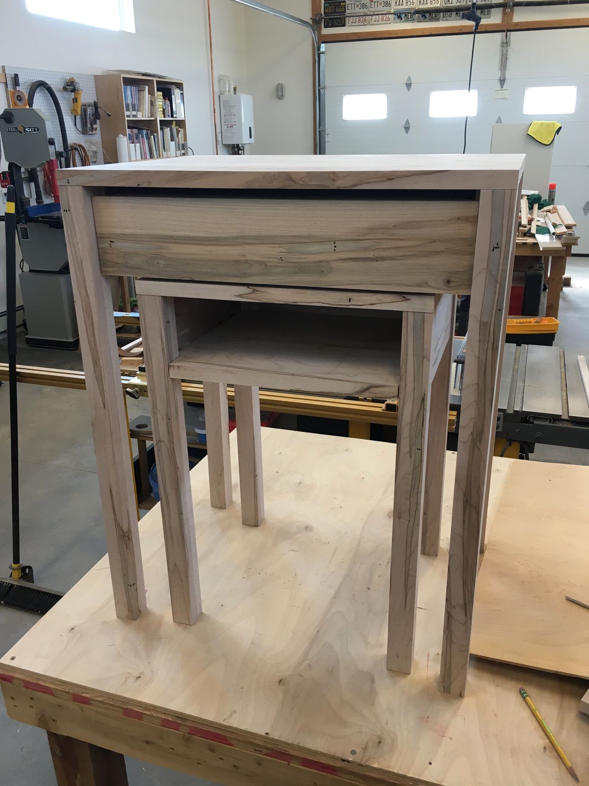

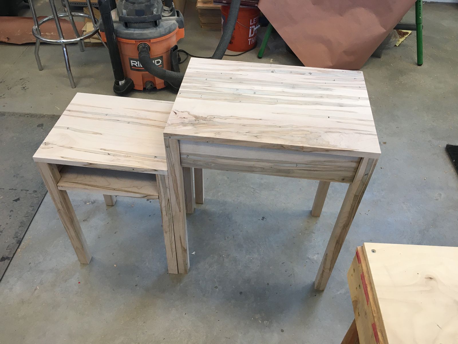

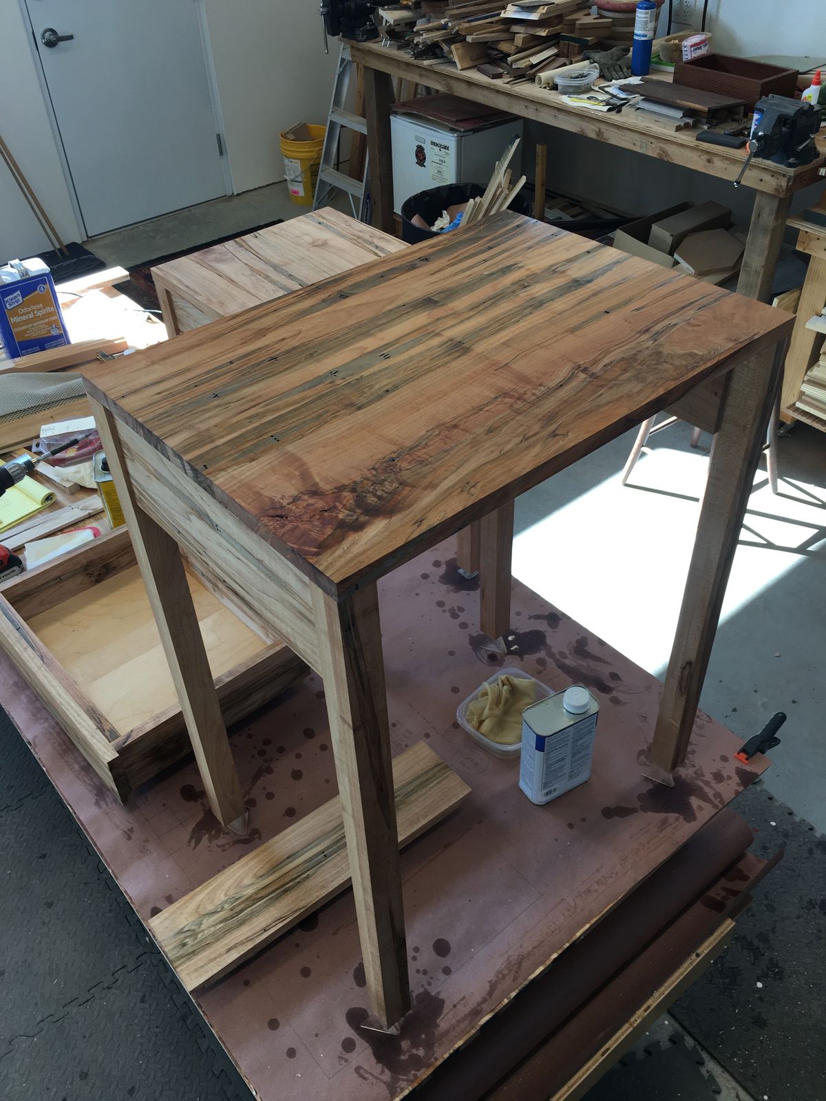

October 8, 20206 yr Author Popular Post comment_244694 wrapped up the build this morning, the small table (for a printer) even nests under the computer desk's drawer. little insert for the drawer, so if you want, you can set your keyboard there, or on the desk top. it's good to have options. i'm low on Tung oil, so i'll have to get some this PM from homey depot. Report

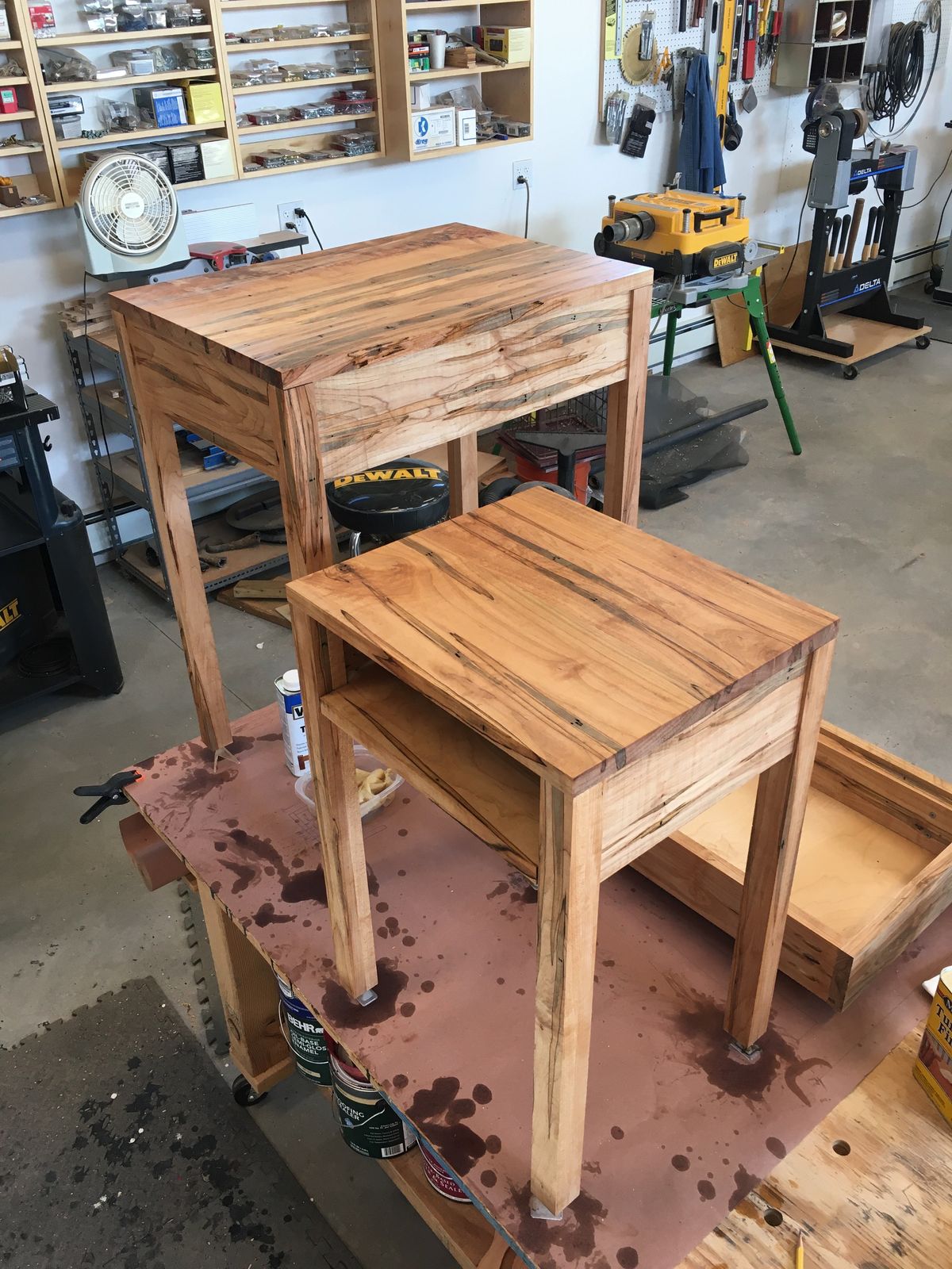

October 8, 20206 yr Author Popular Post comment_244714 finish applied, nice rich color now. went looking for Tung Oil, which i've used before on this type wood, but homey depot didn't have any, so got Teak Oil instead. very similar application, i'm happy with it. nice part is that it soaks in, it doesn't lay on top (like Polyurethane), so you can put it on generously, and just wipe away any excess, or apply more to areas that soak it up well. another coat tomorrow. delivery Saturday afternoon. Report

October 9, 20206 yr Author comment_244785 second coat of finish on this morning, i'll check it later today, it should be good to go. Report
