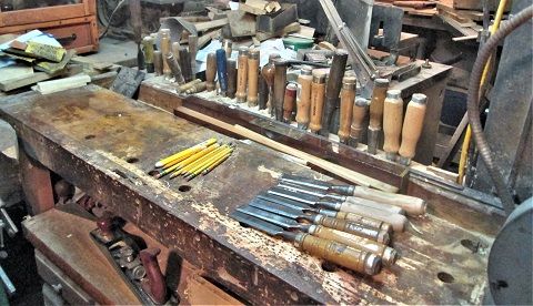

Ok, latest Project is about ...done.    Time to clean up the bench, put away the toys,,,and maybe rehab a few items..:ChinScratch:
I can finally set this back on the bench....bench is a bit ...full...:BugEyeSmiley:

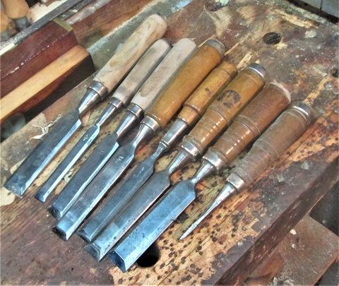

Chisel shaped objects, at least the 3 in front...the other was rehabbed long ago...clean, sharpen, and re-do them handles..
May "refine" the other two....Scratch Awls were also cleaned, sharpened up, and a coat of finish brushed on...

Bench has been cleaned up...
Spent a lot of time, rehabbing about half of those chisels..
And, after the other half is done...it would be kind of a shame to just toss them into a drawer, some where...or the Toy Chest..

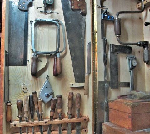

May just close the doors on the tool chest..:ChinScratch:
Hmmm, don't want to hang anything on these doors...I need the elbow room:rolleyes:

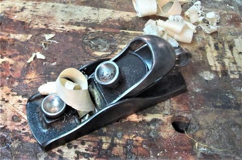

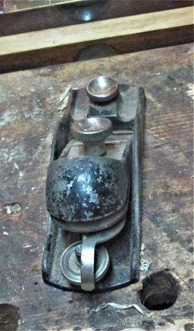

Ok...there was a plastic tub I brought home from Fred's place.....I thought I have all the little block planes rehabbed.....:ph34r:
Roooooh....Kaaaay.  Needs just a new iron, right?:WonderScratch:
Well, I was getting tired of playing "My dovetails are better than YOURS".:ROFL:..figured I could just rehab this little critter...:ChinScratch:
Shouldn't take too long, should it?:Tapping:
I mean, I have seen worse...:rolleyes:

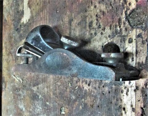

Roh-kay, Raggy...tear this down to just parts..and see what we have...:SaluteandRun:
"Hide yer eyes, Mabel!"  :BugEyeSmiley: Iron was one that came from a Yard sale Stanley No.3   ( yes, they were using it IN that plane!:WonderScratch:)  No eccentric lever (no big deal)Cap iron was a pot metal, blunt instrument.   Crud and rust everywhere...:DevilLaughing:
Wire wheel to clean things up..
Which left getting the iron sharp....and flat..as it was neither....even had a back bevel...on a bevel up plane?  :BangingHead: sanding center, grinder, and the buffer wheel.....Hone on two oils stones, and some 2000 grit paper...then the buffer wheel to polish....then that blunt object.:MachineGun:...Front end, that "helps" direct shaving out of the plane....was more like a road block....shavings would hit the "wall" and just fold up like the bellows on an Accordion...:ArguingSmileys:
Sanding disc to bevel it...no longer an 1/8" tall wall...polished the underside a bit, for a better fit to the iron.:TwoThumbsUp:
tain't "pretty", no shiny Brass, nor Bronze..:WhoMe:..set up a test track...tune the plane a bit...:ChinScratch:
Seems to work just fine.   Might just call it done...only took an hour of "drudgery"..:rolleyes:
Stanley No. 9-1/2....Might be from the 1960s?    I look into the spare iron box, and see IF I have a newer iron...:WonderScratch:
Rehabbed handles on 3 chisels have a finish on them, now..waiting on drying time....then see about making a case for them....and even some more Hand Cut Dovetails...LOL.

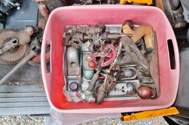

For those wondering about that plastic tub...that Ducksoup sent..
See that "pink" thing?:rolleyes:
It's in there...somewhere
