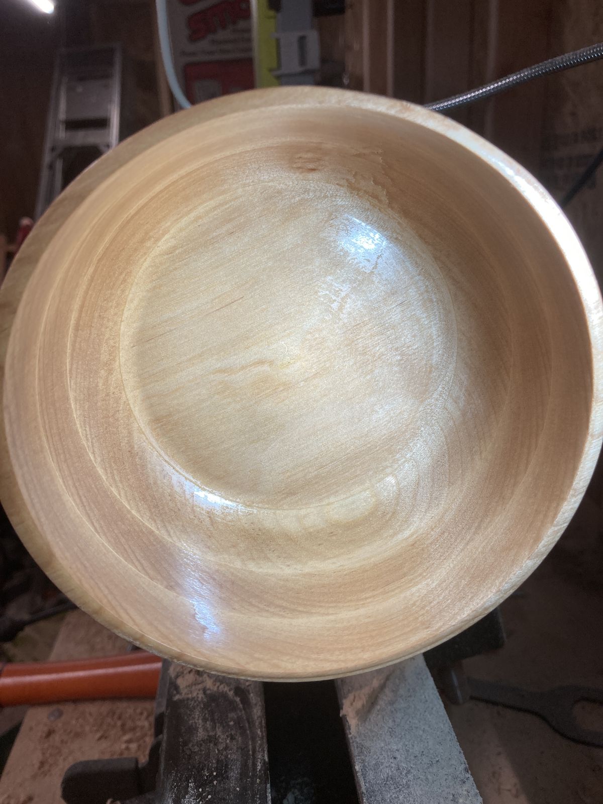

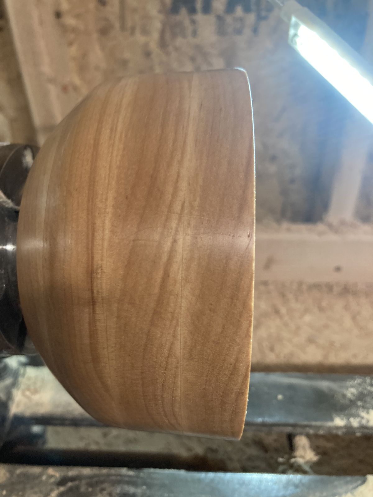

September 21, 20206 yr comment_243132 I'm not sure if this is the right way of doing things but the birch bowl that I started working on yesterday.... I started hollowing out today. I took the outside walls down all the way to about an 1/4th an inch or thinner. I still need to hollow out the bottom I've still got about an inch of material left to work with. I wont be taking it too much deeper because of the risk of blow through. Not sure if this was wise or I should have left a little more material in the long run or not. But hopefully this one will turn out nicely. Edited September 21, 20206 yr by AndrewB Report
September 21, 20206 yr comment_243135 Lookin' Good! Depending on the intended uses, bowl diameter, and the type/condition of the wood- the wall thickness can vary considerably. Display pieces (not for actual use) can have wall thicknesses so thin that light can shine thru them. Larger utilitarian pieces can have a thicker wall. Try to aim for consistent wall thickness from the lip all the way down thru the bottom. Report
September 21, 20206 yr Author comment_243136 That's what I've been trying to do how ever I just get a bit concerned about blow through. Report
September 21, 20206 yr comment_243137 1 minute ago, AndrewB said: That's what I've been trying to do how ever I just get a bit concerned about blow through. We are all members of the "Funnel Club"! Report
September 21, 20206 yr Author comment_243138 Fortunately I haven't done that as of yet. But speaking of funnels. That would actually be really fun to try is making a funnel lol. For it's intended purposed. Report
September 21, 20206 yr Author comment_243142 Aside from a few marks Id say this one came out okay for how thin it is. Report

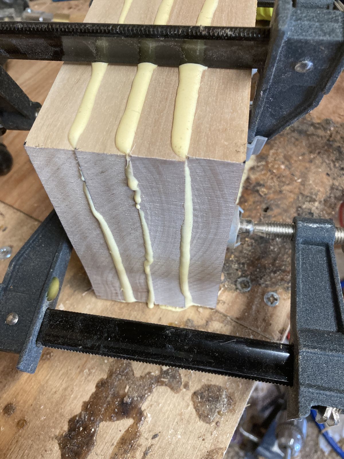

September 21, 20206 yr Author comment_243151 Got the second Birch bowl blank glued up just hurry up and wait for it to dry now. I'm contemplating on going to home depot tomorrow and getting another 4 1/2 feet of birch wood. About 25 bucks worth of birch will make two bowls at a 6 x 6 x 3 blank size. Not too bad. Report
