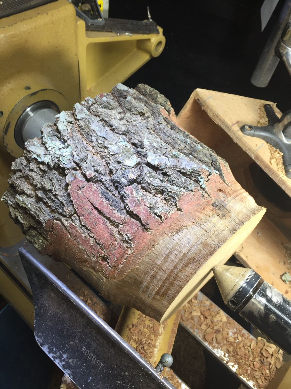

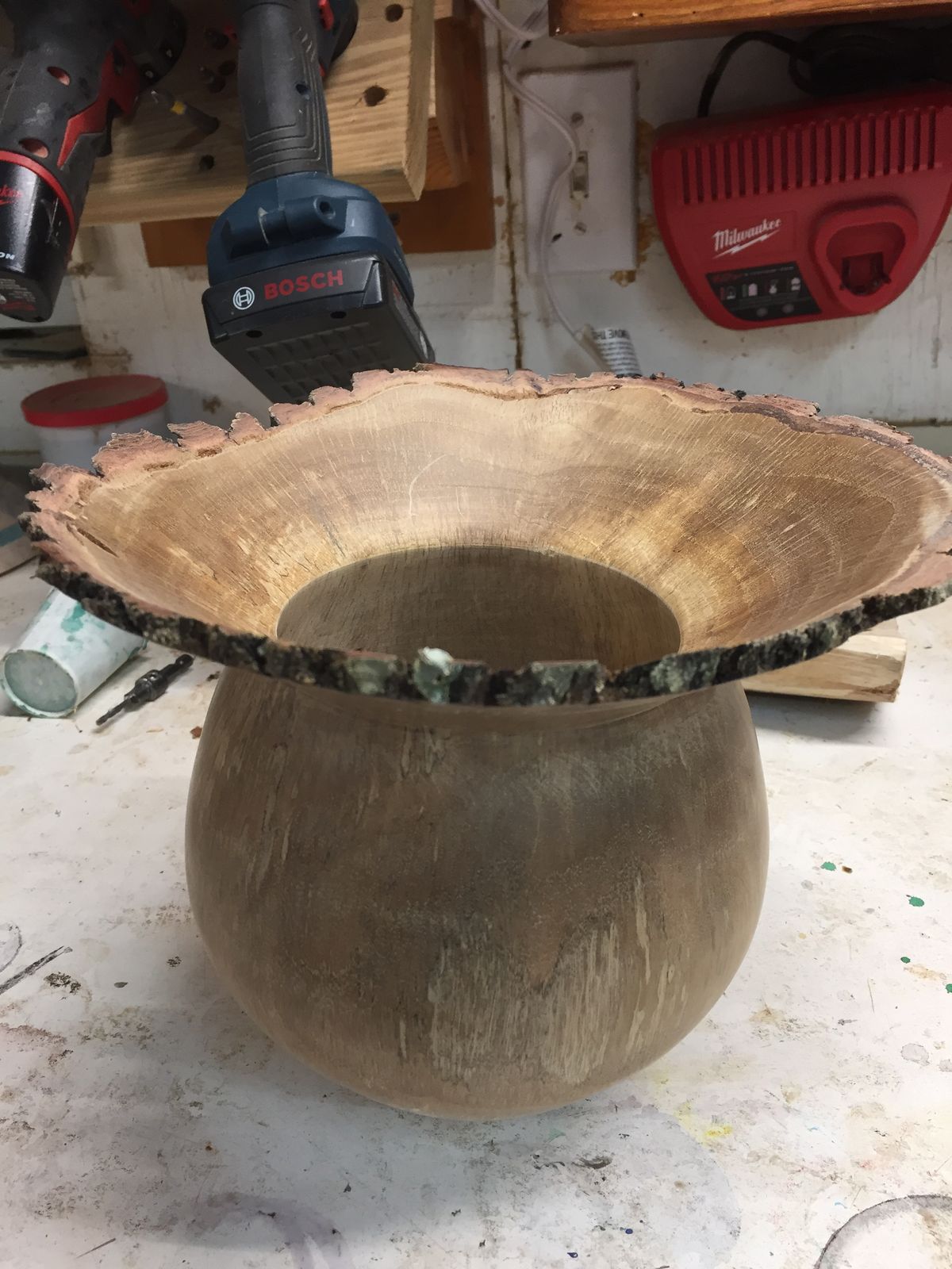

September 2, 20206 yr Popular Post comment_240957 I was inspired to do this when I looked at a thin turned bowl sitting atop another round bowl. Can’t remember to take pics like Steven but did get beginnings and end. Two little problem at end. When I came back to it today some of the bark separated . Tried to glue and it came off so pieced back on. Did the bottom too thin and got two cracks in bottom when parting off. Good news is both anytime repaired. The bottom is about 3/8 and the top. Wing about 3/16 Report
September 2, 20206 yr comment_240960 Beautiful!! my last couple of natural edge attempts had the bark come off. I think I waited too long after the log was cut. Report
September 2, 20206 yr comment_240961 I always admire these pieces with bark. How do you glue it back? With what glue? Gerald, I meant to say that you did an awesome job. Edited September 2, 20206 yr by FlGatorwood Report
September 2, 20206 yr Author comment_240962 I use CA but from what I hear that may fail in maybe 10 to 20 years. I put CA on both inside and outside edge of bark. This tree was cut in about May and I was shocked that the bark has held on three pieces but I am turning bark edge thin. This was again Live Oak Report
September 2, 20206 yr comment_240964 its looks amazing are you gonna seal it or leave it natural? Report
September 2, 20206 yr Author comment_240968 Not sure of finish because of the NE I cannot buff like I usually would with Watco. Could be shellac or lacquer. Don't care for poly at all. I recently got some waterlox but am not impressed . Report
