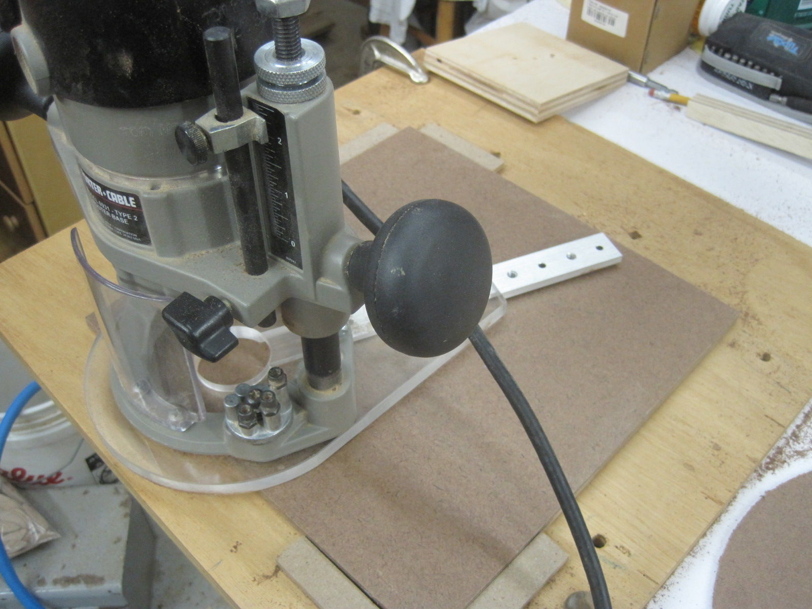

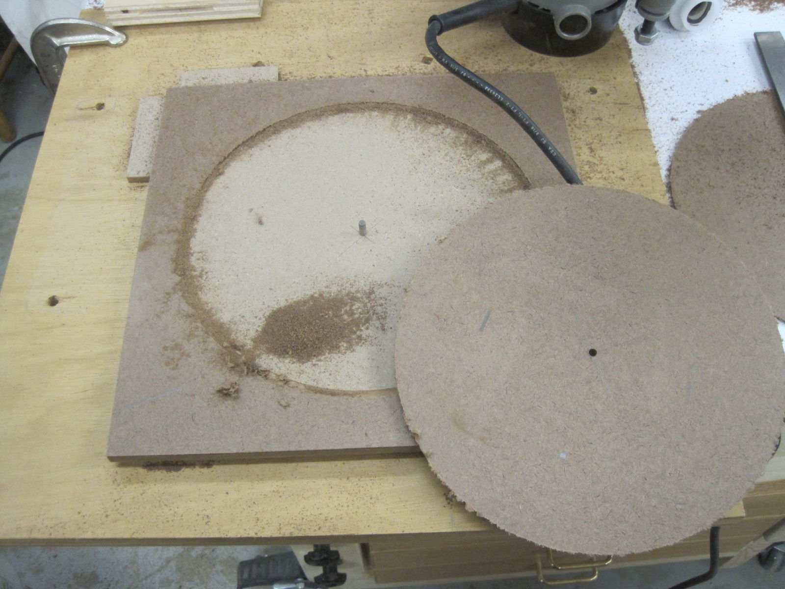

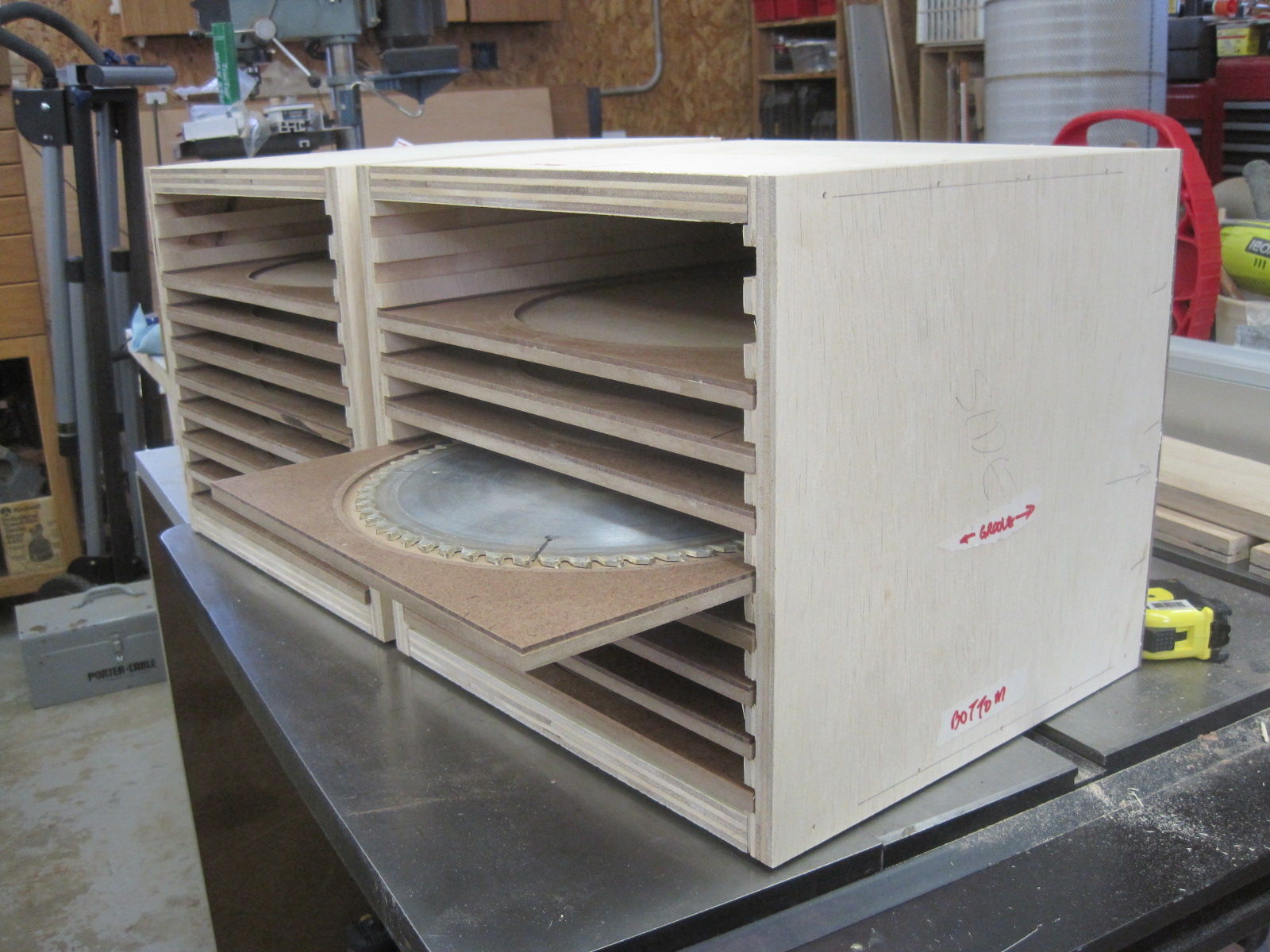

Popular Post tomp Posted October 13, 2020 Popular Post Report Posted October 13, 2020 I liked the idea of storing them in the plastic holders - until I looked at the price. So I built a "cabinet" with grooved sides to hold the trays made from an MDF bottom with an 1/8" hardboard top glued to it. This sits on the shelf below the side extension on my Delta saw. Gluing around the perimeter of the bottom panel Making the cutout for the saw blade Showing the center cut out With a blade in place Cutting the dadoes for the trays Assembled with some trays installed The cabinets sitting under the saw extension Sorry, it's been a while and I've forgotten how to resize (reduce) the pictures. When I first made these, I'd planned on drilling finger holes in the trays to make them easier to pull out, but there's enough space between the trays that I can just grab the edge and pull them out. HARO50, John Morris, p_toad and 7 others 9 1 Quote
Fred W. Hargis Jr Posted October 13, 2020 Report Posted October 13, 2020 I like that, clever! Cal, FlGatorwood and lew 3 Quote

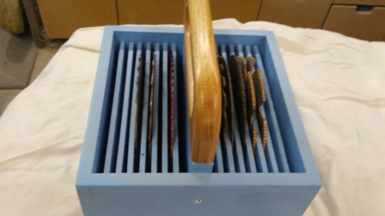

Popular Post Gunny Posted October 14, 2020 Popular Post Report Posted October 14, 2020 I used the idea of a beer caddy that seem to be so poplar last few years. They tuck nicely into this drawer. FlGatorwood, Artie, p_toad and 2 others 5 Quote
