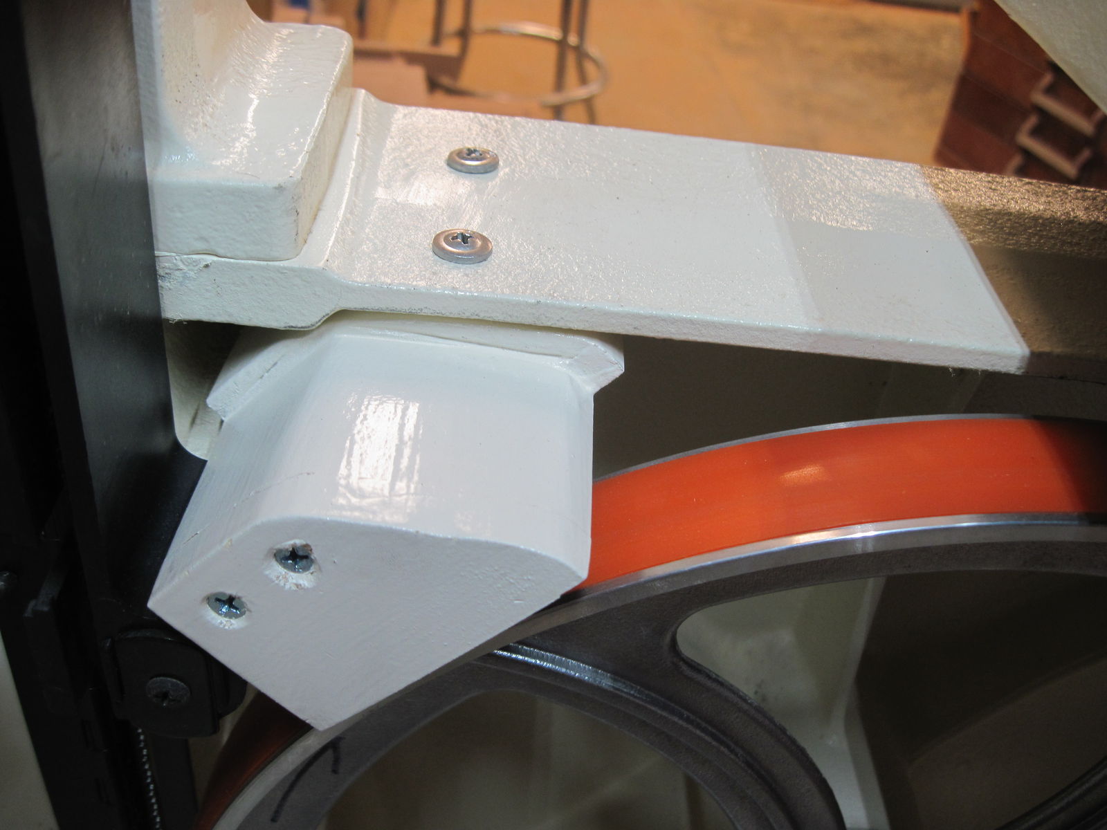

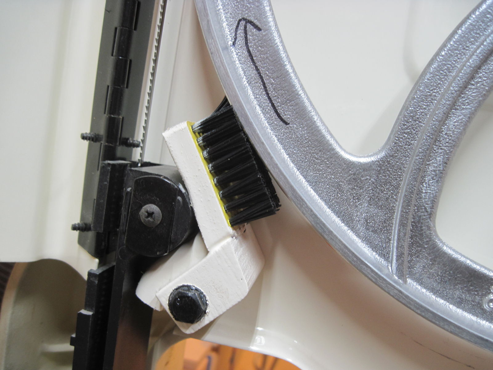

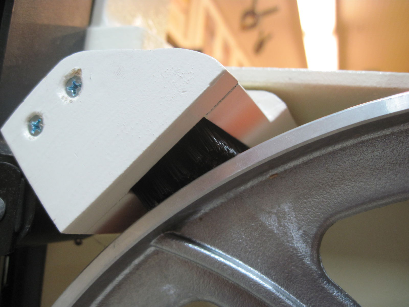

August 15, 20206 yr Popular Post comment_239135 If you do not have brushes on your saw here is my solution. Used a fingernail brush from the Dollar Store. Report
