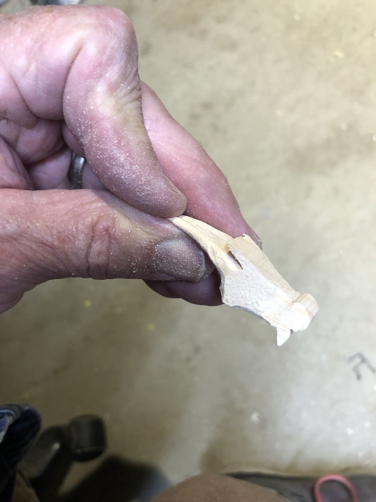

I didn't like the bird, it was way too small for the cage. So I made my own bird. I cut it out with a small band saw and  used my Ryobi rotary tool with some small sanding cylinders. It isn't the greatest, but it is nonetheless......a bird.
I was thinking put a Lego man inside.  :D
