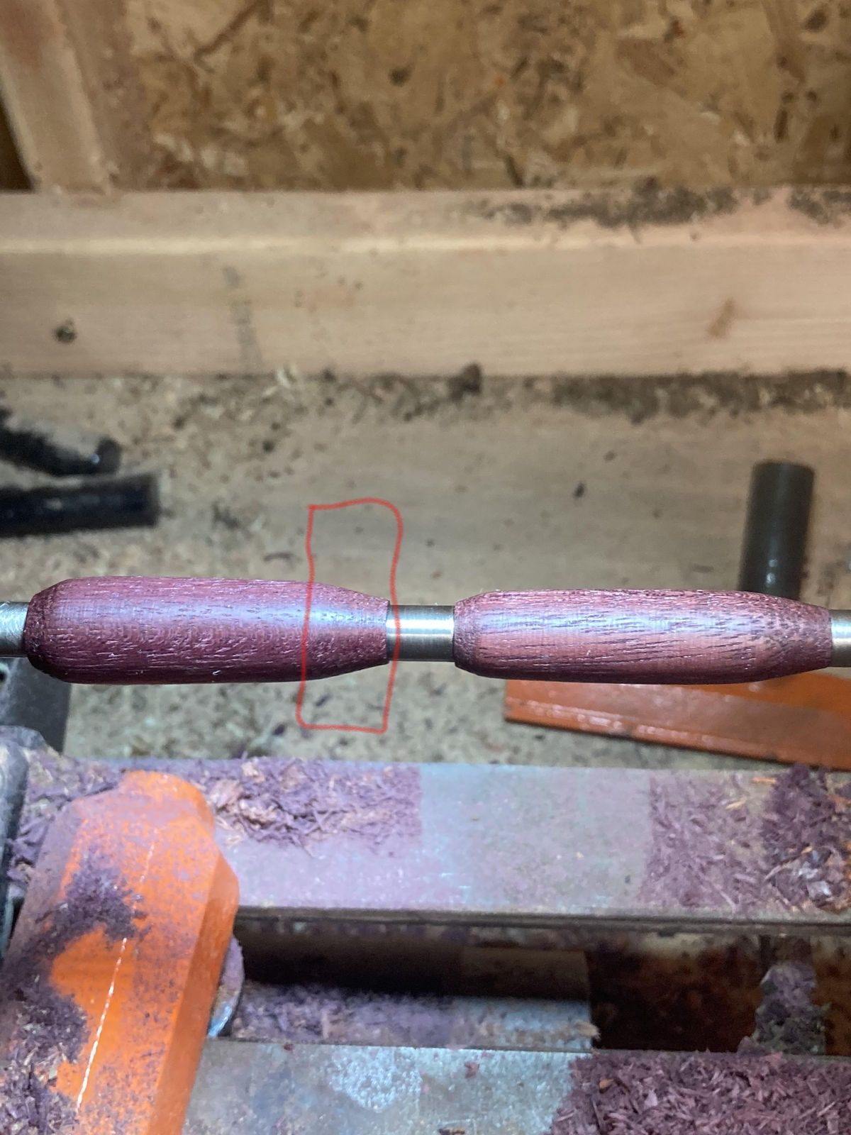

If it is on the ends as I have outlined in picture below this is a simple and effective fix.  Carefully cut down a short way back to the brass barrel.  Then take another piece of wood and drill hole through center.  Using CA glue take the blank and glue the small piece back to the barrel and against the remaining wood on blank.  I suggest different species of wood, normally I would go to my cut off drawer full of small piece and use them for this.

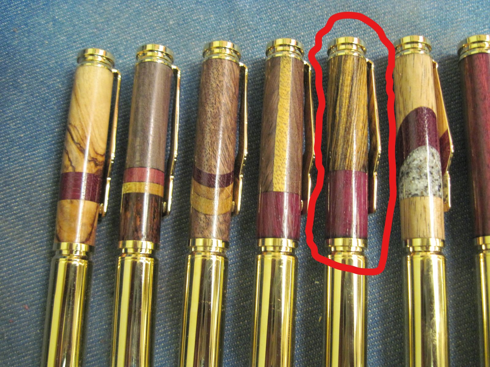

Once the CA has cured put back on the lathe and you now have a custom laminated pen.  No one will ever know you had issues during turning and you will not waste the blank.
This is an example of what you end up with when done.

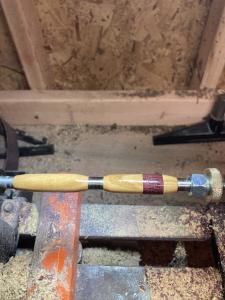

@Gunny Giving your lamination a try with some purple heart mixed in with what I "THINK" is iron wood or maple.  On one piece.  I've got it out waiting for the ca glue to cure up.  So this one should be an interesting mix if it works out.  If it does I'll do more of them.  I dislike getting CA glue all over my danged hands not fun to clean off.

Okay I think I'm going to be doing this more often I like the way this one is turning out.  Gonna need to put in an order for more CA glue..... Should have done a Purple Heart strip for the bottom.

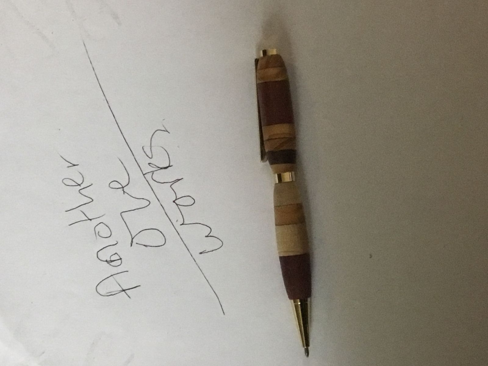

Trying another one from Multiple layers,  if it works out, I'll be calling this one German Chocolate Cake....
Another one finished turned out lovely think I’ll call it a German chocolate cake.
The funny thing is on this one I recorded video, I'm just editing the footage now, this ones already got a home how ever I'll post the video footage of it.  This ones actually going to a Geology professor which is why I had it layered the way I did.  ALso since I didn't have extra spacers except for the three originally with the first kit I purchased I made one out of a left over piece of purple heart and it worked out pretty good.
