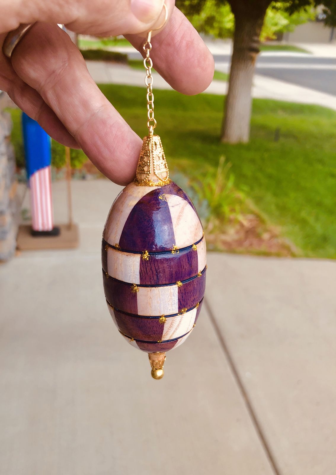

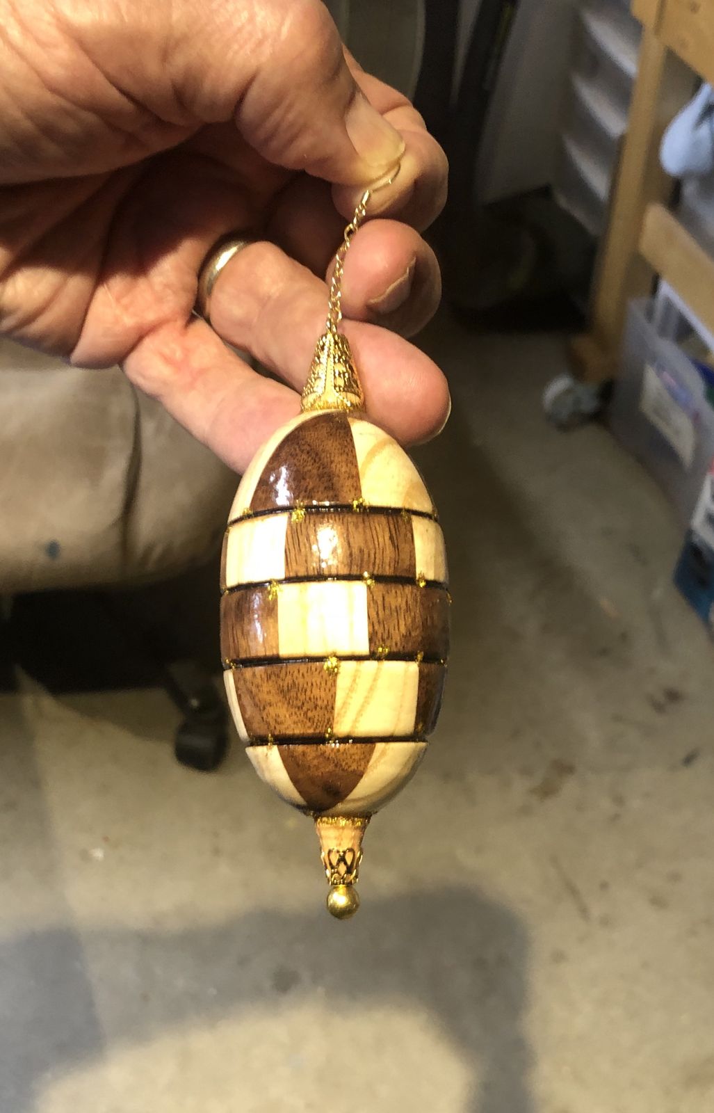

 I also made a neat discovery. The dark Walnut, when finished with this stuff, turns purple in natural outdoor light Inside, it looks like walnut until a light hits it and it seems to have a purple glow.
 Check this out. Same ornament. One picture inside with indoor lighting and the other outdoors. Kinda WOW.:lol: I decided not to touch the finish after I saw this. AS is looks good.
