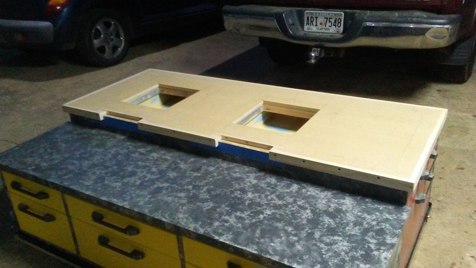

The sides of my TS cabinet are layered in oil based paint.  1st coat was aluminum paint, then a grey flat color and finally splattered with a silver color.  Let that dry for a week and coated with 3 coats of rolled lacquer.  It does produce the same look as rolled sheetrock walls.  Unique but rolling lacquer used alot of lacquer at each coat.  The odor in the shop even with exhaust fan running was rather heavy for a week or so afterward.
