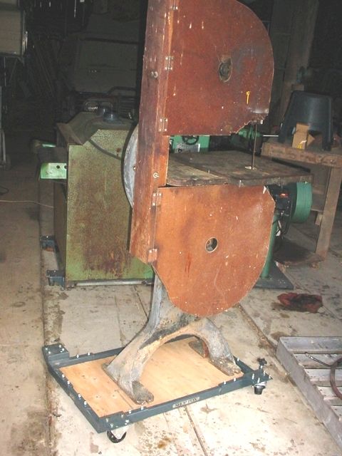

I have around 6 Grizzlys so far... Love them all...
