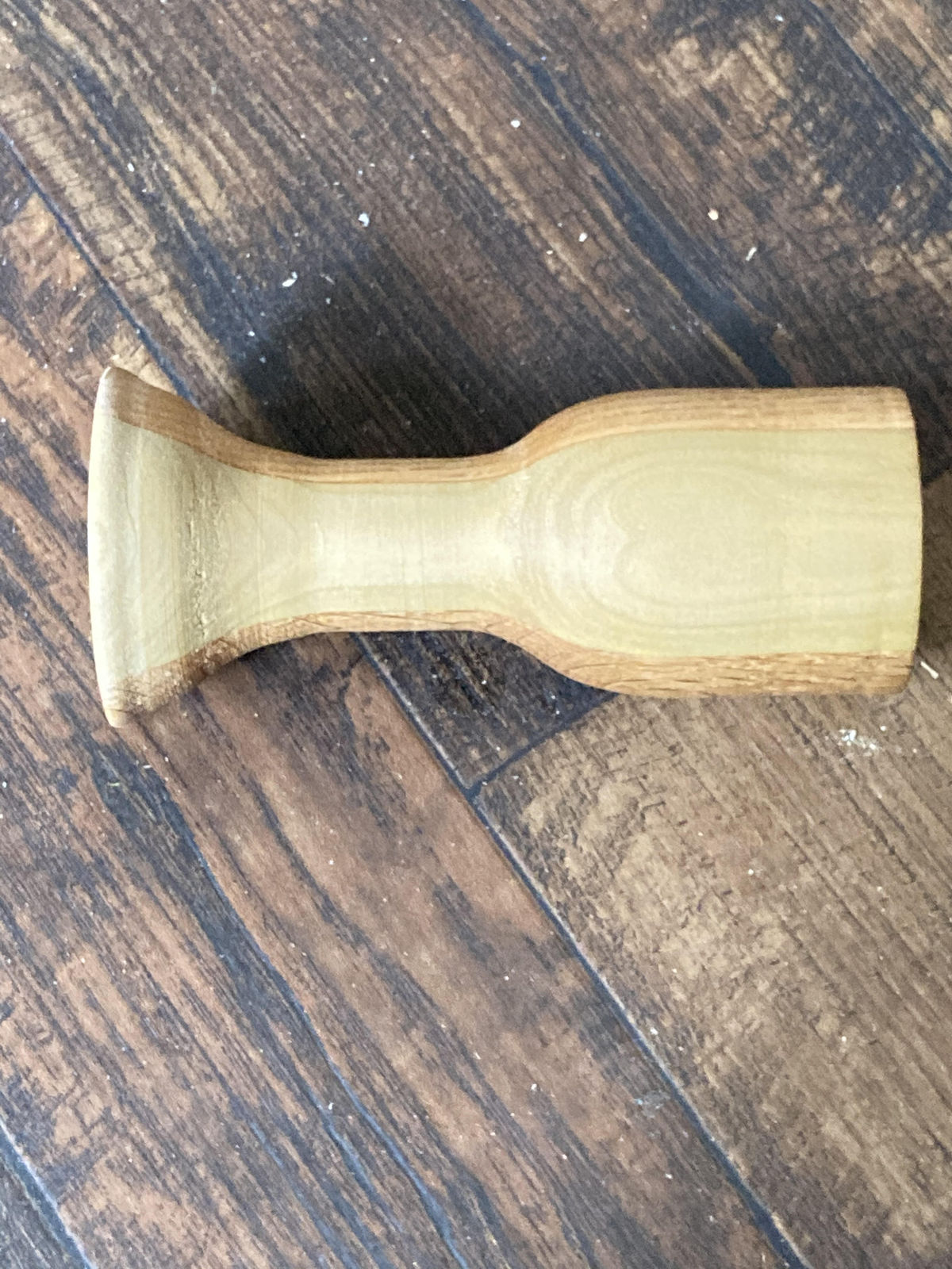

Popular Post AndrewB Posted July 4, 2020 Author Popular Post Report Posted July 4, 2020 The easy wood tools made quick work of this little piece of scrap that I had. I wanted to give the tools a test run. This isn't quite a full goblet and its not hollowed out. But again this is a poorly glued together wood piece. Either way I think i like the shape I would have probably gone with a longer stem but. This was only to test how well the carbide tools worked. This took me oh no more than 45 minutes to cut out. I still sanded it down put a coat of boiled linseed oil on it but no more than that since it was just scrap. FlGatorwood, Larry Buskirk, HARO50 and 2 others 5 Quote
lew Posted July 4, 2020 Report Posted July 4, 2020 Great! You are getting the shape really nice. This is the point where I'd start hollowing- before you refine the stem. That gives you more support while you do the inside. You can also kinda go back and forth between inside and outside to get the shape you want. Once you start in on the stem, you'll want to provide support for the hollowed end. Cal, Larry Buskirk, HARO50 and 1 other 4 Quote
AndrewB Posted July 4, 2020 Author Report Posted July 4, 2020 The hollowing part is still kind of where I'm getting stuck I've gotta get some solid chunks of wood before I actually do any more hollowing on projects. So I can avoid the chipping and hopefully less catching on the next one I should be able to get some hollowing work in. HARO50, FlGatorwood and Cal 3 Quote

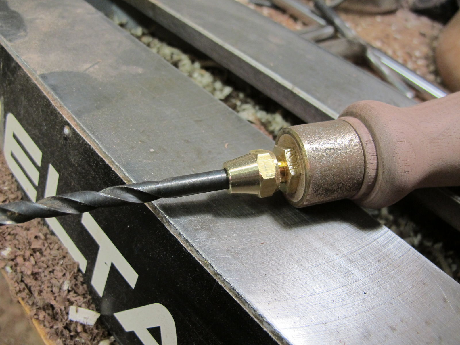

Popular Post lew Posted July 4, 2020 Popular Post Report Posted July 4, 2020 Sometimes it helps to drill a hole on the turning before hollowing. The hole can serve 2 purposes. First it can help you determine when you have reached the desired depth of the hollowing. The second thing is that it provides a bit of a relief area for the cutter/chips. This is a simple version I made. Notice the drill bit runs completely thru the handle to allow the bit to be adjusted for different depth holes, although that's not necessary. All the parts came from Lowe's. Here is a video of a similar one being made. As far as catches, try to keep the cutter's sharp edge at the center line of the of the turning. Too low/too high can cause problems. This is a video from the founder of Easy Wood Tools making a goblet. See if this gives you any ideas- HARO50, Cal, FlGatorwood and 2 others 4 1 Quote

Popular Post HandyDan Posted July 5, 2020 Popular Post Report Posted July 5, 2020 I saved the drill chuck from a retired drill and mounted it to a handle I had. Can use any size bit. Most drill chucks are 3/8" fine thread so they are easy to use. p_toad, FlGatorwood, Cal and 3 others 6 Quote
