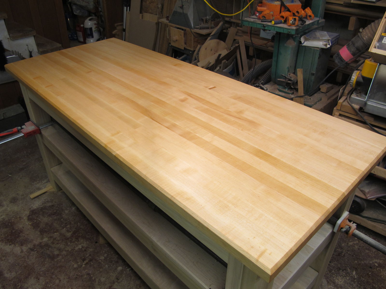

July 1, 20206 yr Popular Post comment_233928 I've made a couple of tops. This one from maple and walnut- it's about 2' x 3' This one was considerably longer made from hard maple- Both are edge grain. Used TiteBond III glue. Lots of clamps. Other than labor, I think you'll get a better quality piece by making it yourself. Report
July 1, 20206 yr comment_233931 7 minutes ago, lew said: Other than labor, I think you'll get a better quality piece by making it yourself. Agreed, assuming you have a local source for the wood. We bought a Boos island top from an online dealer in CT - must have been a second because it developed two splits in the grain, and no one responded. On the other hand, if you buy it from a big box, you can return anything that's defective. The special order people in kitchens should have that information if you can find an employee who cares. Multiple sizes available. Report
July 1, 20206 yr Popular Post comment_233933 1 hour ago, JimM said: Agreed, assuming you have a local source for the wood I'm lucky that way. There's a Mennonite run planning mill near here. Report
