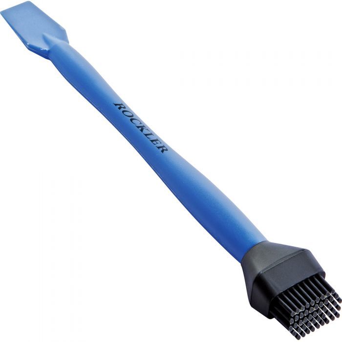

June 27, 20206 yr comment_233504 8 hours ago, FlGatorwood said: I simply use the bottle the glue comes in. I have to pick off the mother from the top of the cap now and then, but it peels right off. And, you can place the bottle on the side and turn it just a bit each time you pass by it. The slows down any set up from the air that gets into the bottle. I can control a very small bead by how much squeeze and speed I move the bottle along. Then I use an acid brush to spread out the glue, a wet paper towel to wipe up the over spread and runs. And, when the glue gets too stiff, just a drop or two of white vinegar will thin it back out. I will use a bottle of TB III in about 6 months. And, you can get a handfull of acid brushes from HF for a couple dollars. The last batch of 25 that I purchased is about 1/2 spent. I wash them as quickly as I spread the glue and apply the clamps. I quit using the HF acid brushes. The bristles kept coming loose an became too much of a hassle to pick out of the glue. So, about 5 or 6 years ago, I bought the Rockler glue brush. One of my better purchases. No loose bristles, cleans easily...even when the glue dries on it. Darn thing is practically indestructible. Edited June 27, 20206 yr by Gene Howe Report

June 27, 20206 yr comment_233537 5 hours ago, Gene Howe said: I quit using the HF acid brushes. The bristles kept coming loose an became too much of a hassle to pick out of the glue. So, about 5 or 6 years ago, I bought the Rockler glue brush. One of my better purchases. No loose bristles, cleans easily...even when the glue dries on it. Darn thing is practically indestructible. I bought one as you had mentioned this in another thread. Does work great. Report
June 27, 20206 yr comment_233558 10 hours ago, Gene Howe said: I quit using the HF acid brushes. The bristles kept coming loose an became too much of a hassle to pick out of the glue. So, about 5 or 6 years ago, I bought the Rockler glue brush. One of my better purchases. No loose bristles, cleans easily...even when the glue dries on it. Darn thing is practically indestructible. I don’t have enough experience to really put forth a review, but I bought the Rockler kit and mat, and I like them. Report
