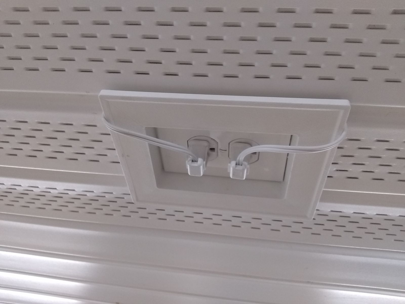

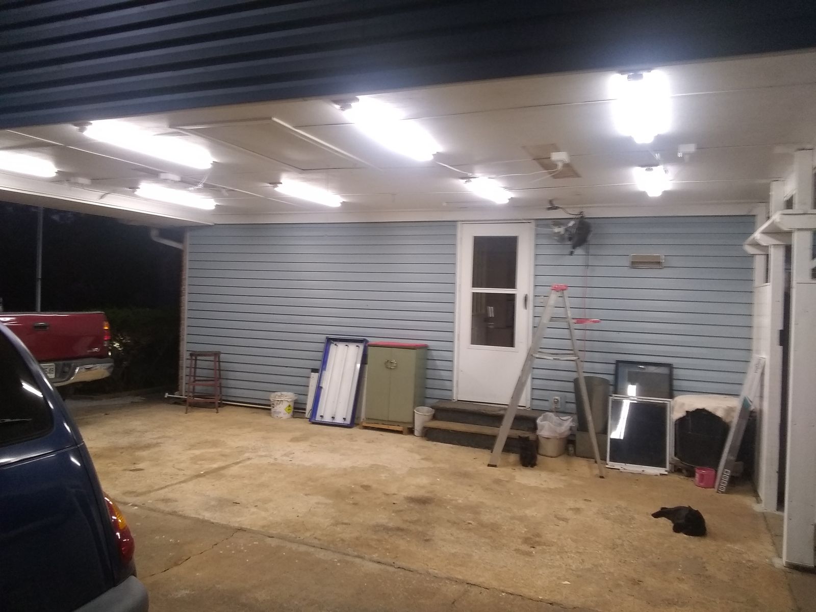

Putting nothing up for the moment is okay.  But think long term when you do install it, paint it.  It will lighten up the shop. Also don't skimp on lighting.  I went all LED as of last year and it is a huge difference.  Since you have a electrician at hand ask for outlets in the ceiling.   This way you can plug in your shop lights and if one needs replacing UNPLUG it with no need to turn off breaker and remove hardwires.  All my exterior buildings and shop have this method in use.  Forget looks we want convenience.  :TwoThumbsUp:
Would look like this if you take your time with the cords.  Used eight 4ft LED fixtures under my carport.  They came in 4 packs for $55. Carport is 20ft x 22ft.  Same set up in shop but I don't have shop pictures.

These are ones I use, have 32 units in various places.  Have installed 7 houses with a 8 light set up in carports just like mine in the neighborhood.  Everyone is pleased with results.
LED shop lights
LED lights come in a variety of options.  Unlike a incandescent bulb where you only cared about wattage LED's have wattage, light temperature range and lumens.
Yea I may wind up having to get something like t hat.  Although being a 10 food by 9 foot basically almost a 10 by 10 space I wouldn't need that many lights in there.  Even with the 2 led stick bar lights I've got in the shed the lighting is kind of dull in there.  But I'm still able to see.  So I may wind up investing in more.  How we did the plug for the lights in the shed is we stuck two outlets and hooked them into the ceiling then my brother wired them and we ran a light switch and he wired it to be able to shut off the two outlets on the ceiling and shut off.  That system works quite well.  So that may be what I wind up doing.
That's how I wired m shop for lights. Instead of hardwiring the fixtures as I would have for flourescent lamps, I put into outlets and switched them. Then I was able to put the LED lamps anywhere...plus they can be daisy chained (one plugs into another) so it really work out well. Those LED fixtures usually don't have replaceable bulbs, so you switch the entire thing out if it goes bad.
