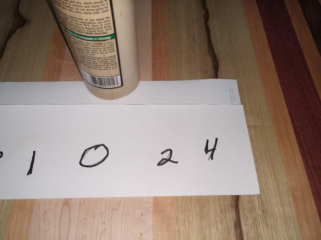

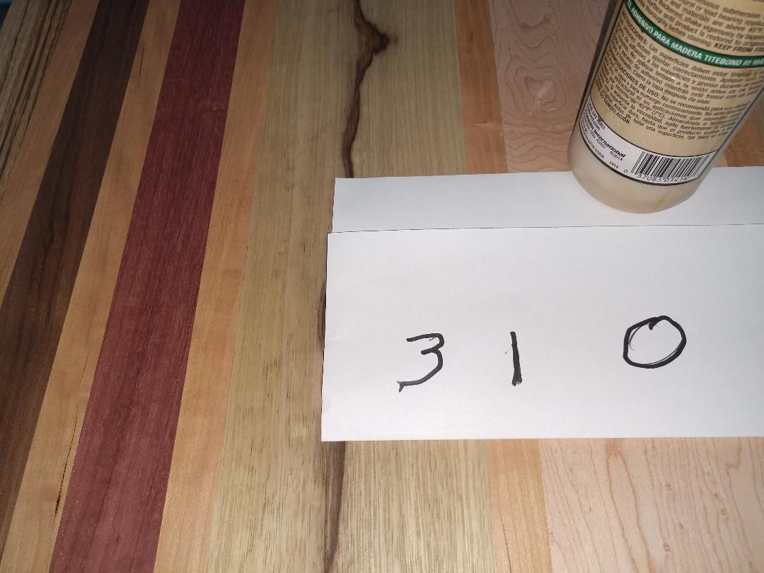

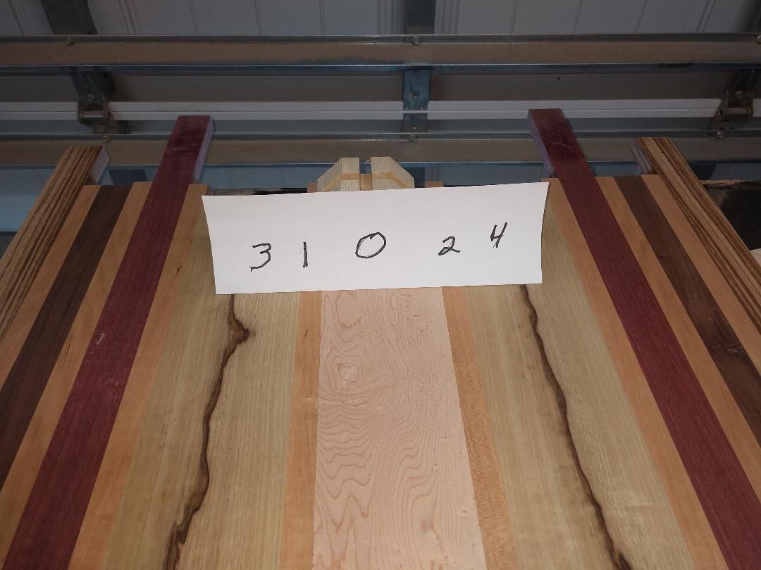

June 19, 20206 yr comment_232681 Subject is a 27" wide by 24" long glue up "doughboard". The problem: Sticks #1 & #3 (cherry) when glued to board #0 were "off" by about 1/64 to 1/32". Being higher,thicker, than board #0 (soft maple). Boards #3 &4 are black limba. The rest of the boards are purple heart, cherry, walnut & zebrawood. Before anyone goes crazy---I do as I'm told! She wanted those species. Period. So---how you you deal with the unevenness? I wound up sanding the heck out of the intersection of the woods.This resulted in the black limba having a detectable depression. Not by sight but by feel. But on reflection I think I could have: a) used a hand plane b) probably used a cabinet scraper c) sanded the crap out of it. So again how do you deal with it?? thks smitty Report

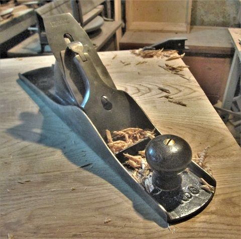

June 19, 20206 yr comment_232683 Hand plane would have been good. Work the high spots out. Now what kind of hand plane? @steven newman Edited June 19, 20206 yr by Gunny Report
June 19, 20206 yr comment_232685 26 minutes ago, smitty10101 said: #4, #5, #7 Newman would know better but I would think the #7 would be good. Report

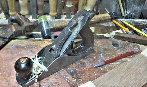

June 19, 20206 yr Popular Post comment_232695 #7...maybe...at the diagonals....then the #5 with the grain....at the glue joints....tidy up with the #4.... Report

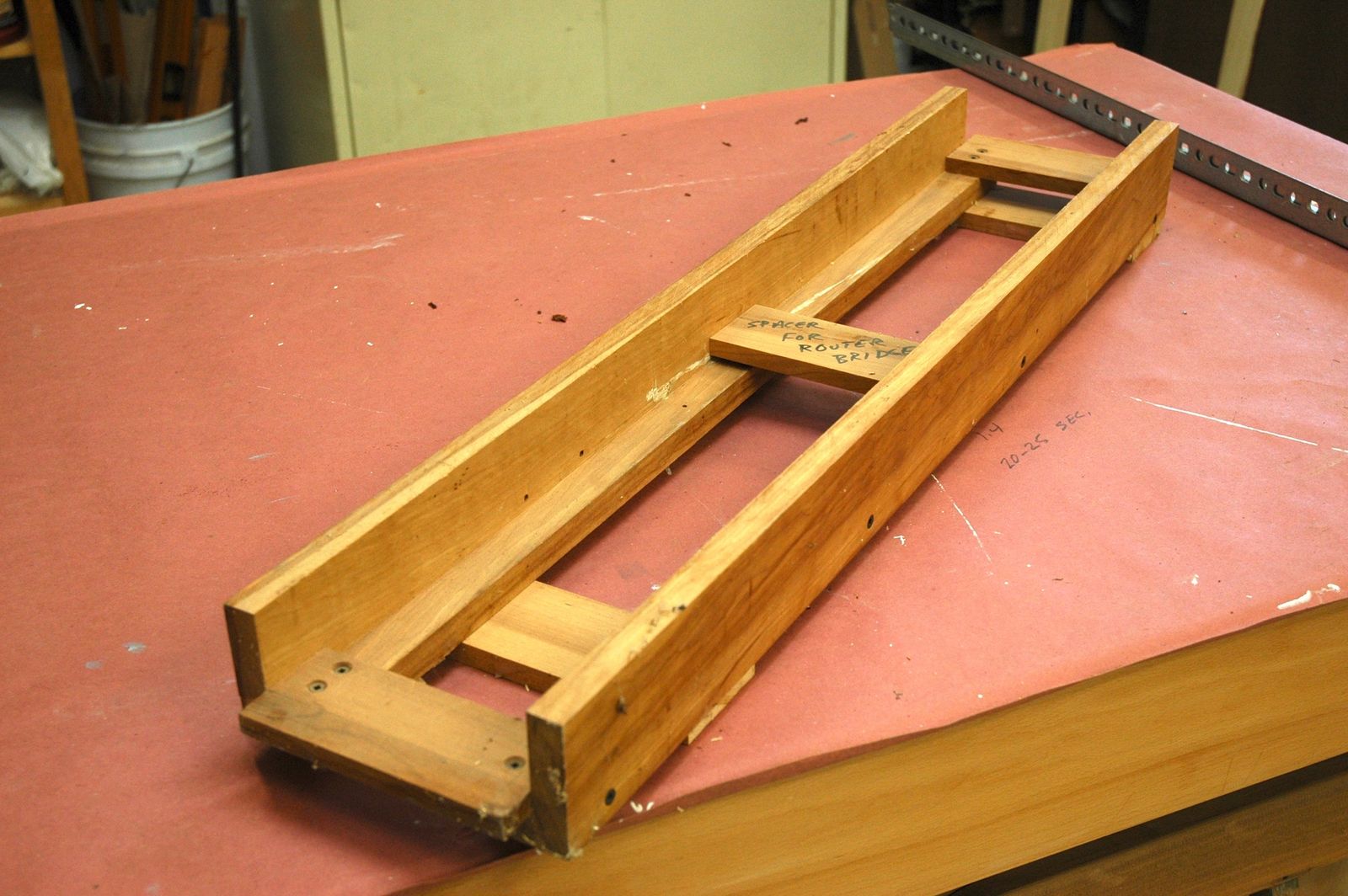

June 20, 20206 yr Author comment_232770 57 minutes ago, Fred W. Hargis Jr said: I'd probably go with the router sled as well...mostly because I already have one built. For all of you that have built/use the router sled method How do you store a jig that would accommodate a glue up that size (27x24) ? Or do you break it down & rebuild it when you need it again? Thinking about that question---you really only need to store the "sled" part, not the runners that go the length of the glue up. Router bit used?? a bowl cutter? or a dado bit ? or something else? Report

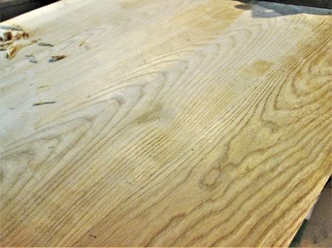

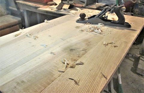

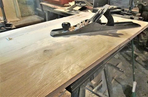

June 20, 20206 yr Popular Post comment_232775 Hmm No. 7c, working the diagonal No. 414c Jack plane...working around that knot Bottom shelf... Sometimes, just the No. 6 will do. And then tidy up with a #3.... Report

June 20, 20206 yr comment_232783 1 hour ago, smitty10101 said: Thinking about that question---you really only need to store the "sled" part, not the runners that go the length of the glue up. Router bit used?? a bowl cutter? or a dado bit ? or something else? As you surmised, I only keep the "bridge", and cobble to runners together when i use it. In the pic you can see (I think) cobwebs on the sled which shows how long it's been since I've used it. My bridge is 31" across, so it would handle your board across the 24" dimension, but probably not the 27" dimension.For the bit I used to use a straight bit I have that cuts 1" wide. But you can buy flattening bits, and there's a whole new crop of them available now that cut as wide as 2". Just search "router flattening bits". Report
