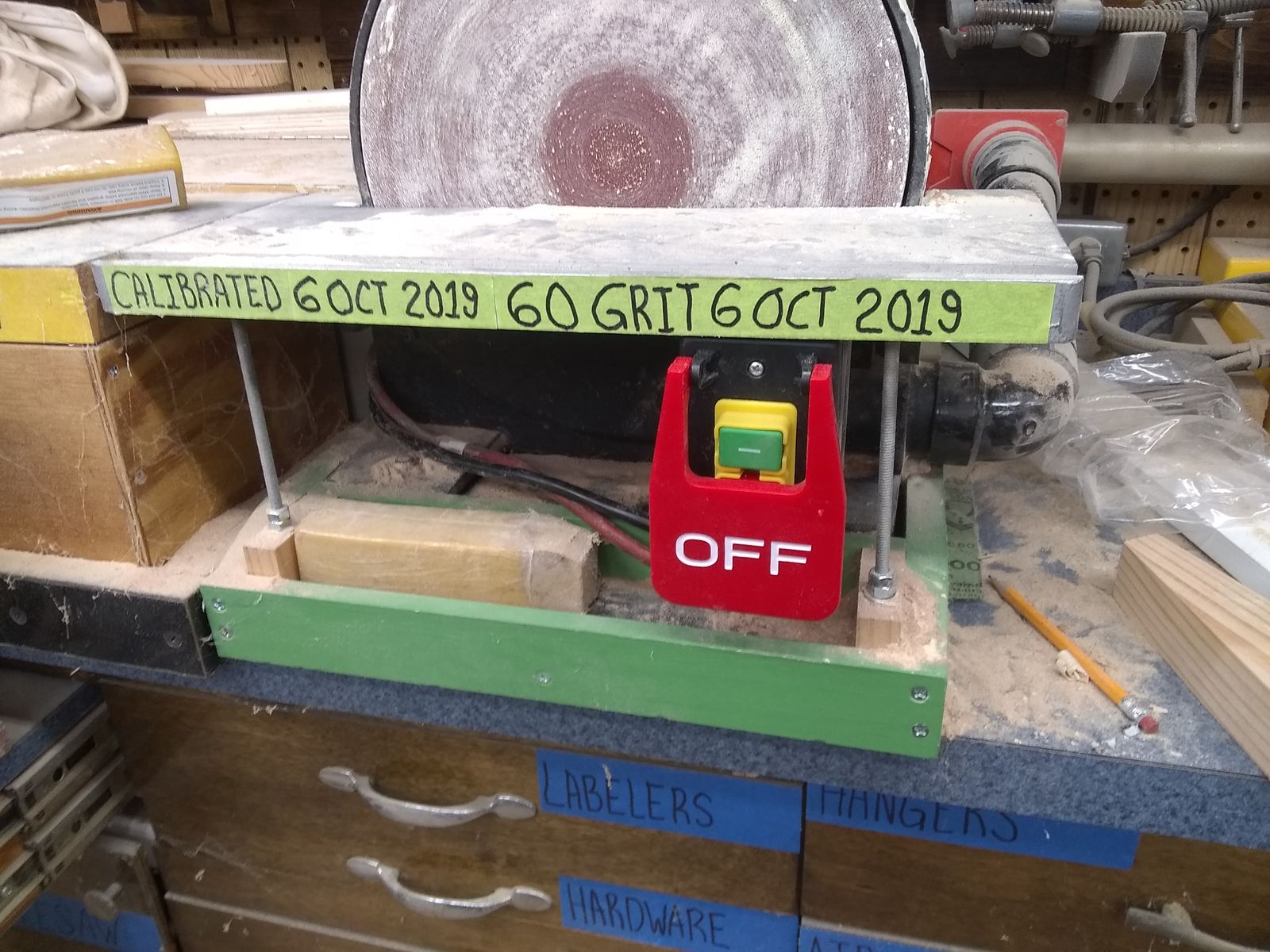

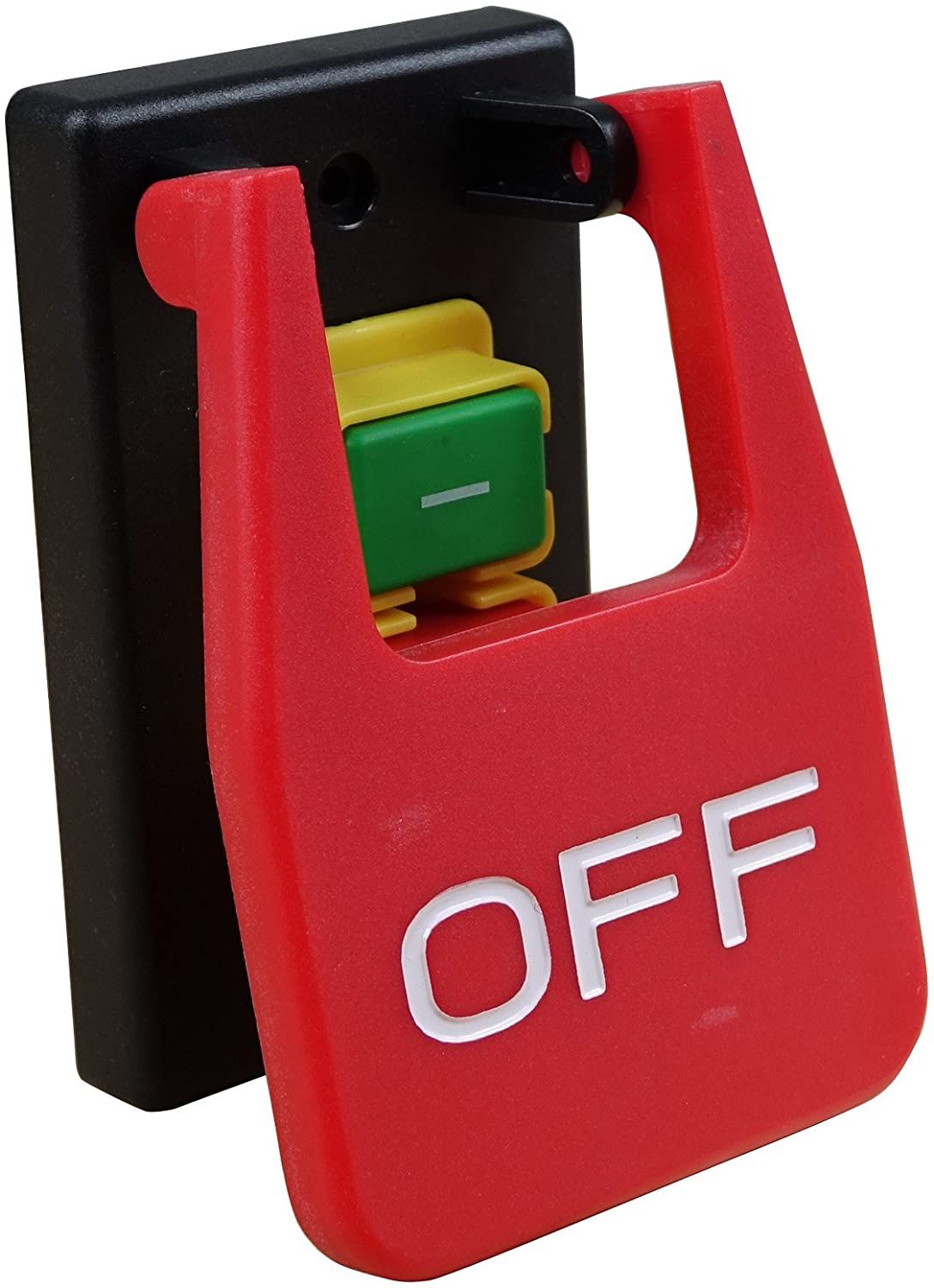

Bought this Grizzly several years ago off CL for $100.  Great sander, but the switch is on the motor which is on the back.  So to turn on and off you reach OVER the spinning disc with 80 grit sandpaper.  Not pleasant or to me even safe.  So I installed a box on a bracket I made to the FRONT of the unit.  Used a magnetic switch because we have power outages sometimes and I don't want the thing to turn back on and cause an accident.  Pucker factor 0000 so to speak.
I like this particular switch because it is very touchy.  Barely a bump on the paddle and power is off.
https://www.amazon.com/gp/product/B01IEM2DSM/ref=ppx_yo_dt_b_asin_title_o02_s00?ie=UTF8&psc=1
