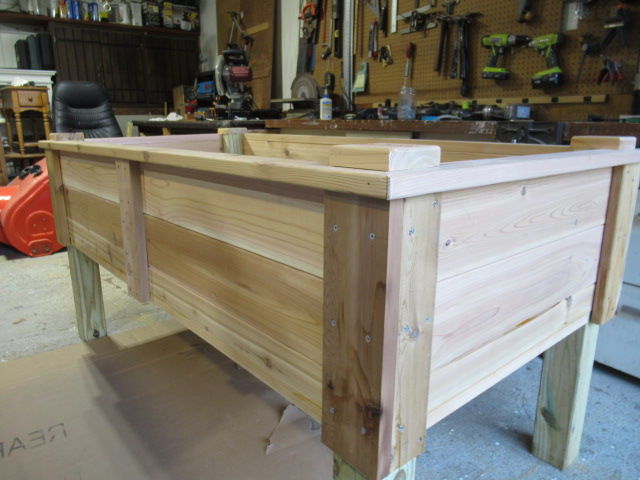

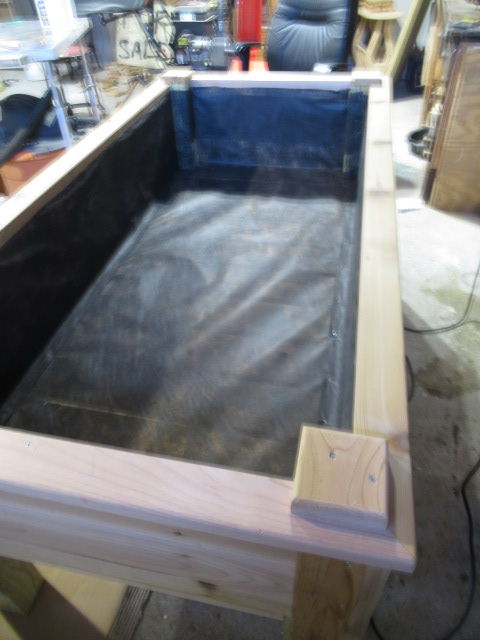

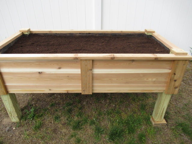

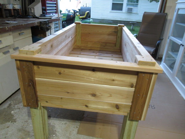

My daughter asked if I could build her a planter box that was bigger than those she found in the stores.  On Monday We went to Lowes and picked up a couple of PT 4X4's and some 5/4 red cedar boards and a bit of ground cover fabric. I thought a box with 30" X 60" inside dimensions should work for what she wants. Took this old pfart 2 days to build it, but here is what I ended up with. Daughter is happy and I survived a minor cut on my thumb while notching the 4 X4's.. Nothing like what John experienced but enough to remind me stay awake when using power tools. After all was said and done, this is what we ended up with.

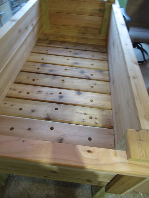

Assembly was done using screws and glue. The bottom boards were spaced 1/2" apart and 3/4" holes were drilled to provide for drainage. The planter is 30" high.
